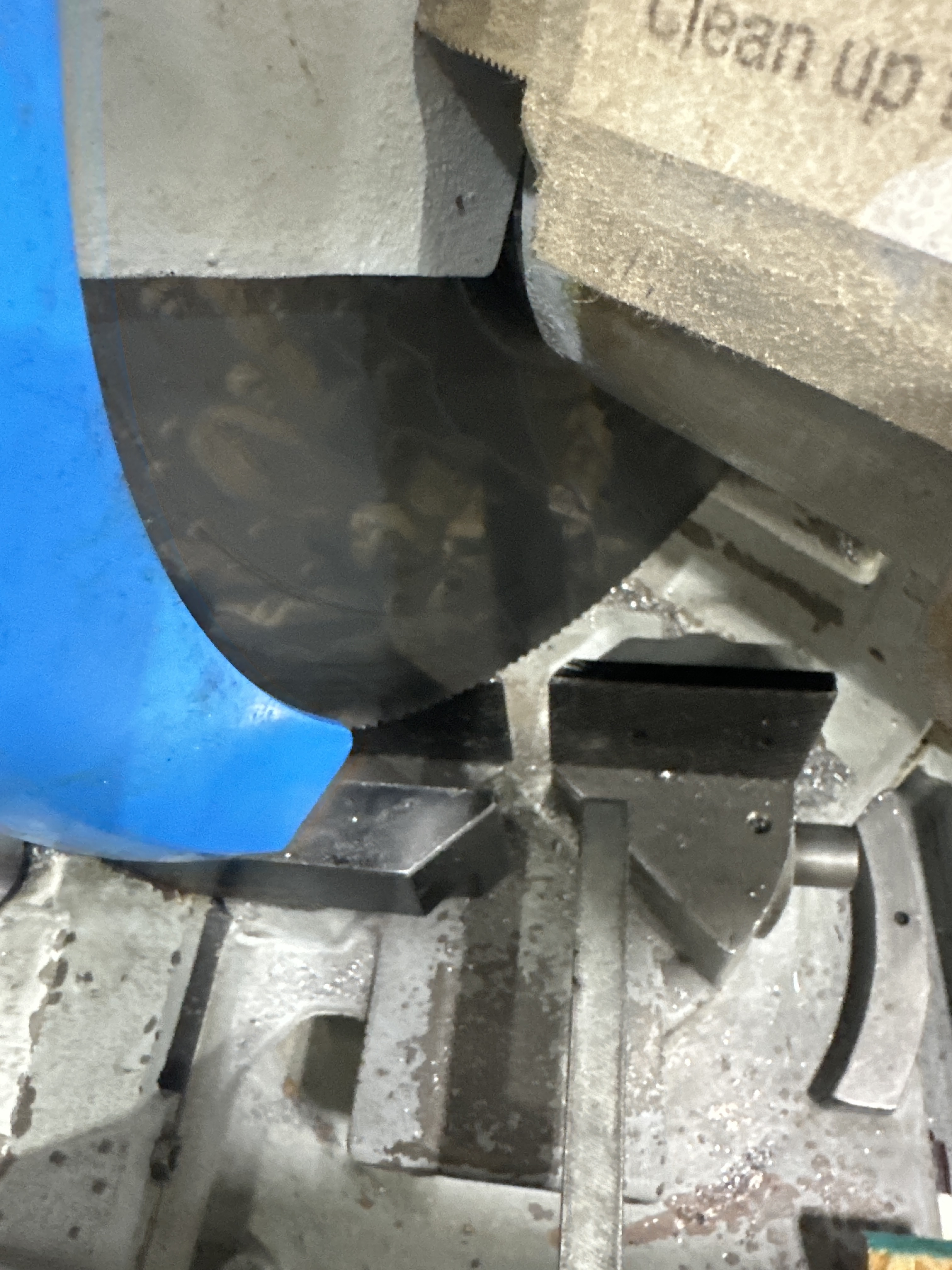

For cuts at angles where the blade would hit the soft jaw, is there an alternative to taking the soft jaw off completely? Does the vise carriage adjust front to back?
Ah, I assumed there was some kind of fastener preventing movement, but no, I was just not pushing hard enough.
That slide tends to take more force than one might suspect, but it does move.
