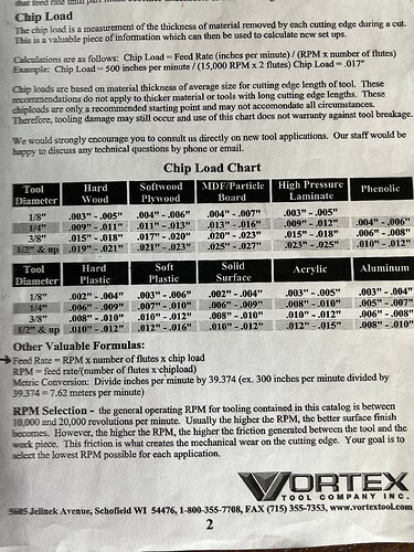

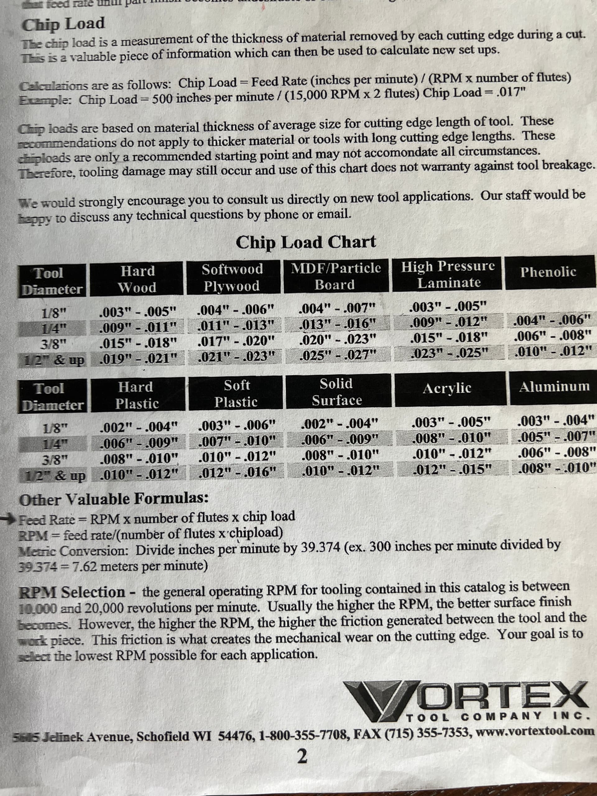

My better bits are Vortex bits. I carry this sheet around as reference.

Toolstoday has a good chart for their Amana bits and it seems to corroborate what you found. for their 1/4" bits they recommend 180ipm for wood/plywood and 215ipm for mdf/laminate

That was the exact table I came across online.

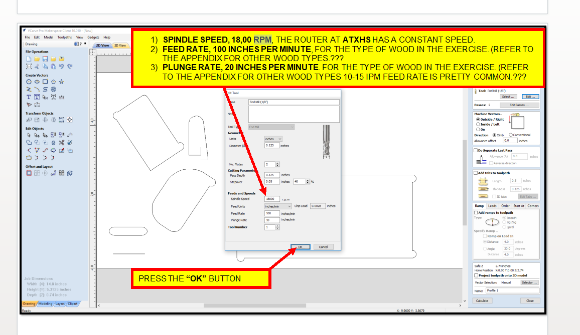

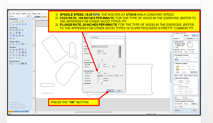

Fair enough, I haven’t done those tests. The reason I mentioned that is due to this slide in the CNC class notes from 5-5-2020, which are linked in the wiki. Perhaps it is outdated or I misunderstood what it was saying. That’s very good to know haha, thanks for the info. Glad I specified I was only 95% sure :slight_smile:

I don’t know why those class notes say that. Odd.
But I will note that the settings that slide recommends give you a chip load of only 0.0028 inches/tooth, a bit below the recommendations of the chart above even for a 1/8” bit in the hardest materials. Interesting.
