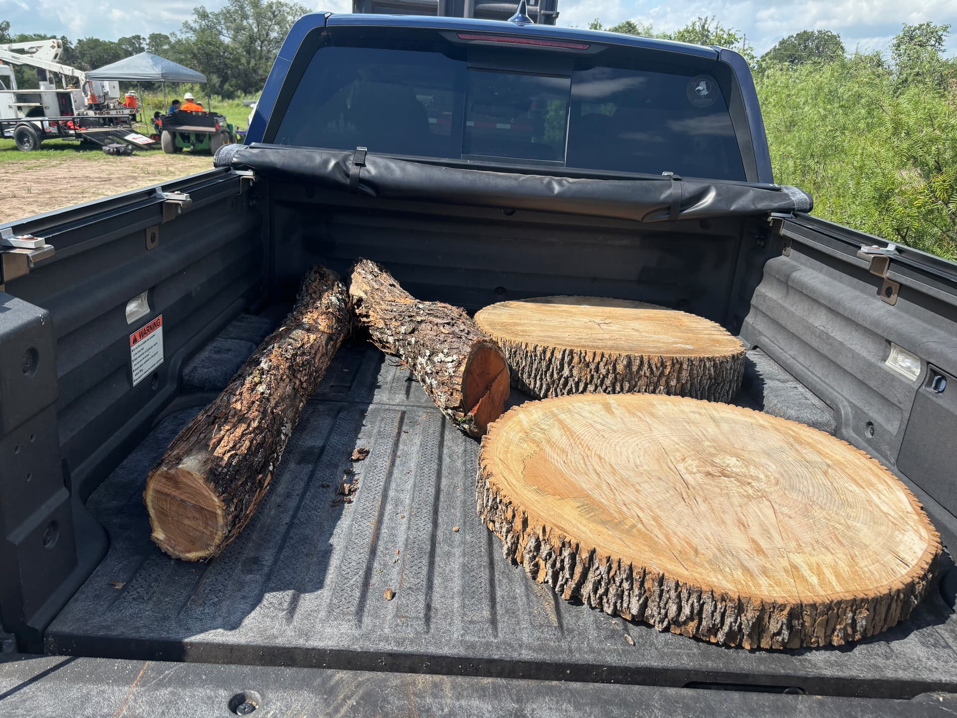

A student recently reminded me of the City of Austin program that provides free logs, cutoffs, and cookies to artists (https://www.austintexas.gov/event/wood-reclamation-large-logs-great-art-projects-and-milling). I stopped by last Friday and scored some beautiful mesquite I plan to turn on the CNC lathe (again - details to come).
But the stars of the haul are two large cookies (Elm? Ash?) that will be my immediate focus. They’re roughly 32” in diameter and end-grain, making them a perfect candidate for demonstrating the CNC’s flattening capabilities.

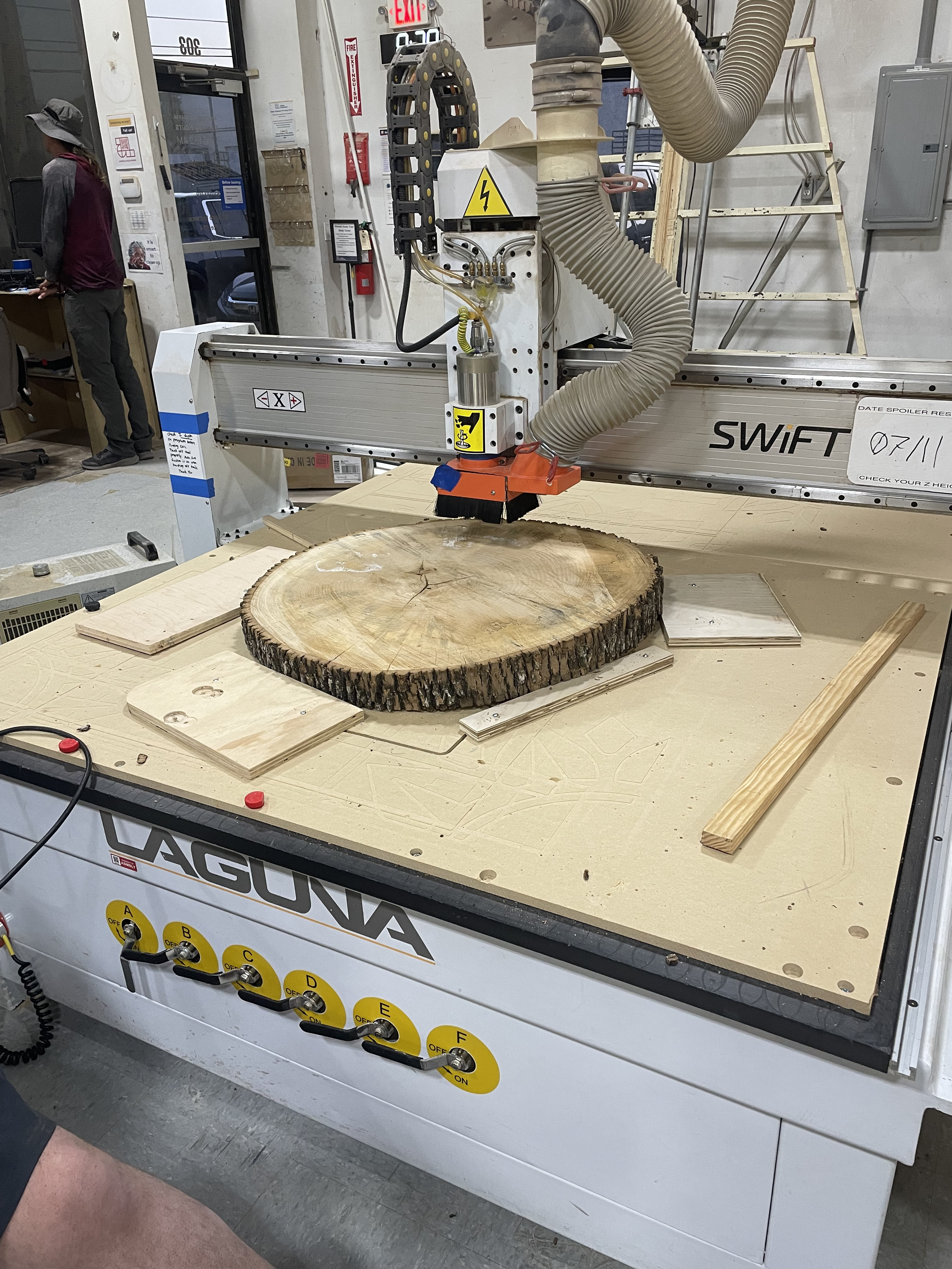

Instead of doing it solo on my home machine, I’ve booked time at the end of my CNC class this Wednesday night at 8pm. I’ll be doing a live demo on how to flatten large, end-grain cookies using the CNC: what to do, what to avoid, and a few lessons learned the hard way.

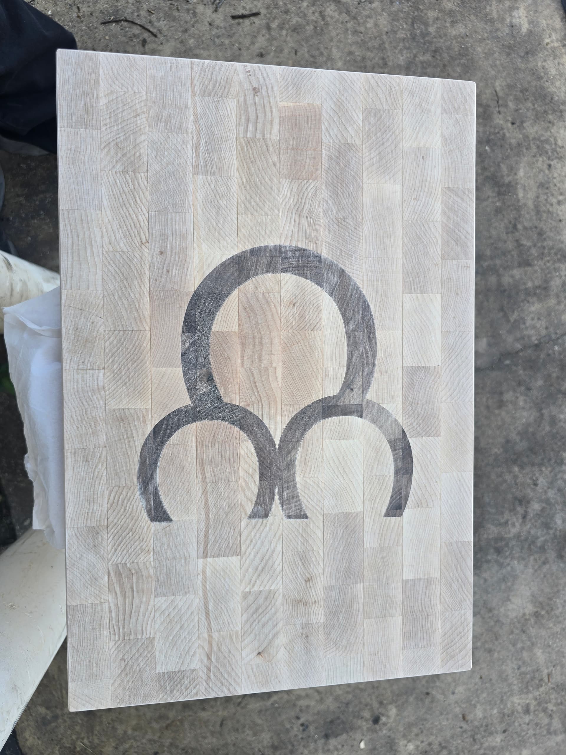

While he was demo’ing flattening I was working on an inlay cutting board. I made the silly mistake of programming the v cut with a 30° bit and actually cutting with a 60° bit. Luckily I hadnt removed the piece before I caught the error, and was able to re cut using the correct setting and bit.
After both pieces were cutout, a dry fit found a little play in the 2 pieces. I decided to sand the female piece, the maple piece, to try amd adjust the fit I wasnt super confident the inlay was going to look great after glue up, but proceeded anyways. I’m happy to report, it came out great!

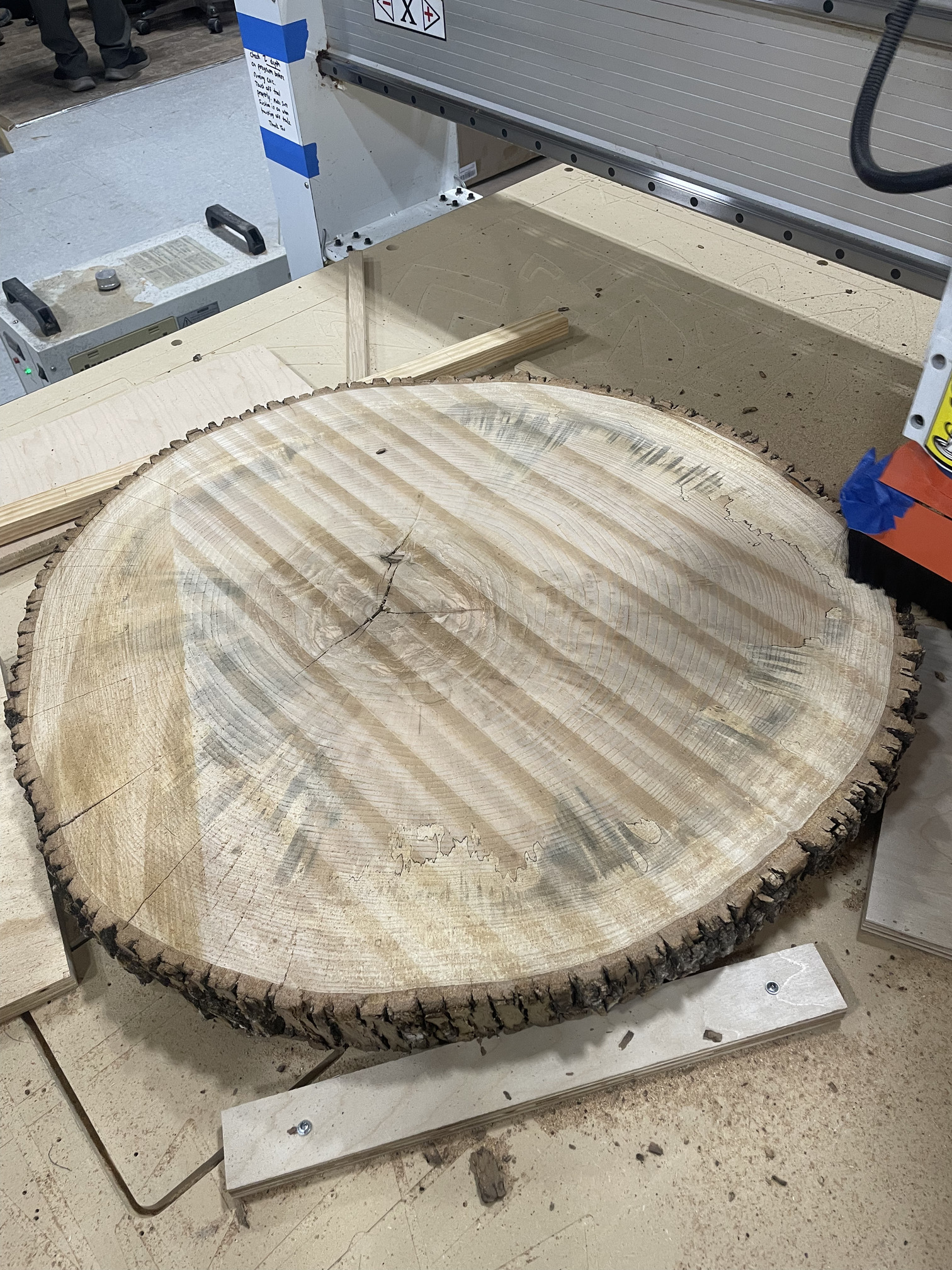

At the start Steve mounted the cookie with supports to level it and others around the edges to stop it from moving.
We watched for quite a while and I finally left at 9:40 PM and the top still had more to do.

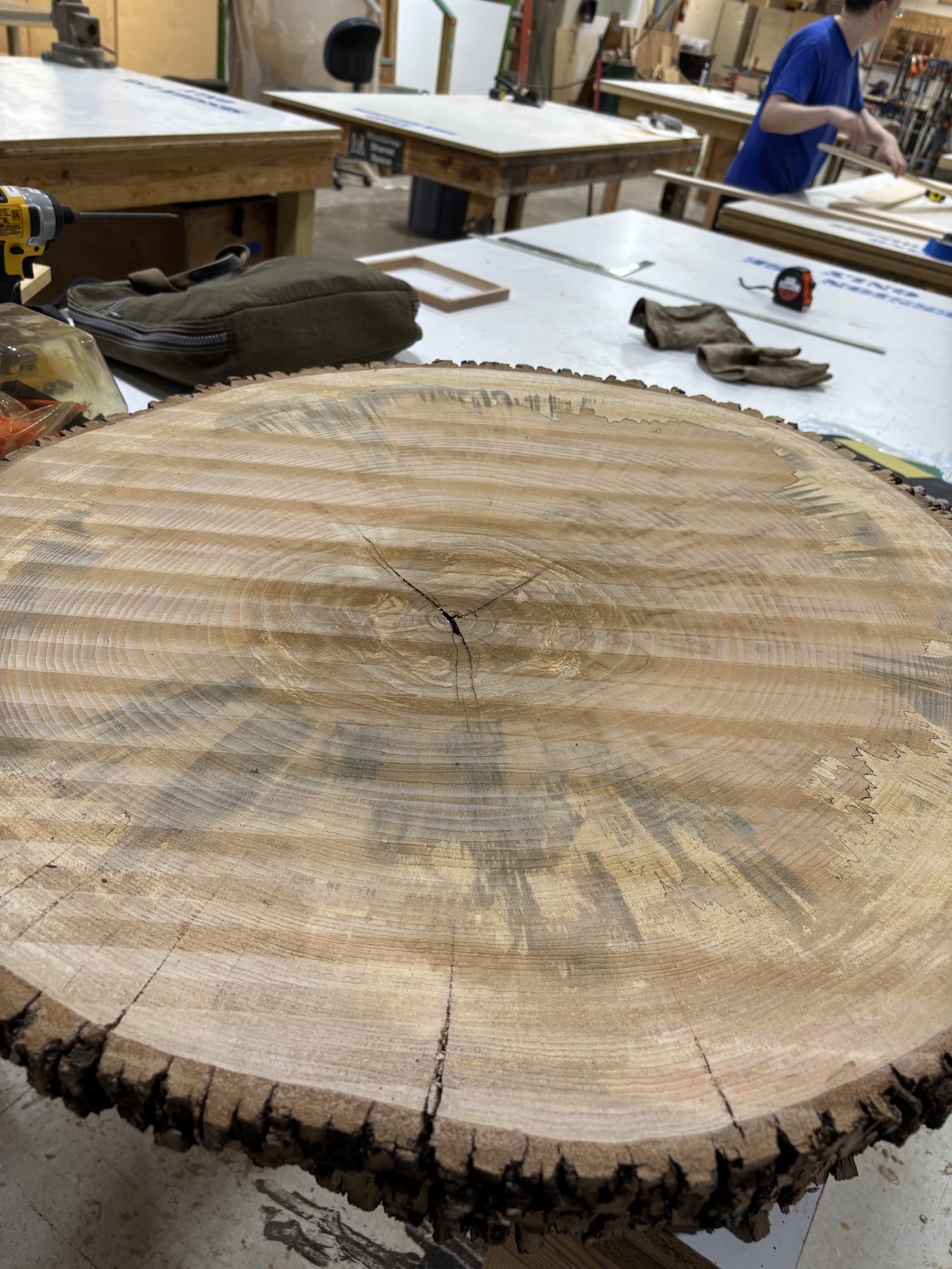

Here is the finished cookie. I still have one more to flatten at some point.

Did you use the full sheet of walnut or just a corner like you intended? The glue lines match perfectly between the two species
Used the full sheet. It didnt even occur to me by doing that, the glues lines would match. Happy accident.
