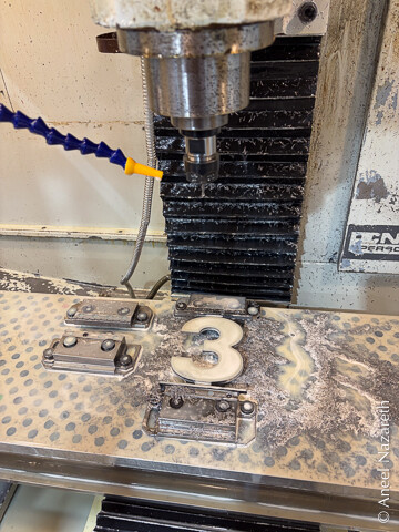

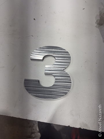

If you want to get fancy, the Tormach can make nice numbers…
Aneel, nice font!
