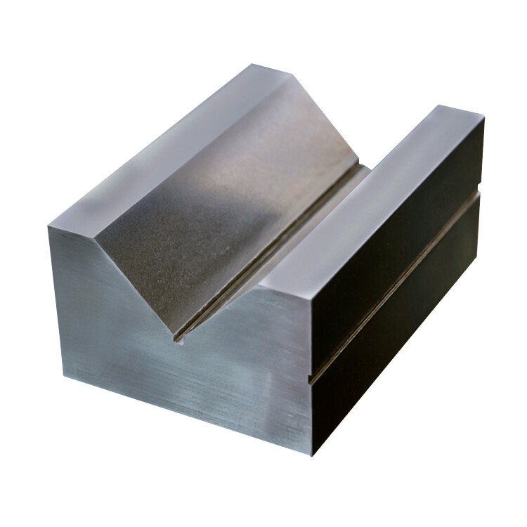

I see, thanks! By V-shaped blocks, do you just mean two pieces of wood attached in a V shape? Do we happen to have any laying around at the woodshop? I know there are plenty of clamps but I feel like I wouldn’t be very good at centering the PVC pipe unless the drill press has a groove in it or something.

something like this is a v-block. Doesn’t need to be metal of course, wood will work but it needs to have a flat bottom for stability. You can probably find a piece on the scrap cart and cut the groove on the table saw.

I’ve had no trouble cutting wooden rods and PVC pipes on the miter saw by hand. Just hold it with firm pressure both down and toward the fence; you’re basically using the intersection of the fence and table as the V-block. I would use an actual V-block for drilling then. If you want your holes precisely through the center, I’d probably make a simple center drilling jig, which would include the V-groove.
