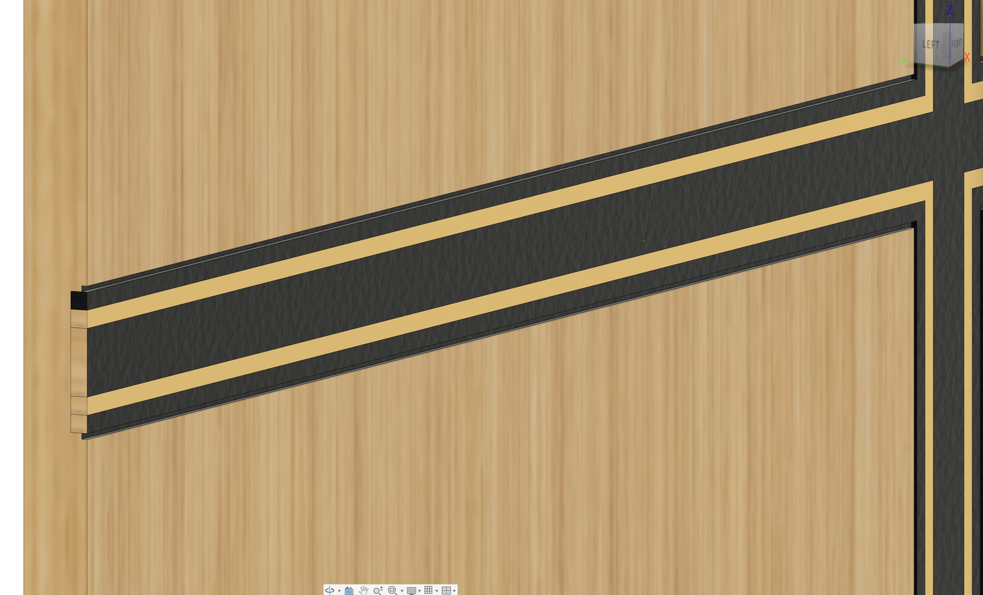

My plan is to simply mill ~3/16x3/16 grooves for the brass and then a small 1/16x1/16 outer kerf to have a clean edge between the black finished material and the natural. Pic may seem confusing, but the only two material are the panel (with grooves) and the inserted brass. The black will be painted with SW Gallery Series. I plan to mask prior to CNC with Oramask 813 Stencil Film, then spray the black, then insert the polished brass, then finally coat the panel natural with Rubio.
Thoughts or Feedback before I dive in??? :rofl:

I do a lot of decorative metal work. If you are doing a mirror polish finish, I would do a pre polish on the ends before mitering them and then cut to final length. Polishing after a Final Cut can change the profile a little. A milling machine would produce the best result but you can also use a belt a sander with a miter gauge set up. The challenge is not sanding off too much. It happens really quick. Another finish that looks nice as inlay is a linear grained finish. 220 grit on a block then maroon scotch bride pad. This is less work and not as hard to pull off. You can use a waxed finish on the brass but it will still darken over time. If you want it bright you’ll have to seal it. That opens a whole new set of challenges.
