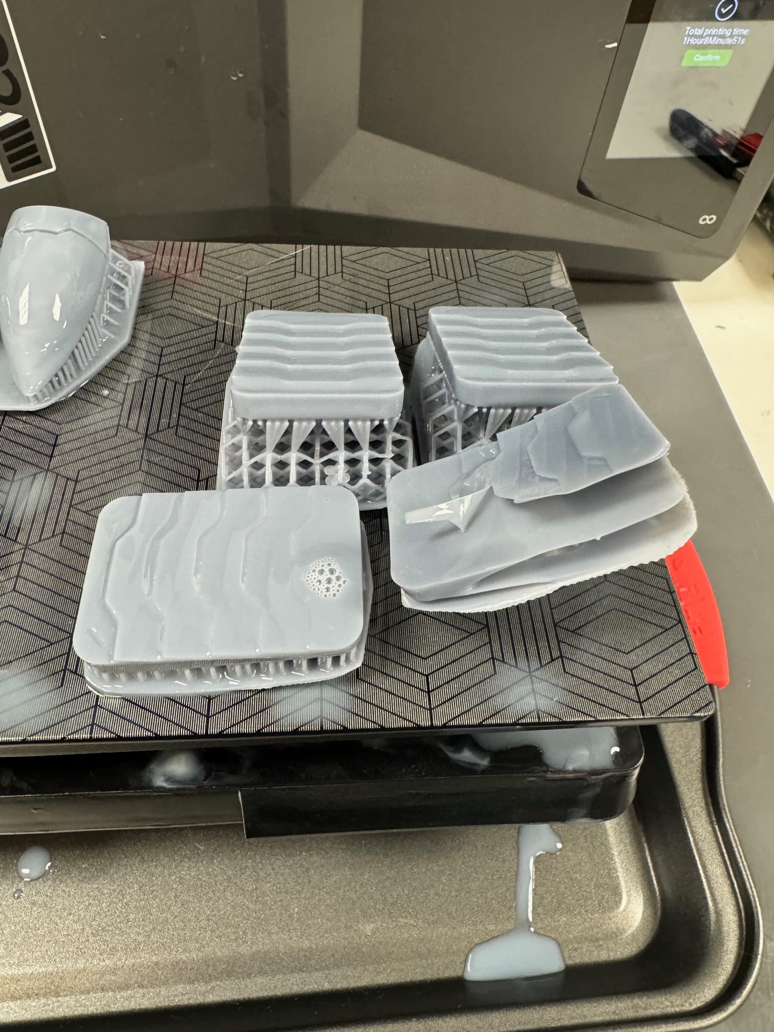

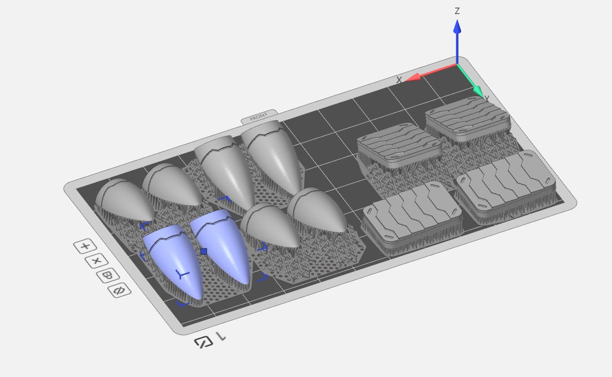

Hi all. I’ve been using Dione (the Saturn 4 Ultra) off and on for a couple of months now. I’ve gotten some good results but I find that almost every print has some casualties because some of the prints are not adhering to the build plate. What has happened repeatedly is that one or multiple parts do not stick correctly and so the part in question either comes out deformed or totally disappears back into the resin vat. In some cases the dislodging of one or multiple parts causes other parts to have defects. Overall, of the four or five batches of prints I’ve done, every single one of these batches yields only about 50-60% of the parts I need.

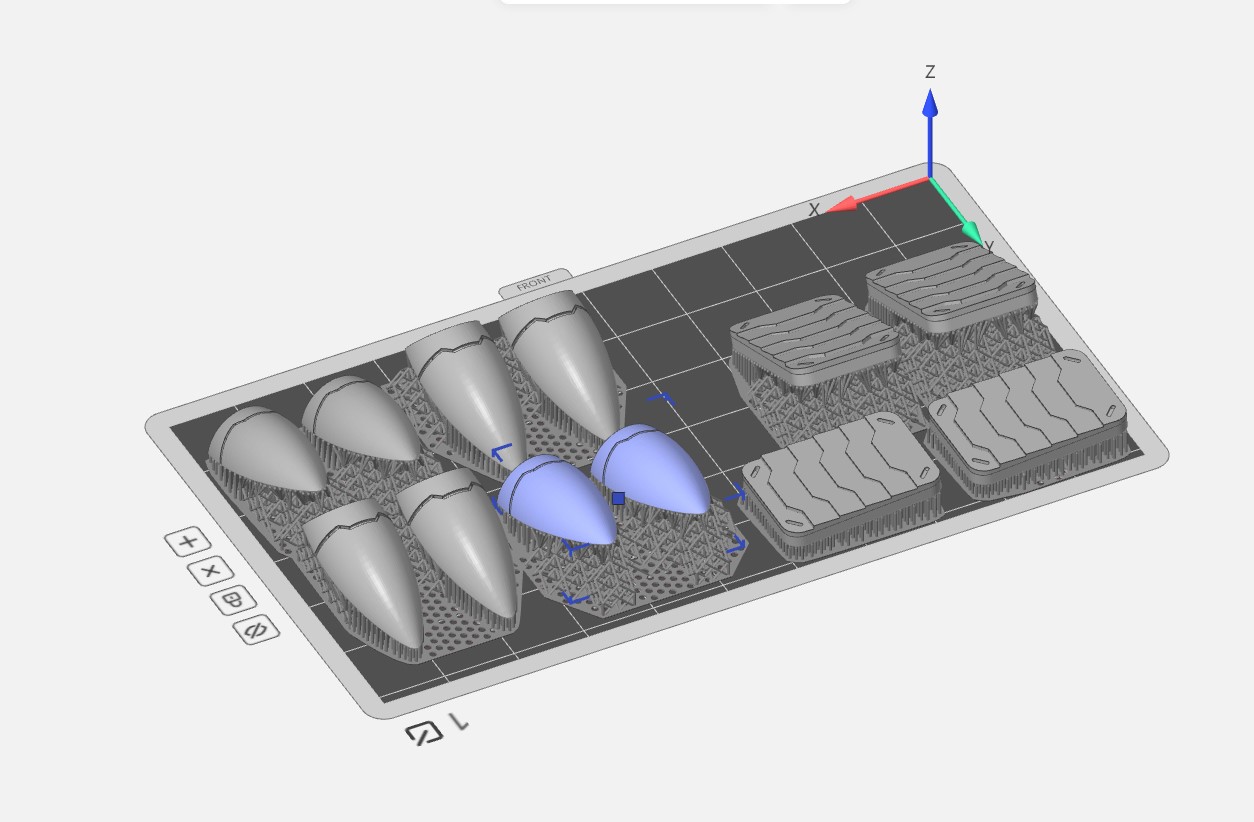

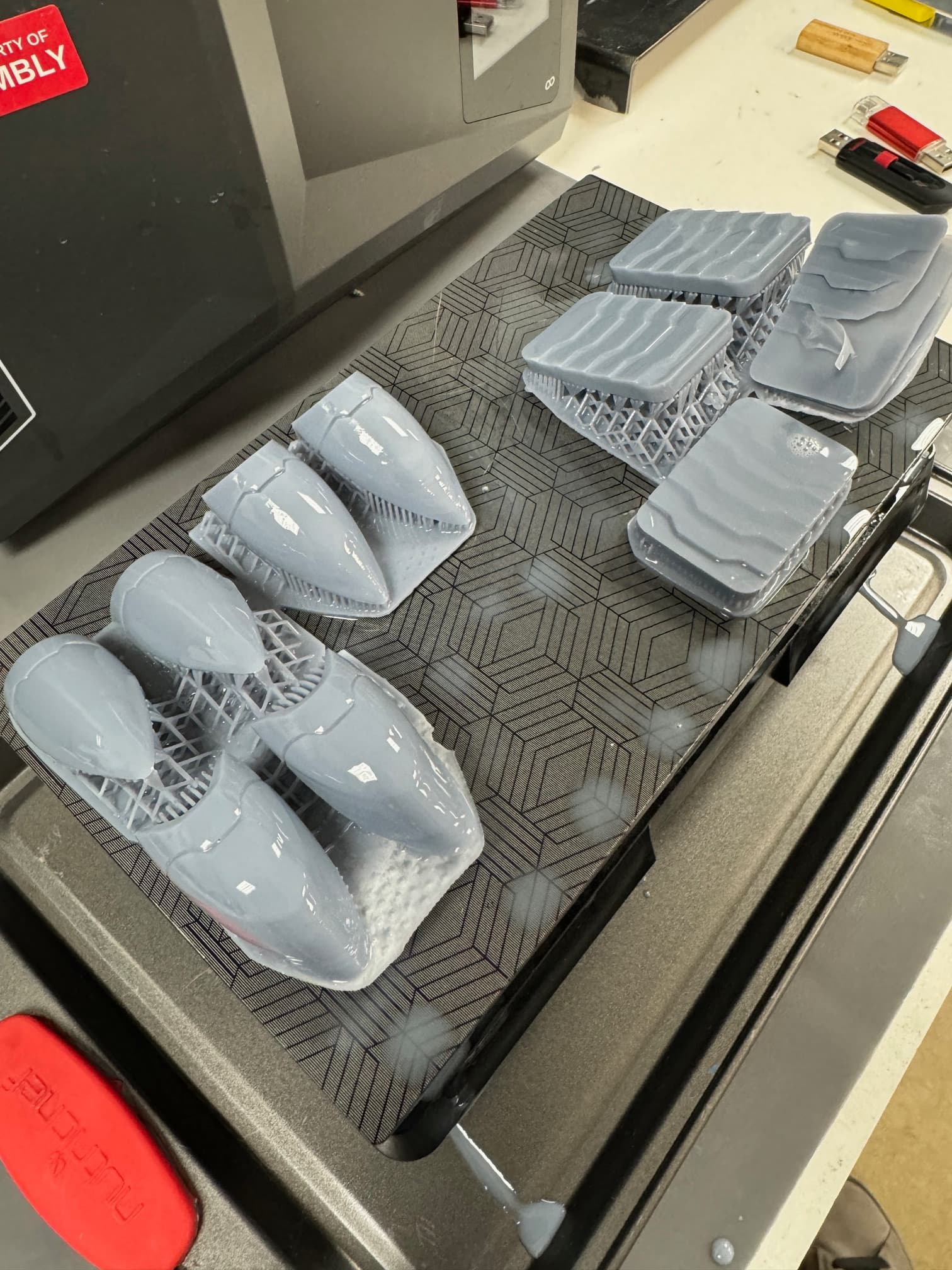

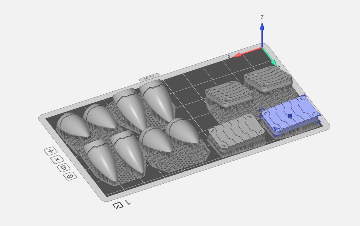

At first I wondered if it was the slicer; I’ve been using Elegoo Satellite because the new version of Chitu seems buggy to me. I’ve checked my settings repeatedly and all seems well there. Most notably, the failures seem arbitrary. The parts that fail are often very similar in geometry and alignment to parts that succeed. I’ve attached images from the slicer and photos of the actual results from yesterday’s batch. Could it be as simple as needing to clean the plate before I initiate a print? I can’t imagine what else could be going on to mess with adhesion like this. I’ve had prints fail before because the supports were inadequate (and so parts dislodge and float into the vat, interfering with other parts), but here entire rafts seem to be coming loose and detaching, which is so odd to me. The others that survive are quite firm on the plate, needing a fair amount of force to be removed. As far as I can see the plate’s not damaged.
These two images show the intended prints as sliced and the actual results. The parts highlighted in the slicer screencap are totally gone, presumably they failed early on?

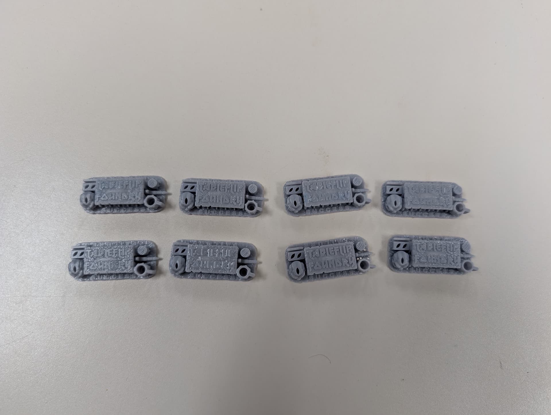

In these images, one can see that the highlighted parts did print, but having partially detached early on, they came out quite deformed. But the parts upward and to the right of them, almost identical and similarly oriented, came out fine. ???

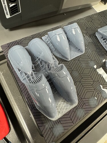

Similarly puzzling: highlighted part again partially detached and came out deformed, although literally identical in every way to the part to its left
(Admittedly in this case the part is slightly detached - it was thinking about failing but held on in the end and printed fine)
