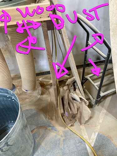

Here’s a picture from a few hours ago, showing how I found big CNC’s dust-separator-plus-storage can thing:

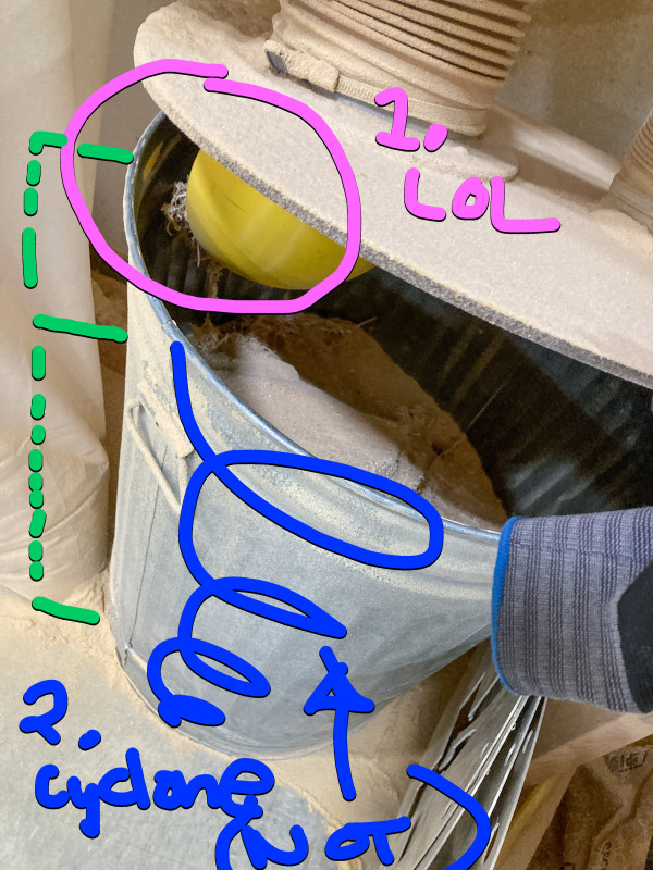

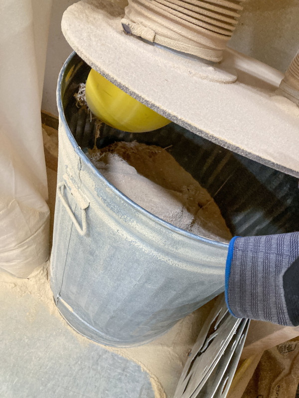

As you can probably tell, it’s mostly full of dust (duh). What’s the problem with it being mostly full of dust? Well, it makes the can heavier for the schmuck who empties it. It also messes up the cyclone. What, cyclone? Behold: an annotated version!
  1. The dust is backed up into the bend. This is bad, and also not good.
  2. The cyclone spins here (marked in blue) and allows the heavier dust particles to fall into the bin before it can clog the filter. Sadly, the cyclone will not allow the dust to settle today, because there is no room.

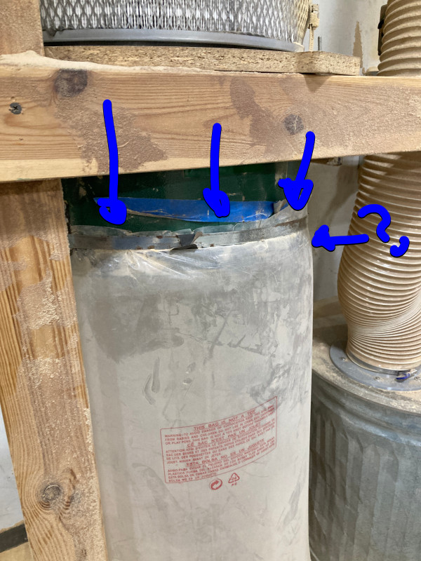

Figure 4: Hook and bag

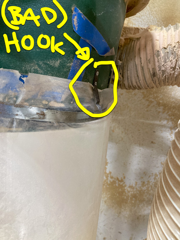

The spring clamping band requires two hands. Meanwhile the bent metal hooks are the only things holding the bag up, except they aren’t… because they’re bent. So it makes the task impossible/challenging. Also, you can’t access or see the back of the bag (where the bent hooks are) without moving the thing away from the wall, which is also covered in dust.
Figure 5: “After” picture
This is after I emptied the bag. I’m pretty sure I got an airtight seal but it doesn’t sit evenly.
Summary
I used the big CNC twice. I have never seen it empty and without leaks. The spring hooks and clamp are not suitable for this type of frequent use. If you do it incorrectly, it makes a big mess. It’s a bad design.

What happened to the original high-efficiency cycle head? That sort of separator is poor at handling the fine dust of the cnc

I’m very interested in modifying this to something that can hold a bin, or dump into another trash can / barrel, rather than the bag. Or if there’s a modification such that the bag is significantly easier to change and maintain, I’m up for that too.
it did have a more easily used trash can interface on it, a long time back
I’m bringing a big toy from the house… Tomorrow I’ve got some time blocked off to change over this dust collector to an Oneida Supercell. No bags, easy filter cleaning, easy dust bin removal.
