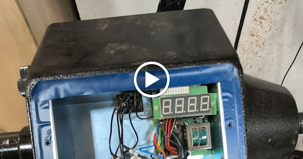

Troubleshooting steps:
Using the continuity check guide provided by Laguna Support, I unplugged the machine, opened the control panel, then plugged the machine in to check for continuity in all of the buttons and switches.
I found the continuity in the start/stop mechanism was working as intended when the switch was detatched from the wiring. However noticed the switch was not triggering the completed circuit.
I also noticed the E-Stop was not active. When trying to disconnect it I noticed it was operating like a pull/push.
Videos attached show steps (for learning purposes only. Please do not perform your own maintenance on the machines unless you are authorized to do so).
*Bonus, you can also see how to work with a multimeter that has a bad fuse here
