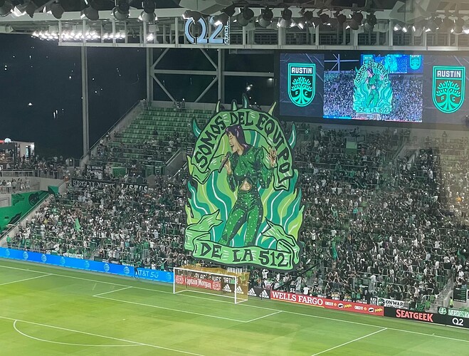

I’m in Los Verdes, a supporters group for Austin FC, the local MLS team. Several times a year, we create large art pieces called tifos and raise them during games. Here are some of my favorites from previous years to give you context of the size.
These start out as 5’ bolts of fabric, cut down and sewn together into roughly 50’ by 50’ sections. Once we get them all sewn together, we create a grid on the fabric so we can transfer the image accurately.
We did this today, and it didn’t go great. So I’m curious how y’all would approach creating a 50’ by 50’ grid on fabric.
