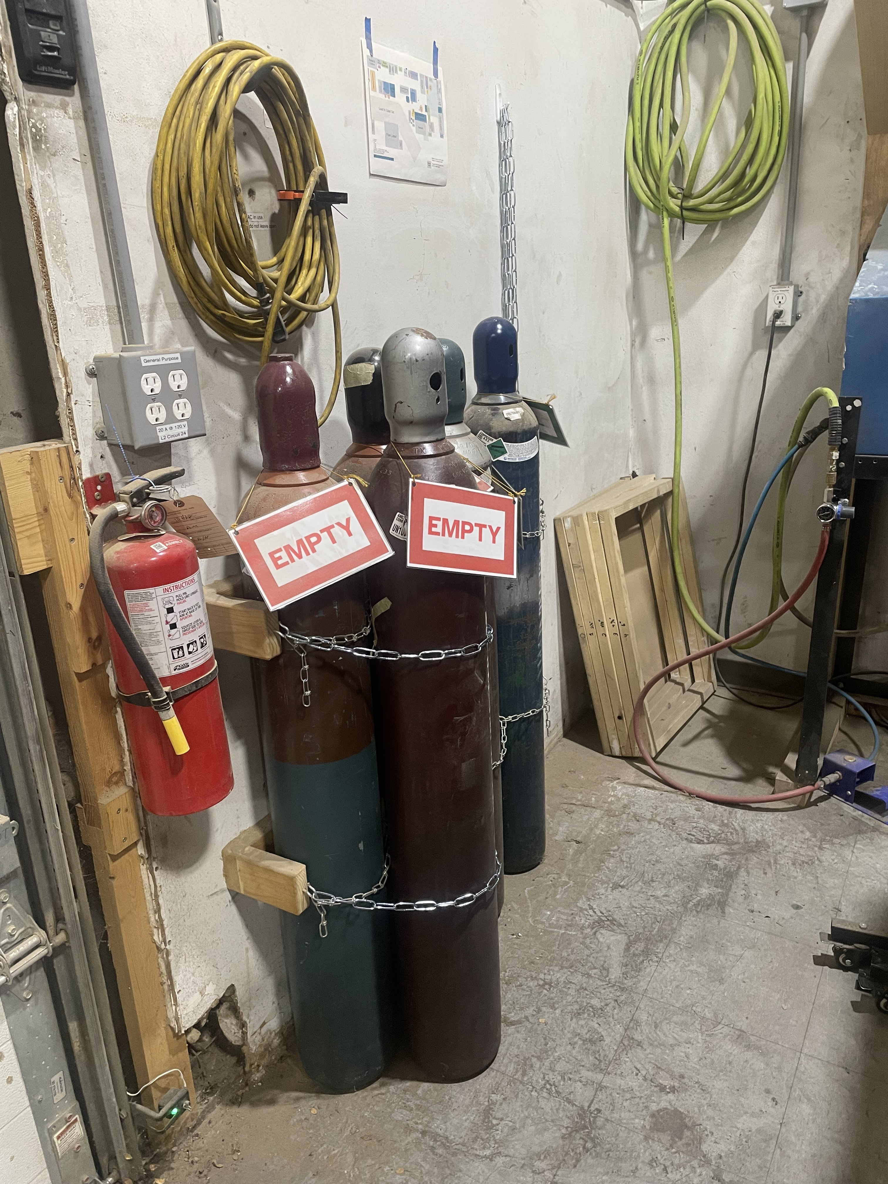

Gas bottles must always be secured with straps or chains when stored. They can be kept on the welding carts, in the rack on the wall by the garage door, or in the gas cylinder cart. I’ve gotten two additional sets of chains so that cylinders can be strapped in front of the rack when it is full, as shown below. Never leave a gas bottle standing unsecured, not even for a moment. Keep hands on it from the moment it is unchained until it is rechained in its new place.
Gas bottle stored in front of the rack with new chains:
Note the additional chains hanging on the wall above and to the right of the rack.

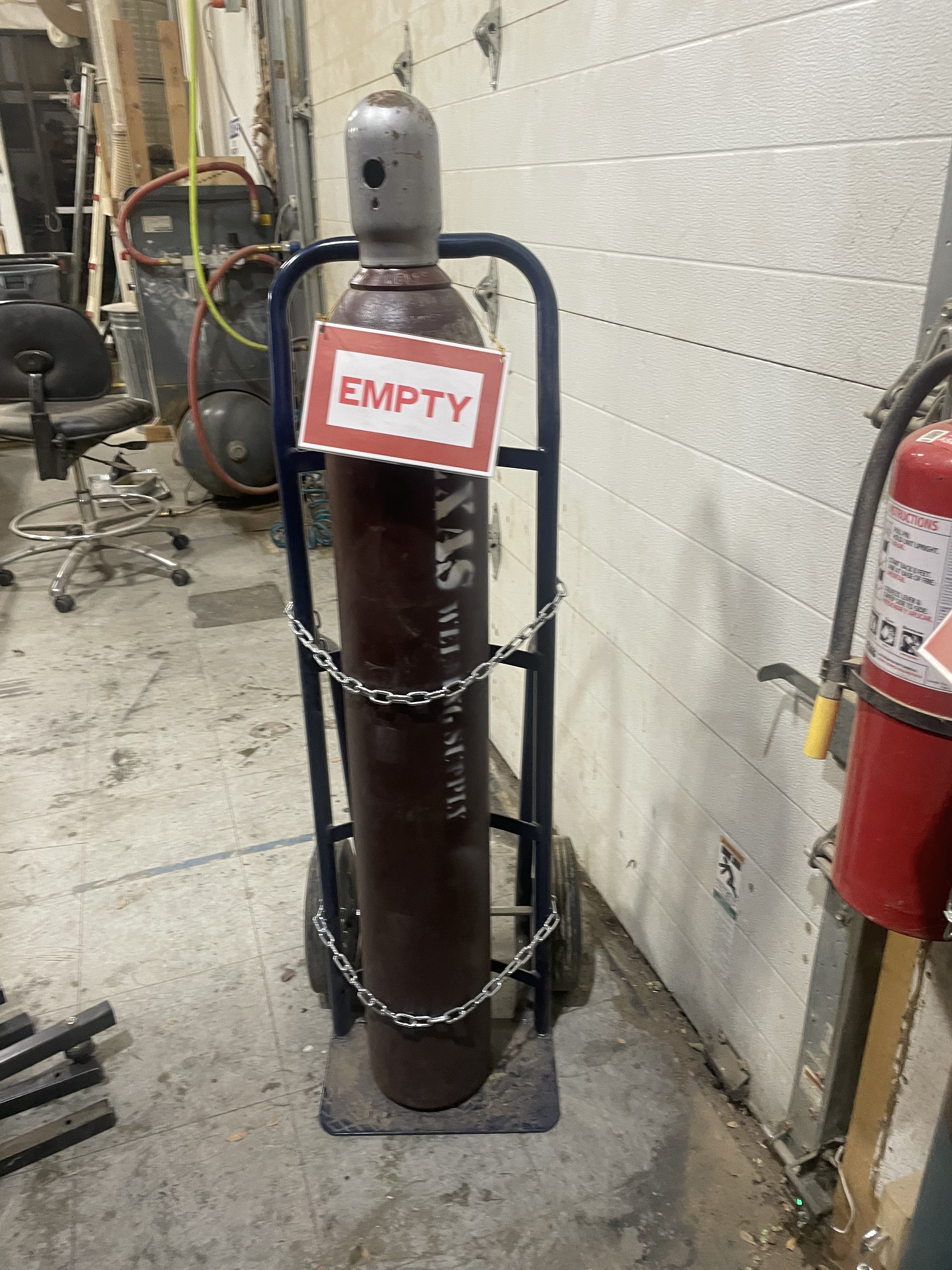

Gas bottle on the new gas bottle cart:
