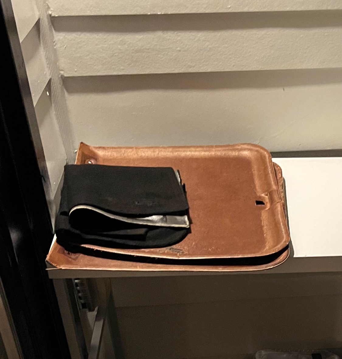

I’m interested in learning more about both. I have a very small job queued right now — the sports car I’m working on has two fiberglass panels that attach to the t-tops to block sunlight (like a manually-mounted sunroof shade). Both are lightly cracked and frayed, and I’d like to push some new epoxy through them using a vac bag system, and possibly clad them with a layer of CF.
