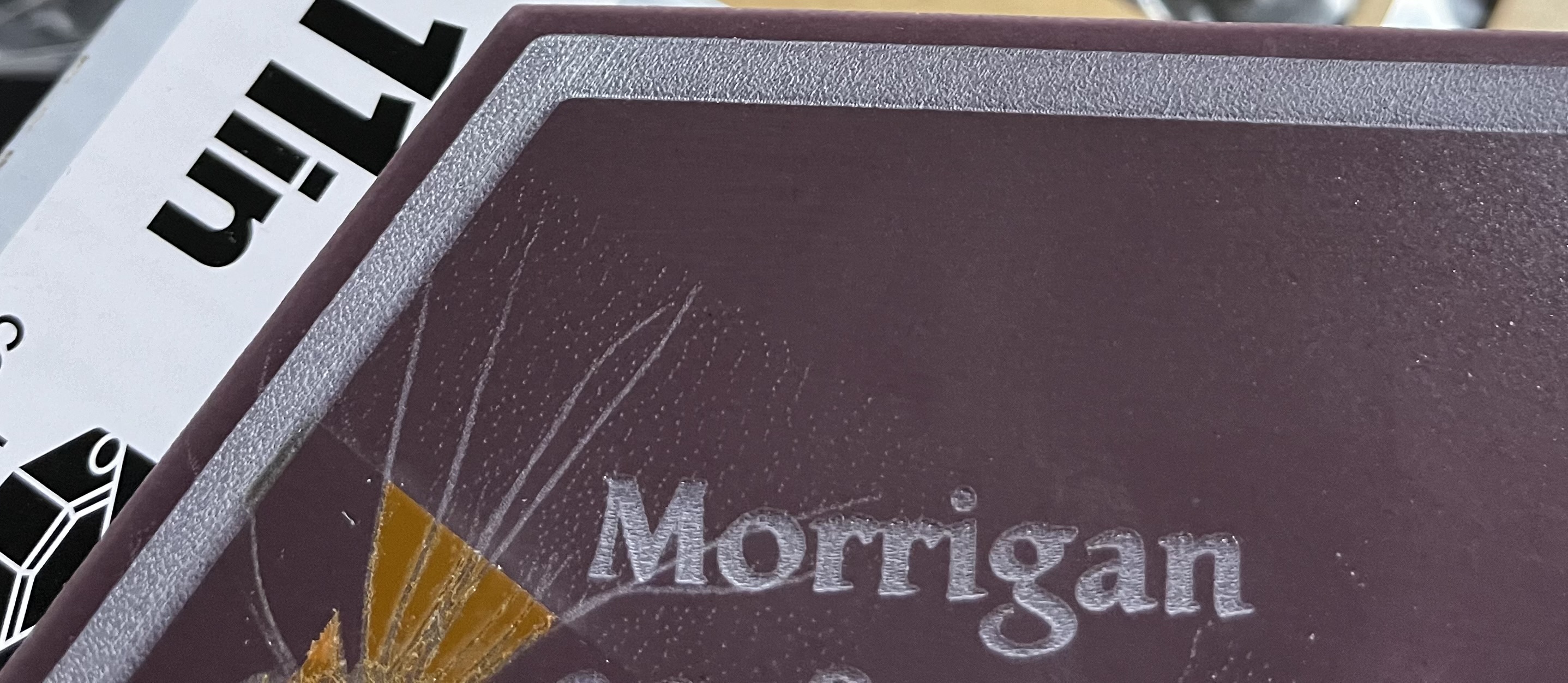

One of my latest projects is laser-etching away the top surface of some ceramic tiles – these tiles have both a color glaze and a clear coat, and I’m removing both with the laser to reveal the white core material underneath. I’m pretty happy with the result, but a bit concerned about protecting it, especially since these particular tiles are intended to live outdoors.
So, in short: anyone know a material and/or technique that might work to apply a new protective clear coat on top of the engraved tiles? I know nothing about actual ceramic glazing and don’t have access to a proper kiln, but I’m wondering if there might be some option that will both stick to the existing surface and cure either at low temperature or maybe in a normal oven?

Here’s a picture of one of my test runs…
I’m not doing especially deep cuts, but definitely removing the top glaze layers.

Ceramic glaze would be able to re-glaze the surface of tile. However, by definition glaze needs to be fired in a kiln. It’s silicate particles that need to fuse together.
It’s actually possible to do this on a small scale in a microwave oven with a special carbon-lined ceramic kiln.
@okyeron has a neighbor with a kiln. You could check about renting kiln time.
I have been laser rastering clay tiles. The surface of the raster after many passes is sort of charred. I filled the raster with a bake on enamel. After some durability testing. I have scraped the char away to expose new surface for the bake on enamel to adhere to. My latest iteration is adding oromask so I can abrasive blast the charred raster after. Just my 2 cents.
