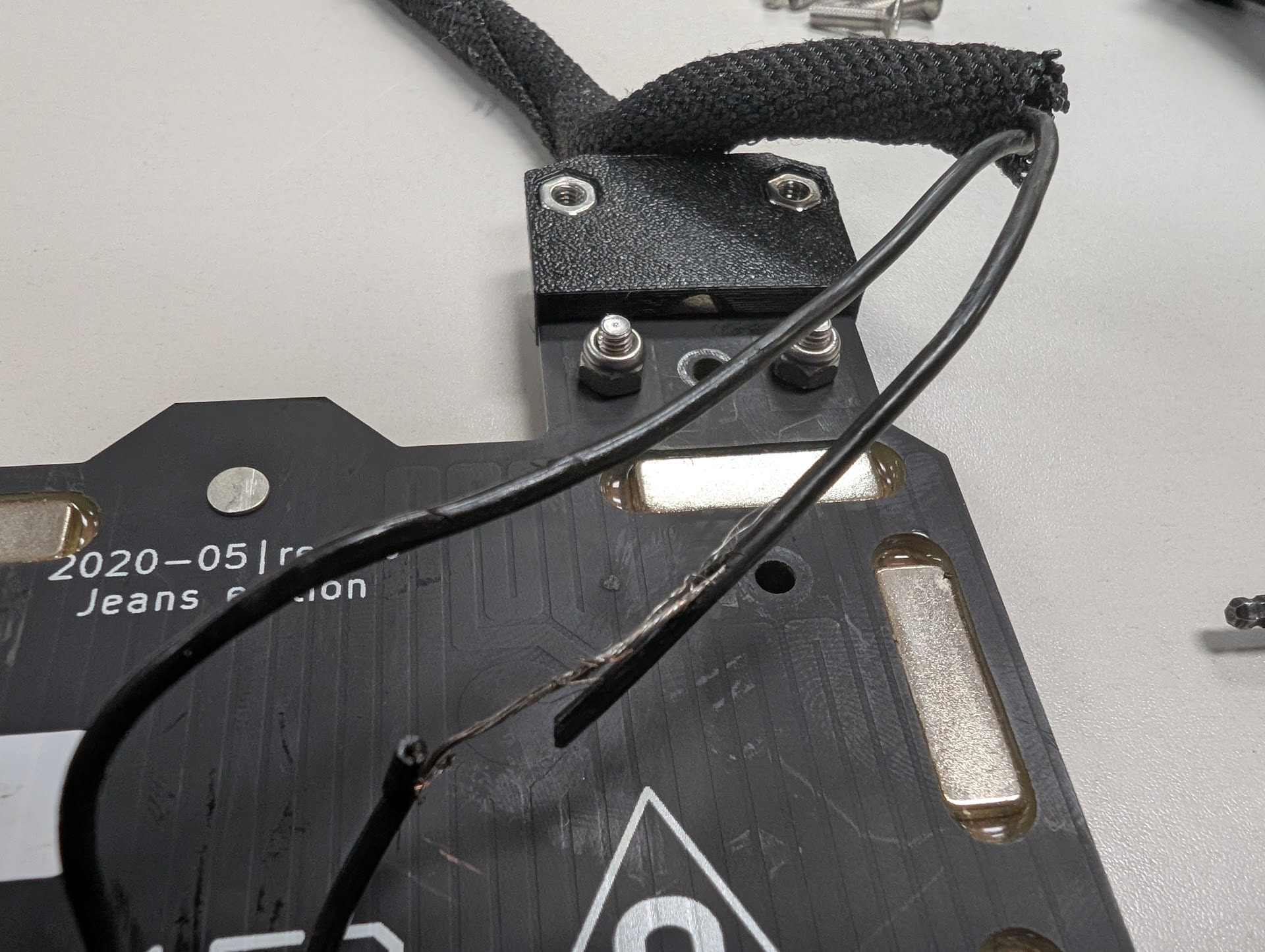

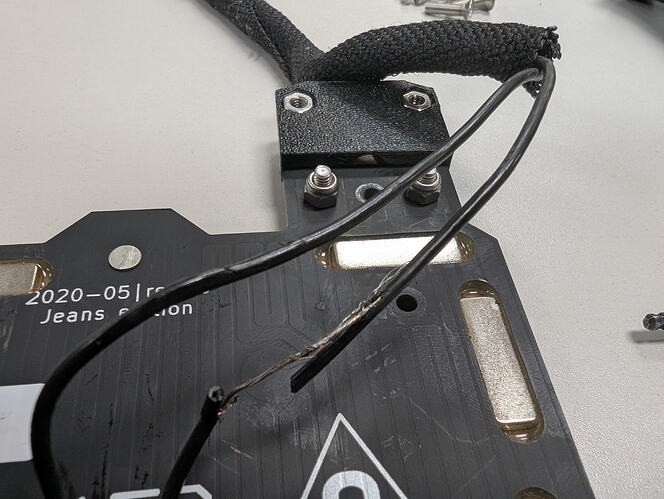

Good news! This failure was due to an incorrect service or install, and won’t happen again. The other two printers don’t have this issue. Here’s the problem, AND the root cause in one pic:
The heatbed thermistor wire at some point got trapped between the bed carriage and the printer’s frame - probably leaving an artifact on someone’s print in the process. When trapped between metal parts, it wears away the insulation, and eventually grounds out the thermistor with nearly zero resistance read!
The cause? Bad wire routing! There is a small channel to safely route this wire with the main heatbed wires in the protected sleeve. The fit is tight, and the install is fiddly. At some point, we remounted this bed with the wires run incorrectly, eventually leading to this failure.

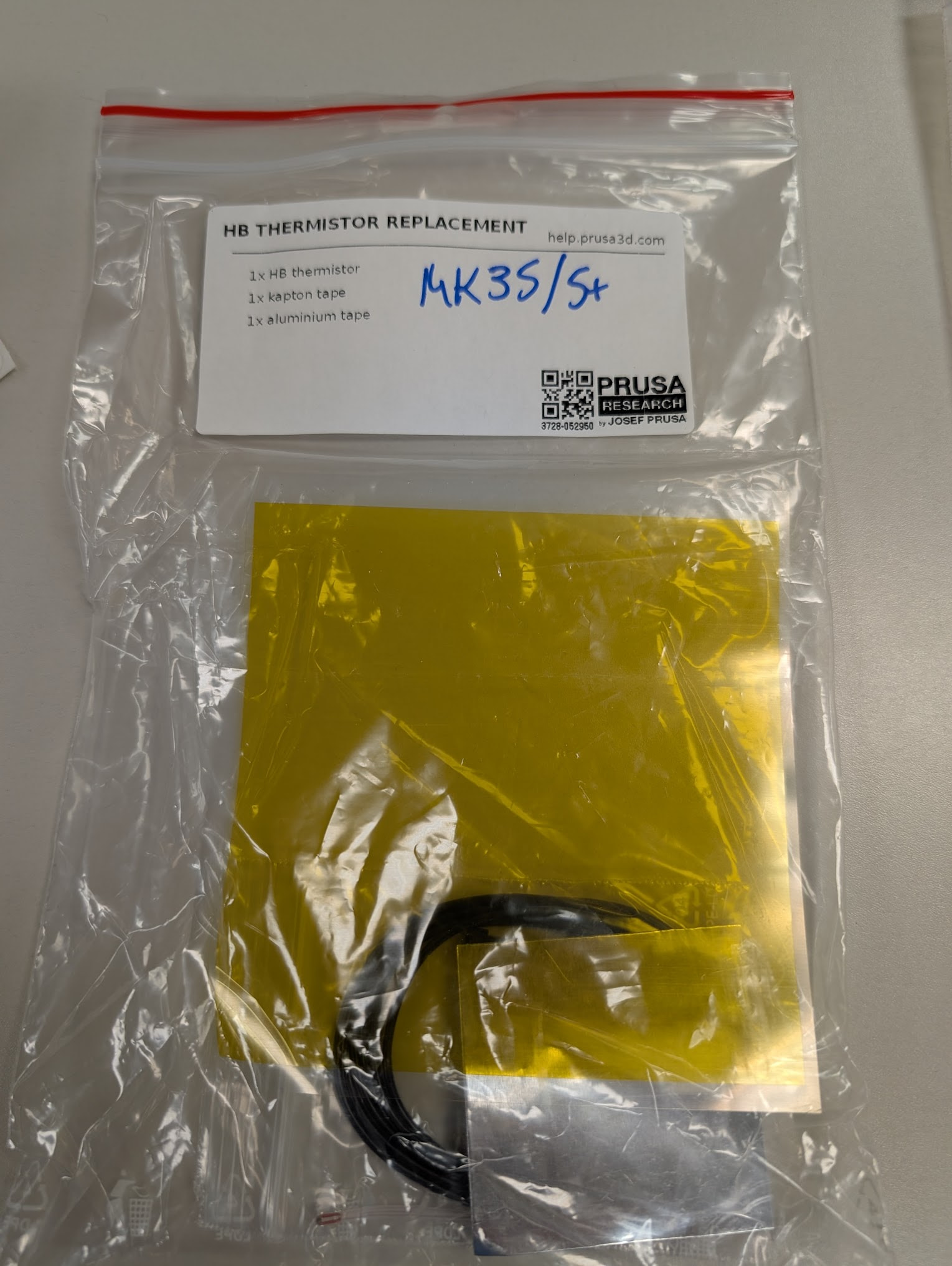

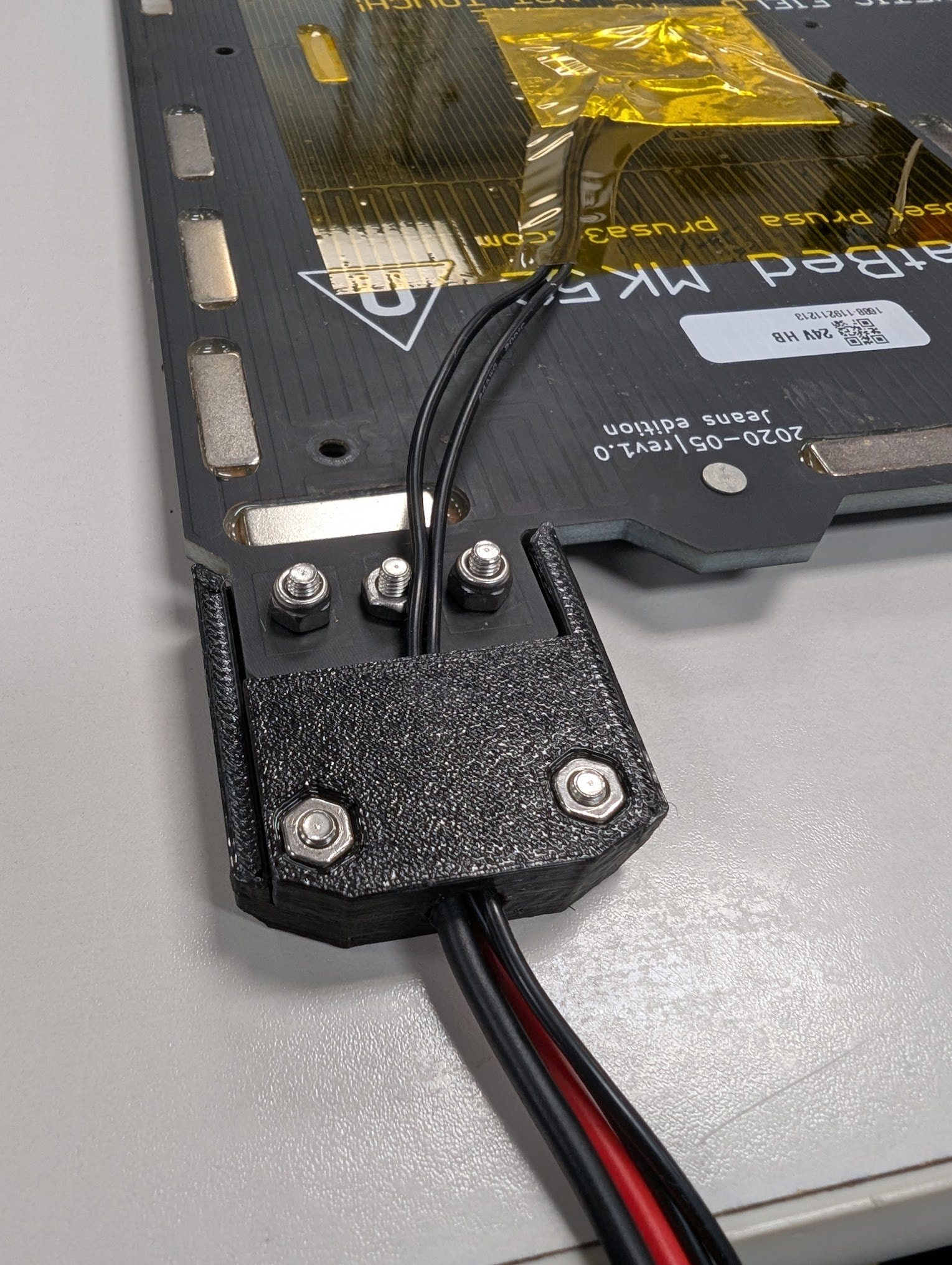

We had the parts in stock, so I proceeded with the repair, this time with safe routing:
(This is actually missing one piece - the protective sheath gets anchored by tension in the printed bed connector piece. But that hides the issue from the camera. :wink: )
