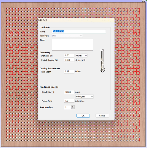

Hi folks, I have a project that requires a whole lot of holes. A kinetic toy/art project. My tool path has options for the right tool which is of course might be an 1/8" mill at 13 hours or something larger like 3/16" mill. But I’ve been reading the interwebs that says a flat bottom (square) mill can overheat or break. Other sources suggest a 1/4" drill and peck my way through 1/2" birch plywood. 4.5 hours.
Does anybody have any experience on a way to proceed on this, tools, speeds and feeds. Perhaps a 3/16" drill and chase that with a 1/8" mill? The challenge is to create space for the waste sawdust and get a good hole without blowout on the bottom.

Hey that’s impressive!. I just checked my setup and it’s a 1/4" drill.

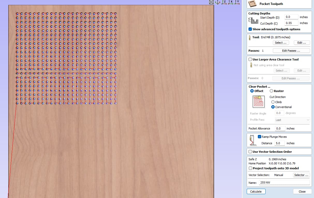

I think to get the helical cut mentioned, you would use a 1/4” end mill, set the holes to the actual size you want, 0.255”, and make the tool-path a pocket cut with a single pass and a ramp with a length longer than the travel path of the bit.

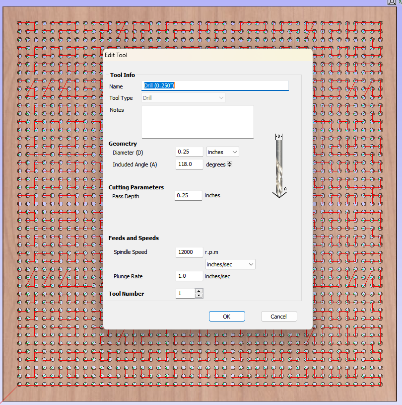

Aspire choked on the calculations on 2045 holes so I broke the project into quadrants. So 500 or so holes 0.255 diameter per quadrant.

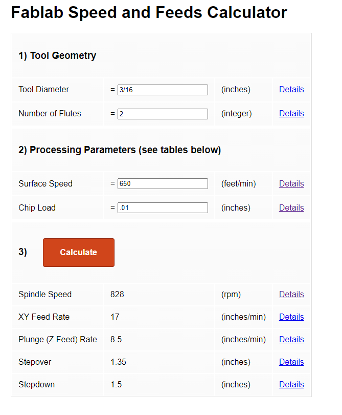

The MIT.edu/feed_speeds calculator online looks like this:

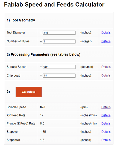

Entering data into the Tool Geometry and Processing parameters for OSB
and the calculations show up in item #3.

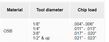

What surprised me was the Spndle Speed of 828 RPM. (See MIT results above). The chip load I sort of guessed at a middle of the road from the rage offered. I recognize that chips carry away heat (at least in metal machining) and too light a cut will just rub instead of cut the stock causing heat and tool wear.
What I am struggleing with is the definition of the tool parameters in Aspire (Vectric). The helical tool path as I understand it is created “ramping” the tool path the entire distance. I can’t say I understand how the length of the ramp is calculated.
I stuck in 5 inches grabbing that number rolling a die :crazy_face: but I doubt that is the correct method to achieve the helical tool path suggested earlier.

Part of the reason that looks wonky is because it’s not calculated correctly. That MIT calculator apparently breaks with fractional units (with 3/16, it’s calculating for a 3" endmill). Put in 0.1875 for the tool diameter and you’ll get a much more reasonable output.
650 ft/min surface speed also seems a little low to me for plywood, but could work out fine. You can always set your parameters a little high, bump down the feed rate on the controller, and bump it back up if it’s running smoothly. As a general rule, if you’re hearing a lot of high pitched screeching, your feed rate is probably too low for the RPM you’re running. For nice, clean holes, err slightly on the side of higher rpm and lower feed.
Also, I don’t use VCarve, but that ramp looks linear. Its distance would need to be less than the diameter of the holes you’re cutting. Not sure if VCarve supports helical ramps on pocket toolpaths or only on profiles.
@mkmiller6 @stepho Thank you both. After recalculating with .1875 for the tool diameter I got VERY different answers that brought the tool time to about 45 minutes - very reasonable.
