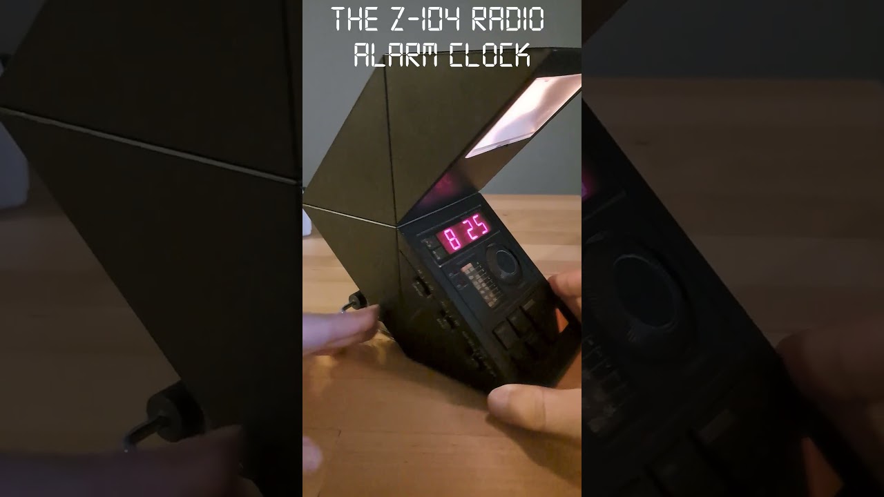

Hoping someone might have a voltage + frequency converter I could borrow? I’d like to test an Australia-spec radio alarm clock (230-240V @ 50Hz) on our Freedom Grid. I suppose I need a step-up converter for voltage and a step-down converter for frequency.
For reference, the clock in question is the transforming weirdo shown here. I got it for a song because it was sold as “untested” – almost certainly meaning “tested and dead” – but want to make sure before taking it apart and replacing its guts with modern tech.
I think the 60Hz → 50Hz conversion might be necessary because clocks of this era will sometimes use the AC frequency to regulate the clock. Getting a voltage converter isn’t terrible, adding frequency to the mix gets expensive in a hurry

@JohnWickham I’ll post a photo in the next day or so, because it’s genuinely fascinating how crammed together it is. That’s part of the reason I have low hopes for it working – some things in there make it look more like a personal project than a finished product. It’s entirely possible someone else had been in there already.
