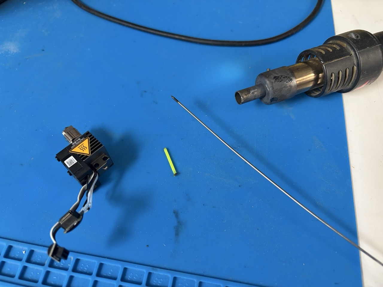

Summary: Filament is jammed
Additional Info: Can’t remove it when the nozzle is heated to 250 C.
This was a fearsome jam. I had to take off the hotend and attack it from above.
We don’t allow open flame at Asmbly, but luckily, Electronics has a hot air system that gets plenty hot!
This kind of jam is often caused by heat creep.
