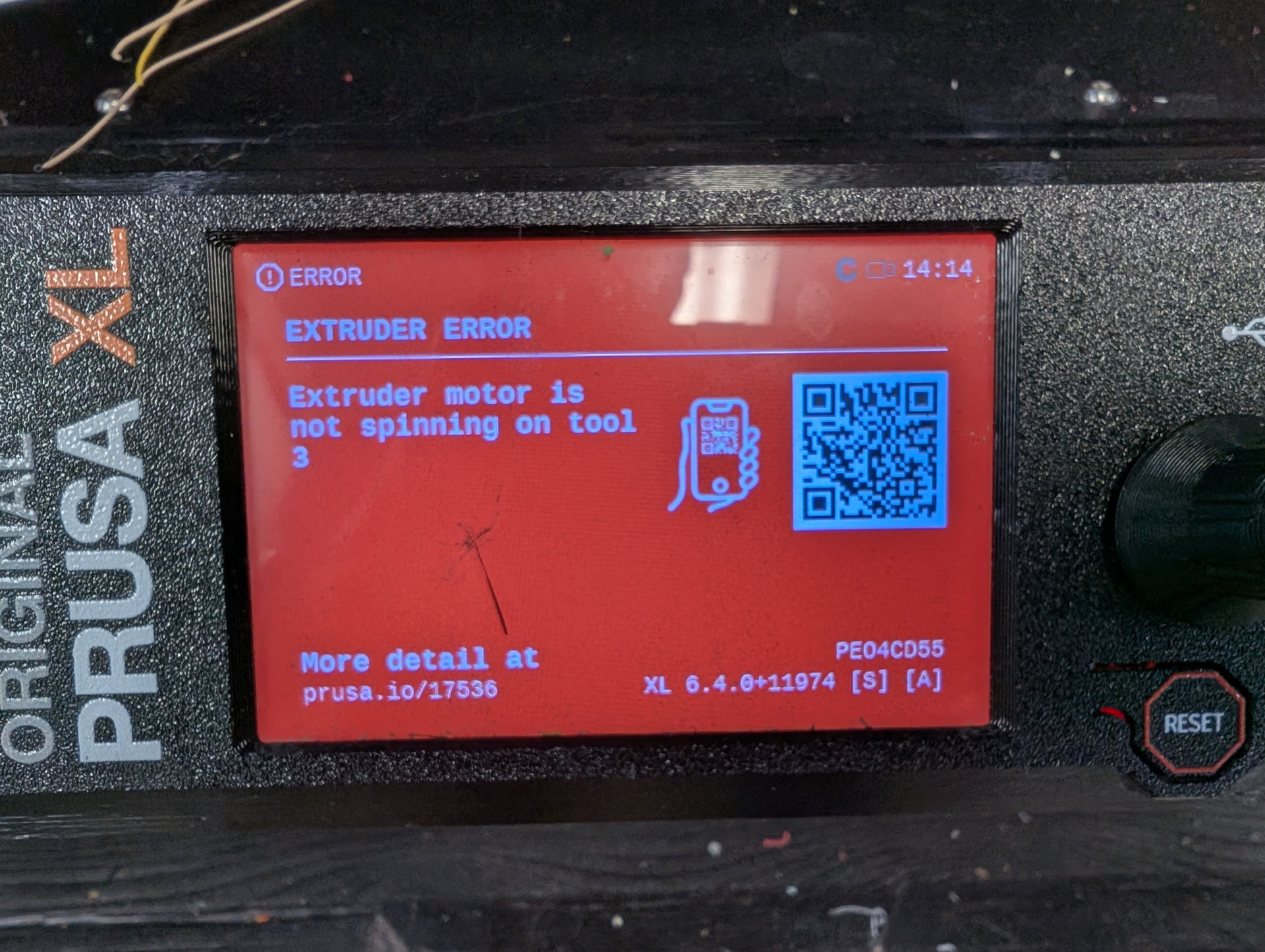

Summary: Extruder 3 reports no movement
Additional Info: No apparent cause, but I’ve tagged the extruder until I have time to troubleshoot.
The Prusa doc only says to remove the cover. Forums seem to have luck cleaning electronics. I’ll try that later today after this print if I have time!
This seems resolved - I cleaned the connectors and had no issue starting the next print.
