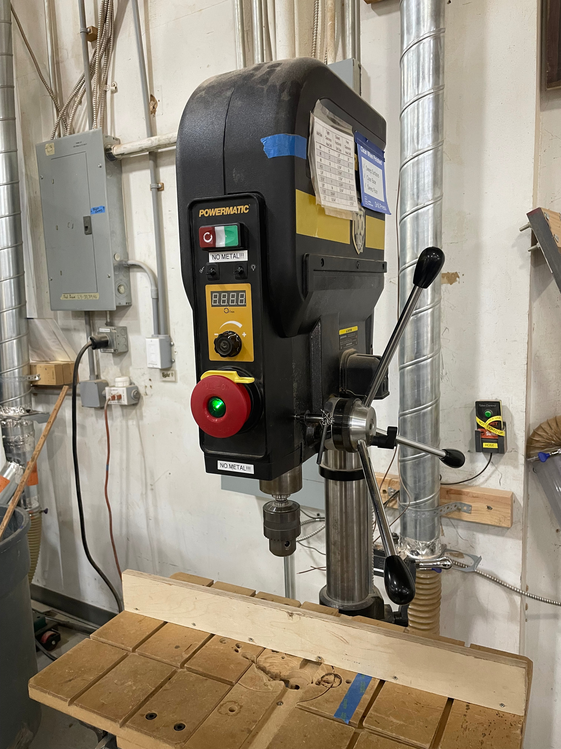

Tried everything to get its spindle to spin. Was told it’s finicky. Replugged it in, emergency power on & off, red power off then green power on, nothing nada worked. Is there a secret chant to the tool gods I’m missing?
I don’t remember if the green light comes on when the fuse is blown.

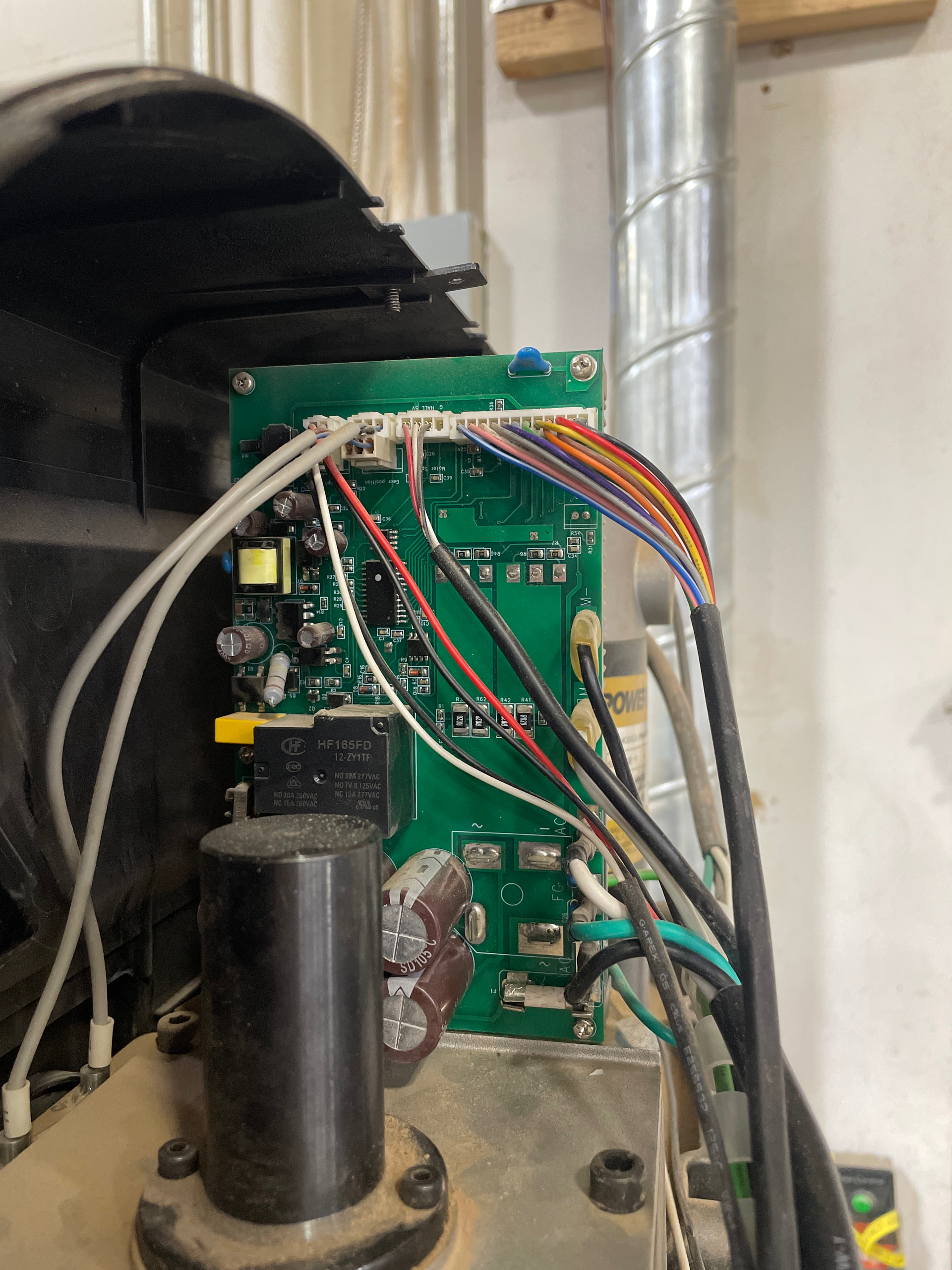

Off the top of my head I don’t recall either. But I’d bet it’s the fuse. I’ll be there tonight. If it’s still blown I’ll change it. That doesn’t help you :confused: but if that’s the issue it will be fixed.
I assume the fuse is internal to the unit
It is, but pretty easy to get to. It’s behind that piece of blue tape (under the cover, I’ve course) on the upper right side.

Opened the drill press and did a continuity test on the fuse which read “open” so I do think that the fuse is blown. Also the clip holding the fuse is loosely holding it which is not good. I closed it all up afterwards.
Does anyone happen to know what size fuse is currently in there?
Yes it’s been loose for a while. We keep trying to crimp it back together but it keeps going loose.
I haven’t ever done testing. I just replace the fuse. I think others are doing the same but I’m not sure.
