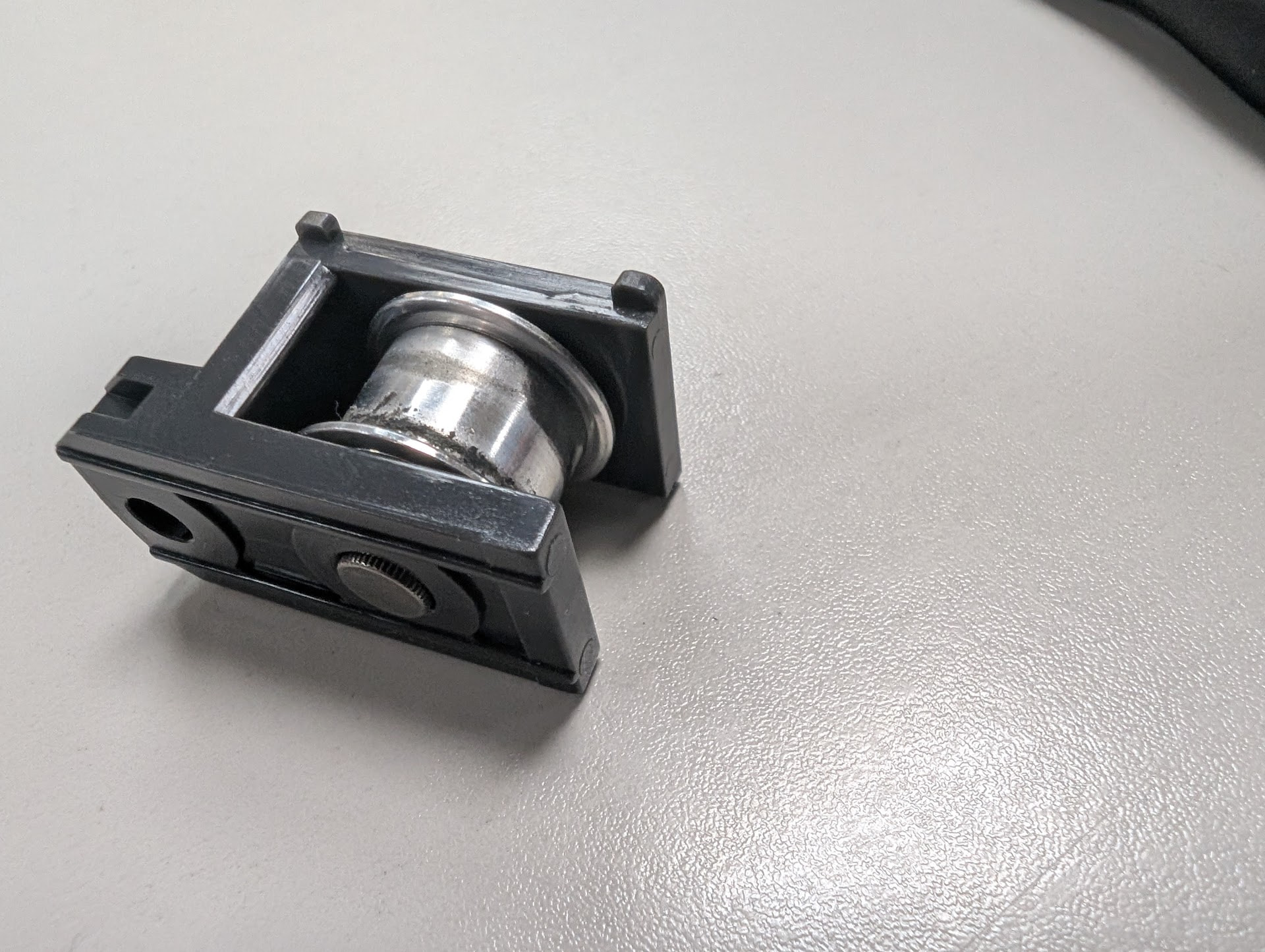

  • Plan: Dig deeper on Hanuman’s Z axis issues. :white_check_mark: Done! It was quite dirty, and I expect we may want to do a similar short maintenance on other P1S printers in the future. It’s now cleaned up, and passed Z-calibration and a test print just fine. Again, please report any issues!
