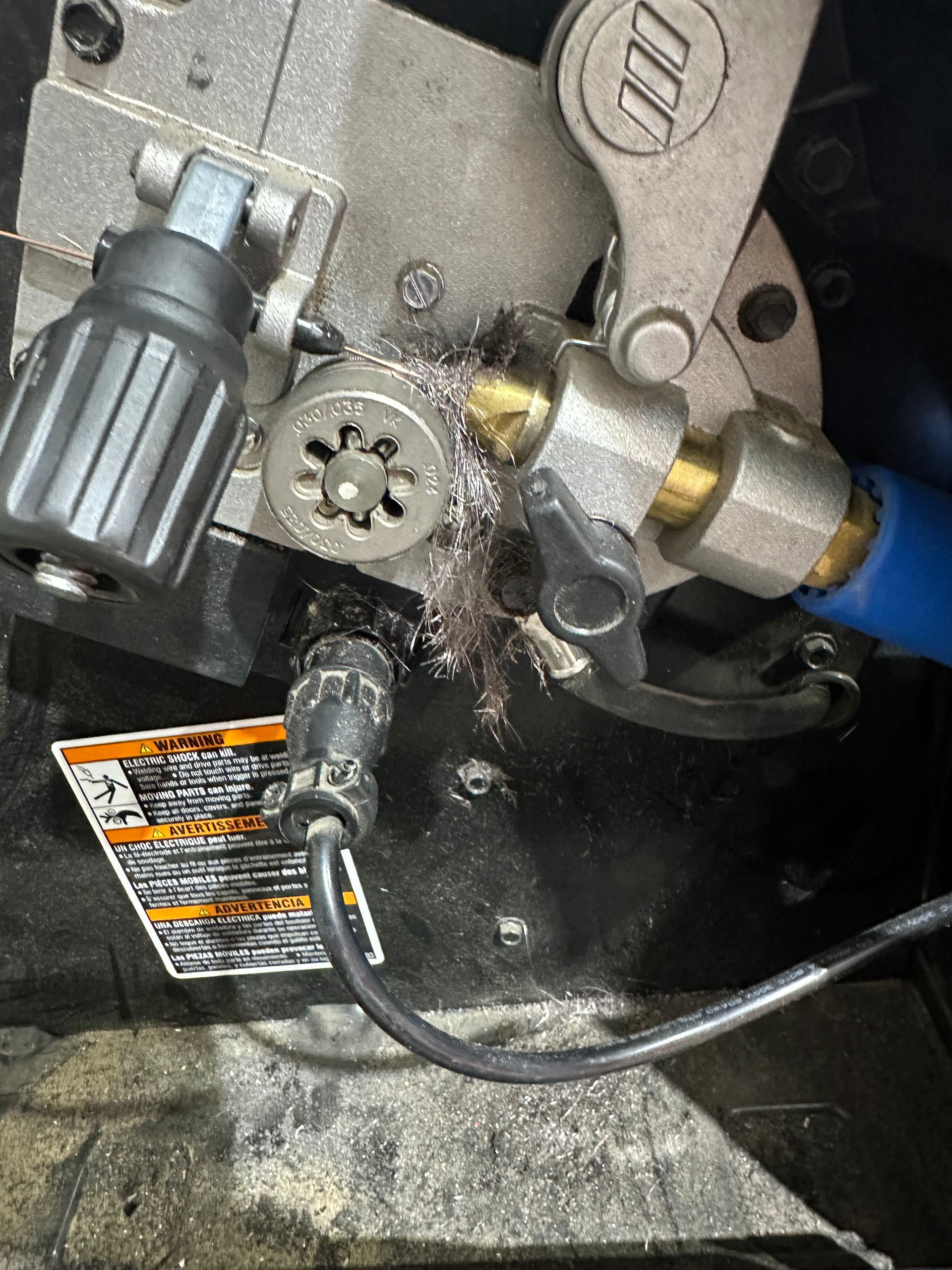

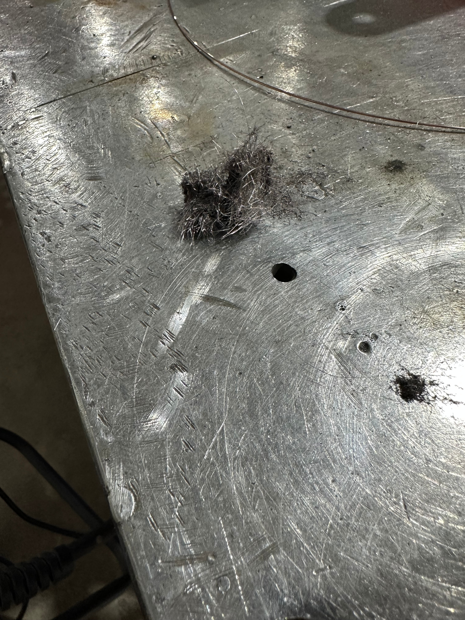

Summary: MiG gun wire feed channel obstructed
Additional Info: Wire feed sleeve has an inside burr that strips shards of wire causing obstruction at entry; MiG gun currently removed from machine. Needs burr filed off; will return today with files needed to remove burr.
