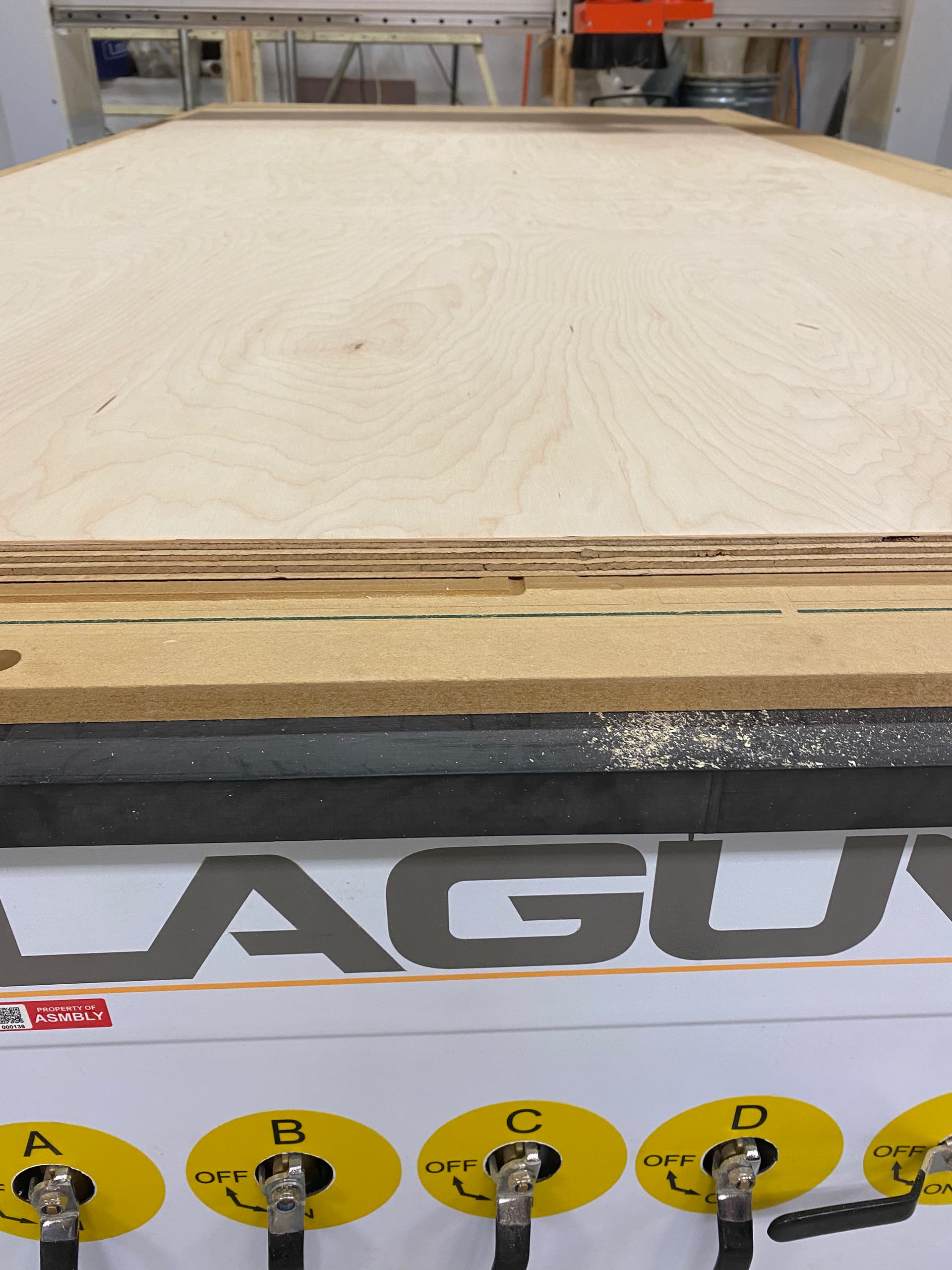

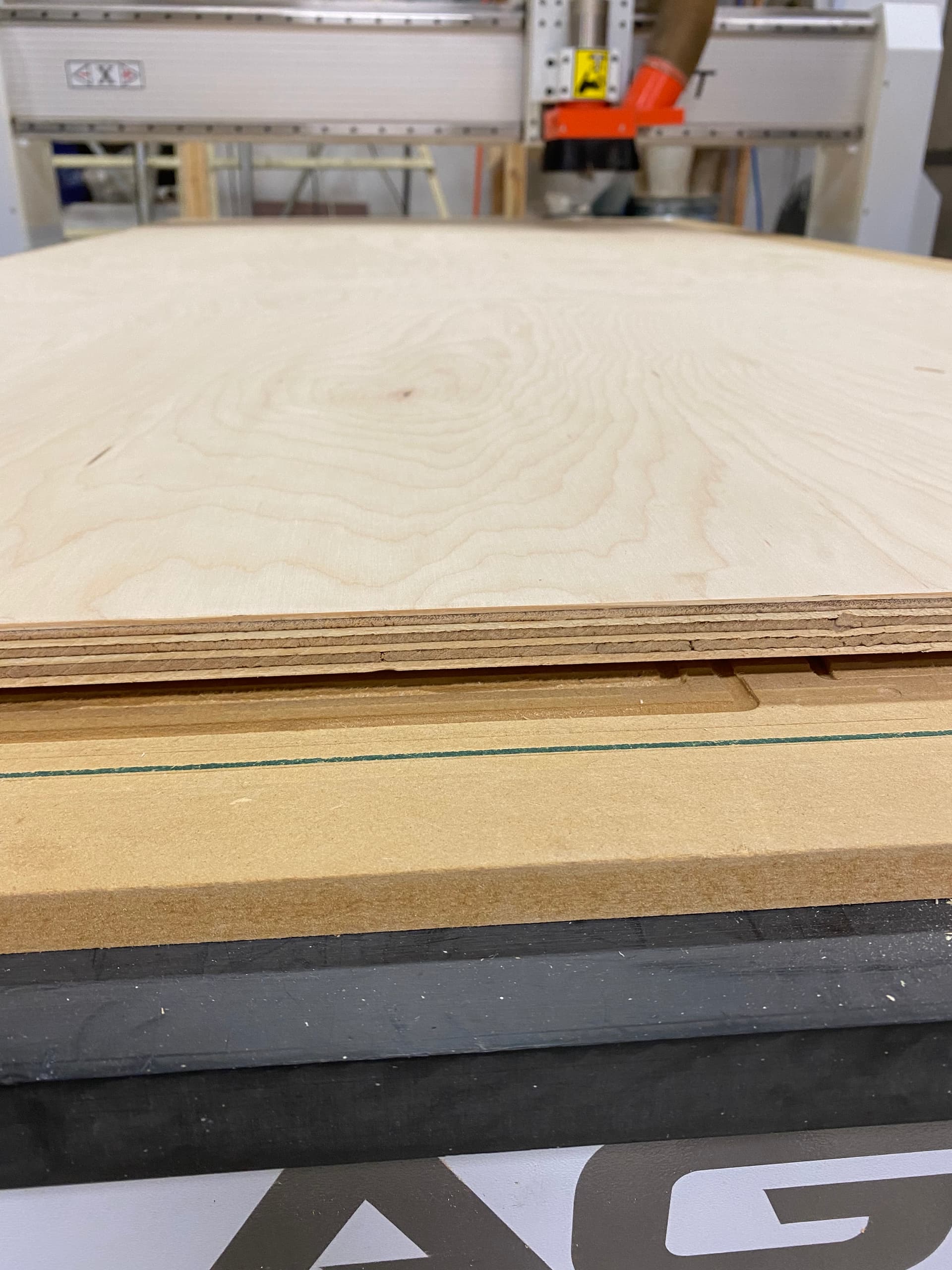

The vacuum table worked great. One sheet had a severe bow that lifted the middle about 1/4” off the table. Turned on both vacuums and it completely flattened out and stayed flat.

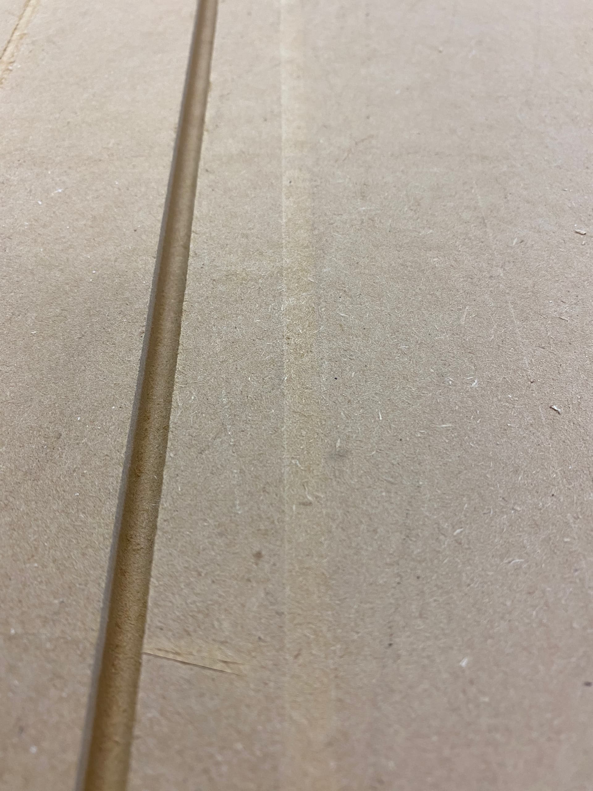

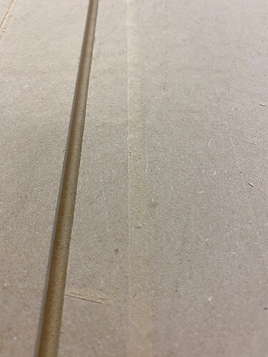

My cut depth was perfect on the first panel, barely skimming the surface (line on the right). I kept all the same settings for the second panel. Unfortunately, on the second panel I somehow managed to change the controller to a different work coordinate space, which changed the Z height and I ended up cutting a deep trench in the spoil board (line on the left). I’ve discussed what happened with James.
