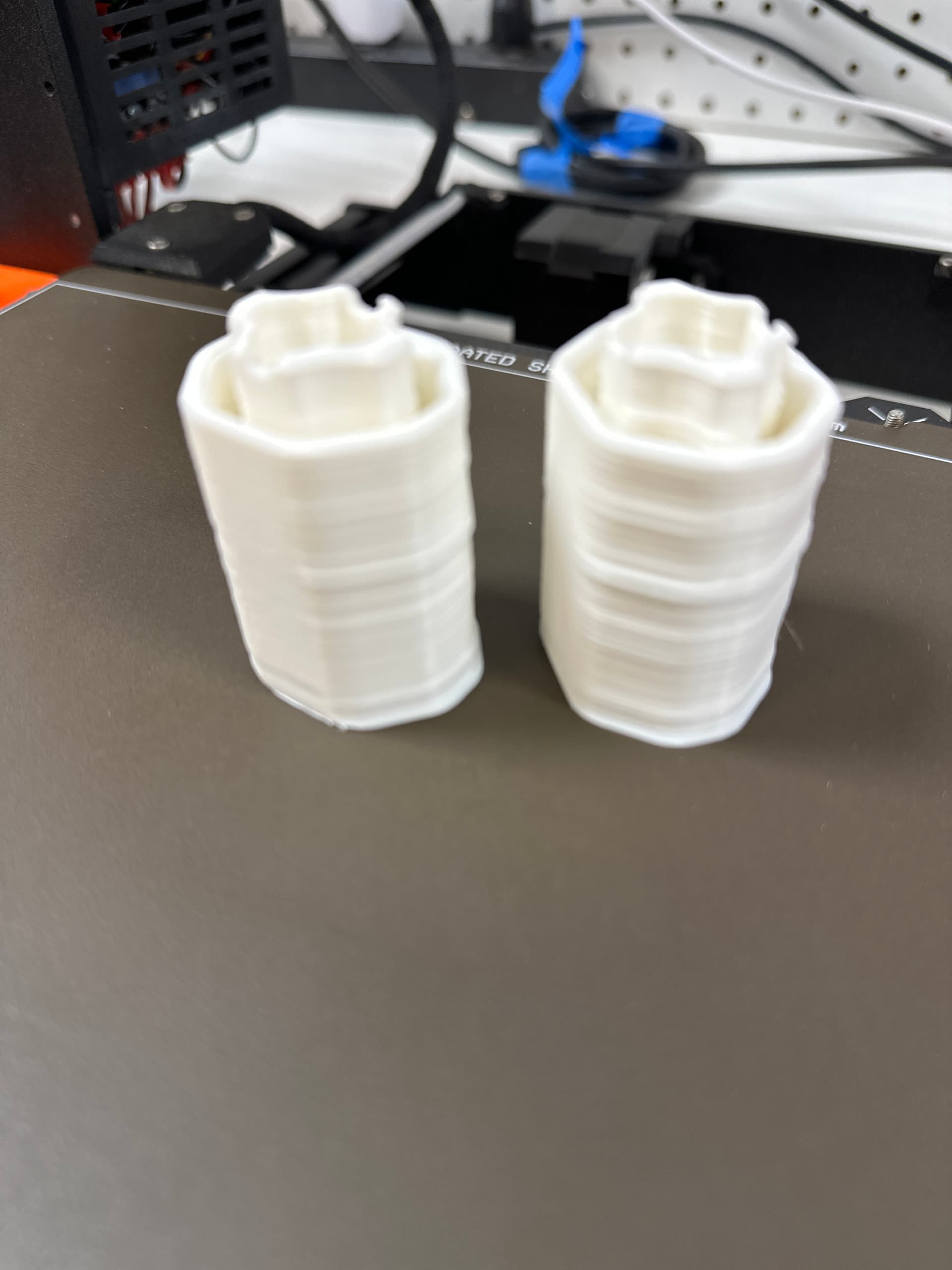

Summary: Irregular print
Additional Info: The layers of the print did not print correctly. Ripples instead of smooth sides
Here is a photo of how they turned out.
This is a common symptom of a printer that requires further adjustment of belt tension. :man_health_worker:
I adjusted the Y belt on Hermes on Saturday and got clean cylinders. If it’s not holding its tension, perhaps the belt needs to be replaced?
I’m thinking the same too. I think we’ve already adjusted the belt at least three times since November’s volunteer day.
I’ve ordered some replacement belt material. @JakeS, if you’re still around, would you mind putting a physical red tag on Hermes? There are some on the front of the big enclosure.
@aneel added a red tags to Hermes and Apollo.
I replaced the belt on Hermes and it didn’t fix the problem. We’re going to have to do some deeper debugging.
@flowmage and @Kenneth successfully identified the issue remotely (the grub screw on the Y-axis shaft had come loose), and @ewei fixed the problem. Hermes should be back in business.
