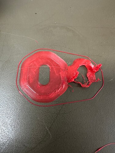

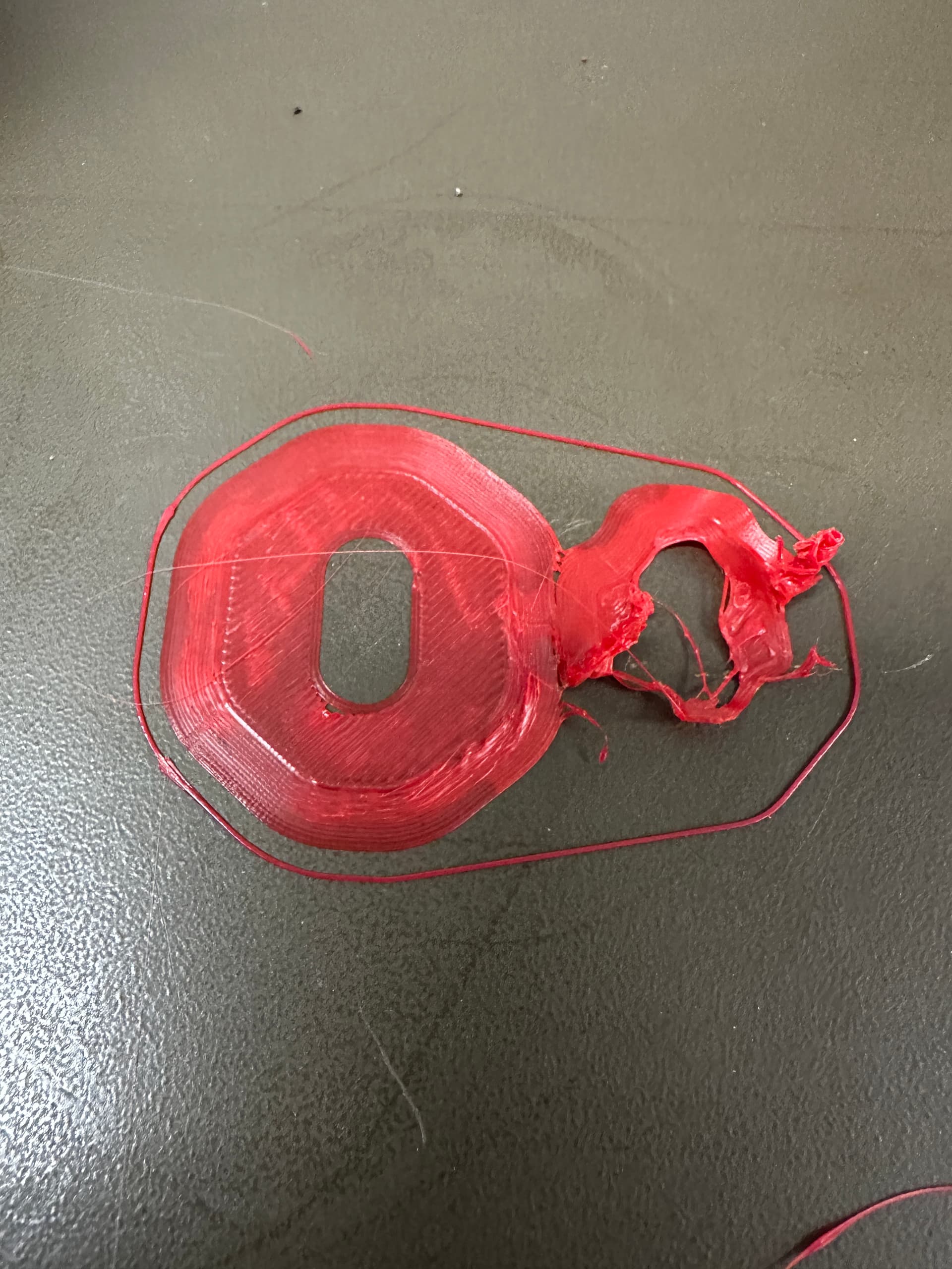

I cleaned the nozzle and then tried a test print.
Thanks for the photos. Did it look like the first layer was okay, but then it got pulled up by the second or subsequent layer? Or was the problem evident from the very first layer?

I can do as instructed when I go back tomorrow to get my print. Looking closely at the layer it did seem like it got pulled up but even in sections that were laying flat it had globs like the flow of the filament was off?
While it’s possible that there’s a problem with the extrusion rate (either because of a problem with the extruder drive mechanism or because the slicer used a bad setting), my experience is that that happens more often when the nozzle drags on the previously-printed layers.
This can happen because there was bad bed adhesion in the first layer and the print lifts up off of the build plate. Once the nozzle starts making contact with previous layers it often gets melted filament on the outside of the nozzle, which causes all kinds of quality problems.

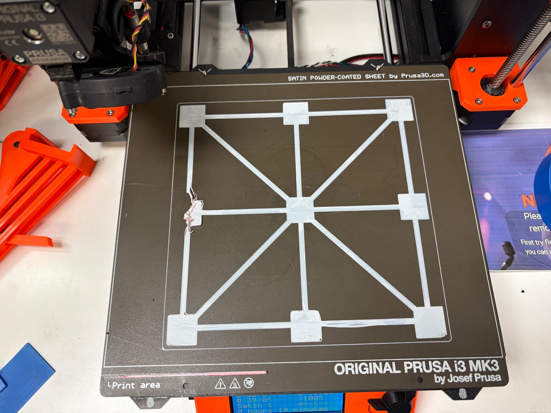

Before cleaning with dish soap, there was a problem on the left center:

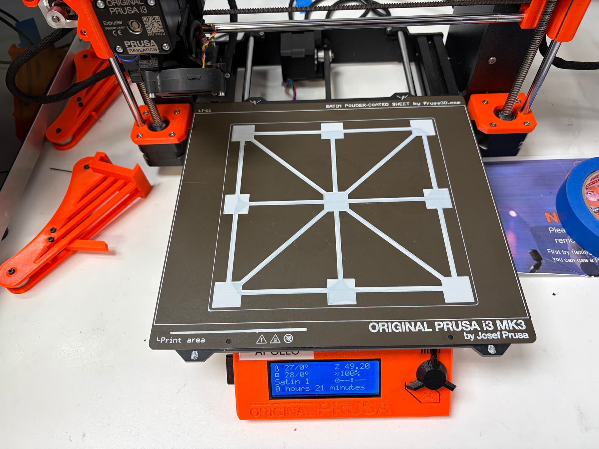

After cleaning:
