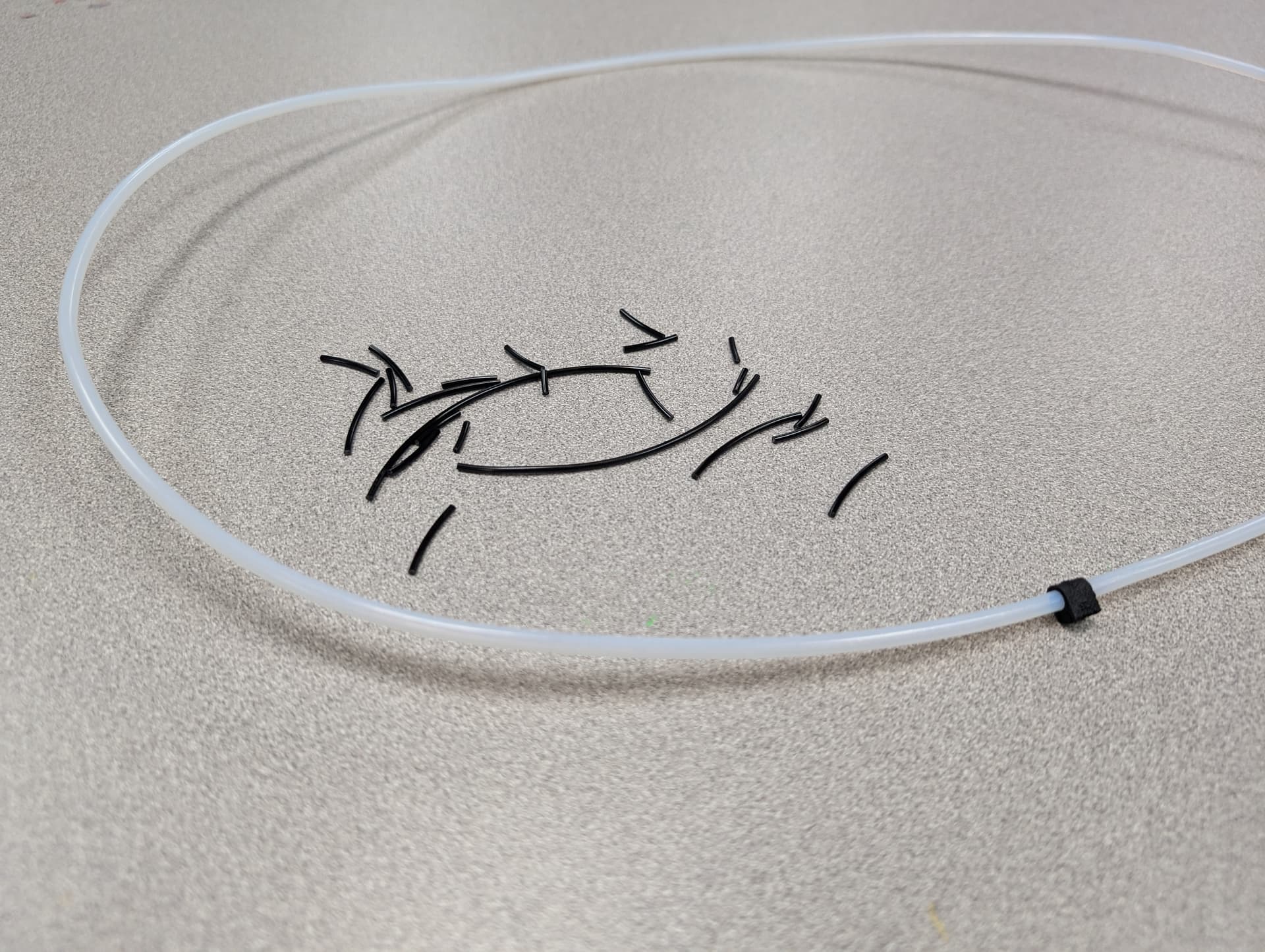

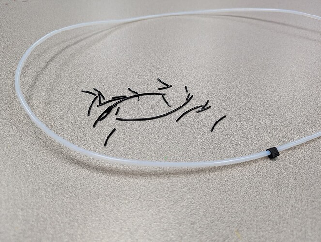

Summary: Filament stuck in extruder 2
Additional Info: Some unfortunately brittle PLA broke while it was loaded on extruder 1. It is stuck in the clear tube. Adding a yellow tag.
The tube unscrews at the extruder end, so you might be able to get it to fall out using just gravity.
It was stuck for sure. I had to further break it and match the curvature of the filament to get pieces to come out with compressed air. :slight_smile:
