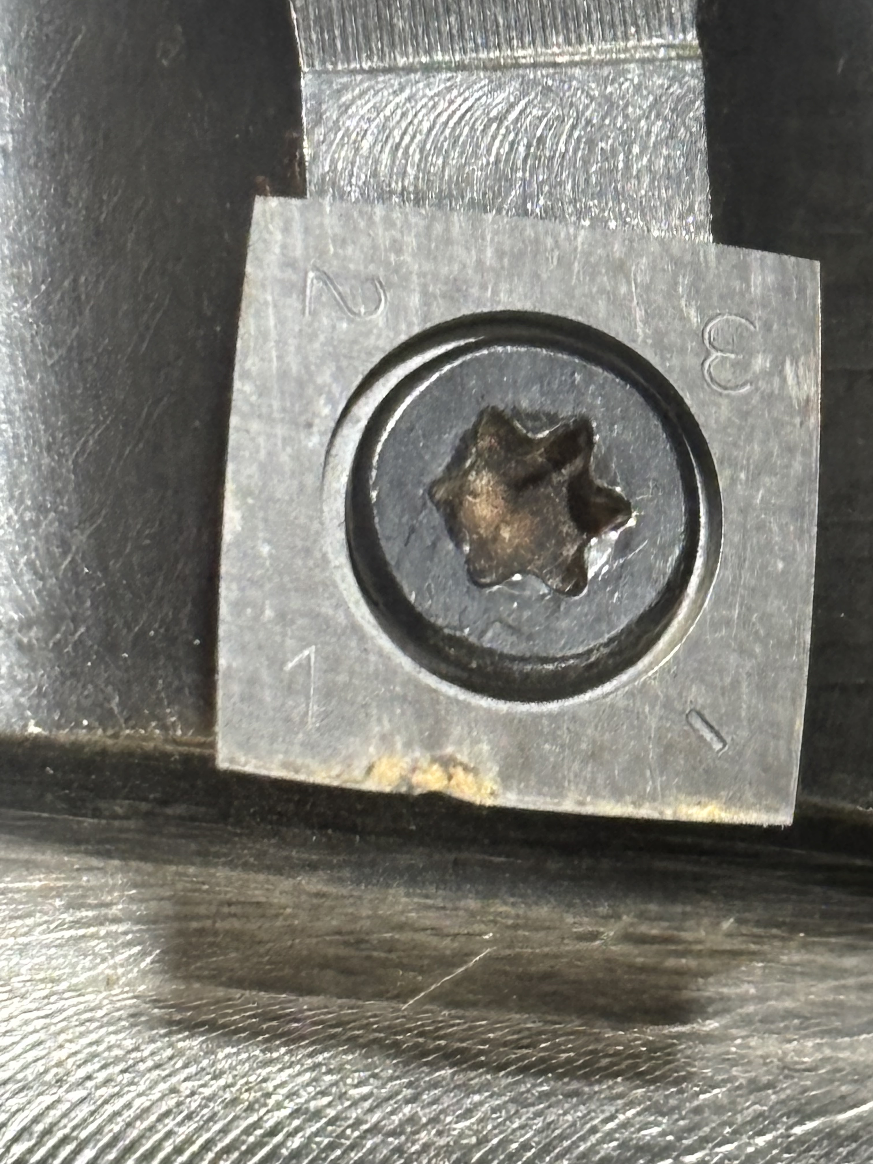

Summary: Chipped blade?
Additional Info: Boards are coming through with a couple lines roughly in the middle of the table. I’m assuming there is a chipped blade or two
This blade (4th from the top) could be the culprit, but I couldn’t find the proper torx driver to turn it.
I’ve covered it with the fence.
Chipped blade has been rotated. All the other blades were checked and retorqued.
