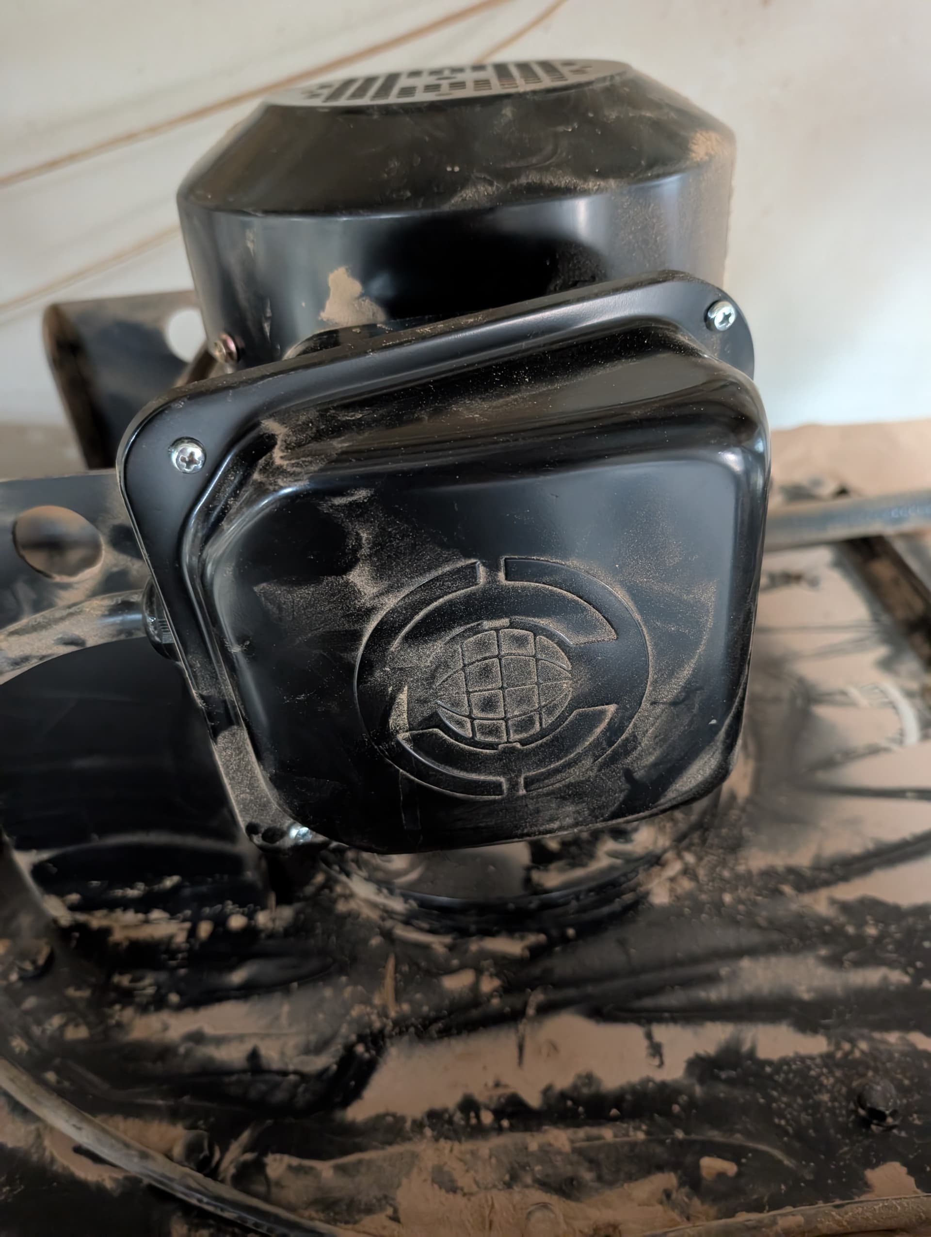

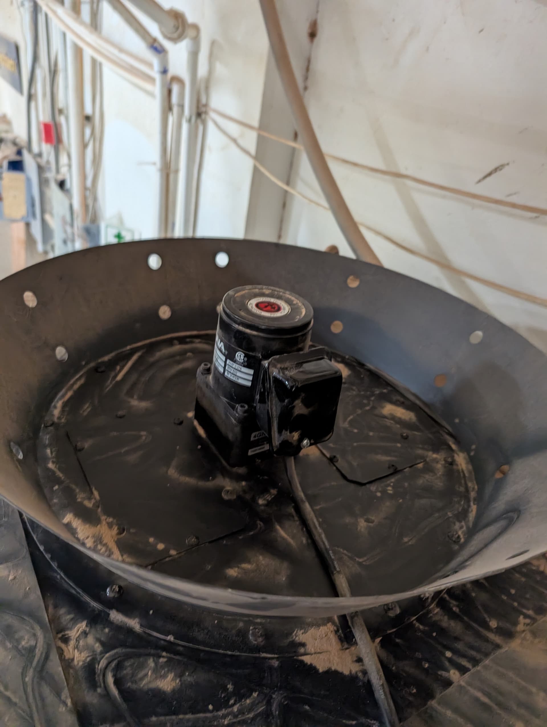

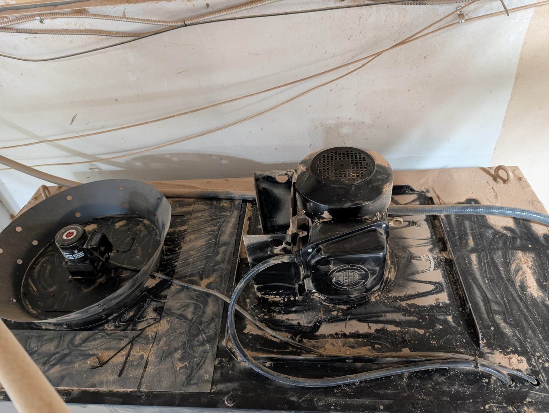

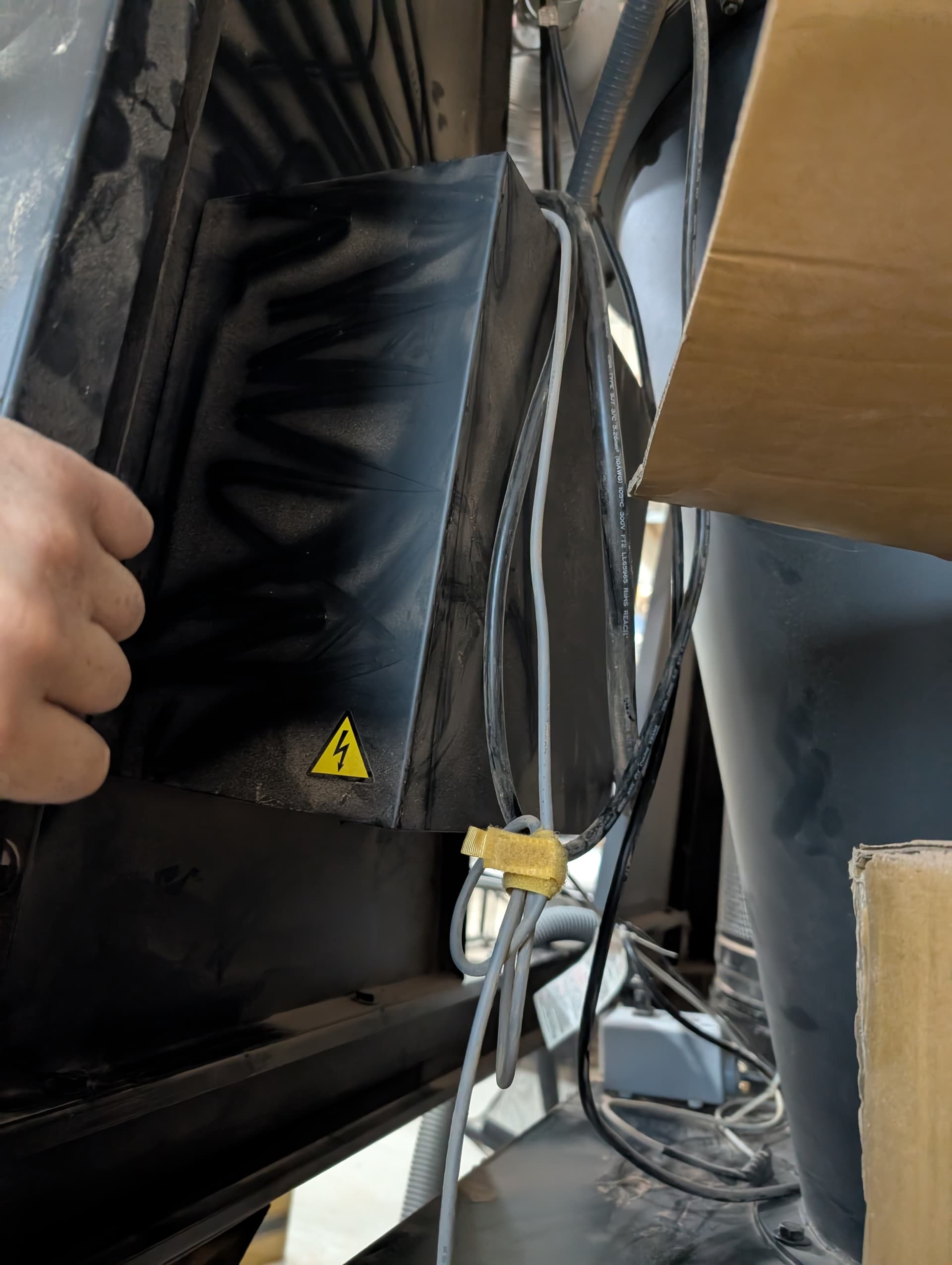

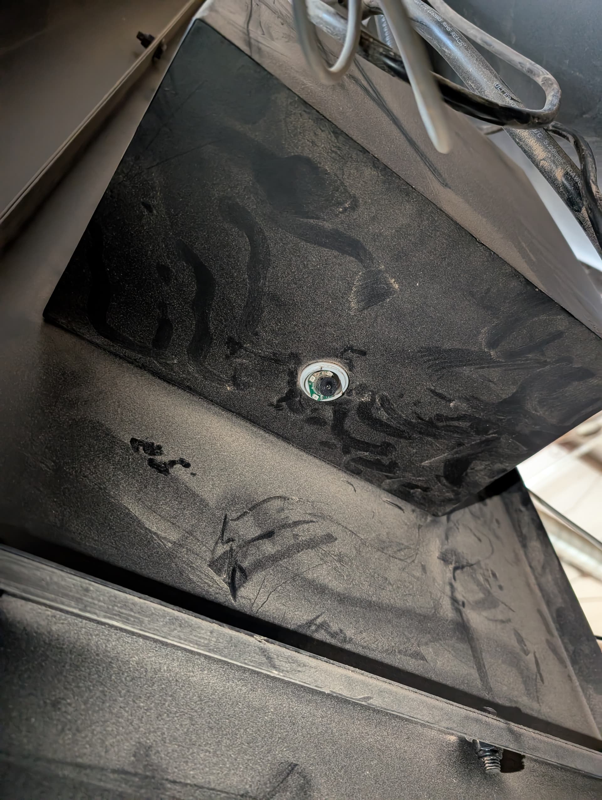

View From the top. I opened up these two panels. No sign of excess dust, burning smells, or charring.

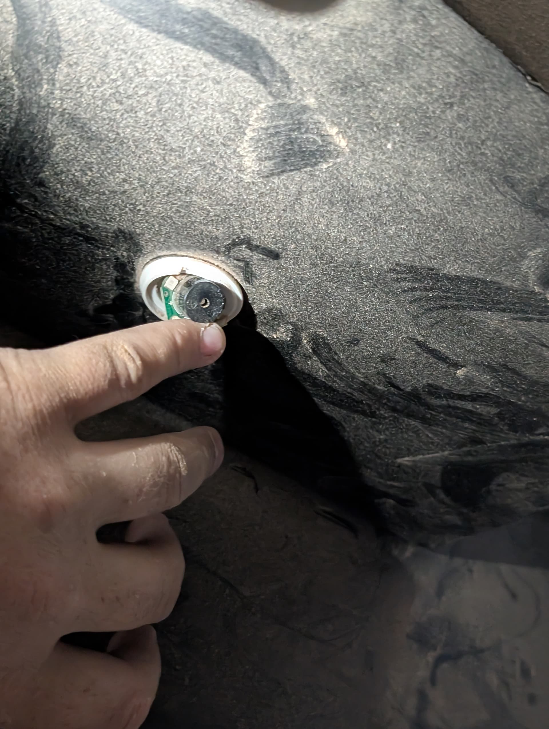

I don’t hear anything. Click when I try to turn the machine on.

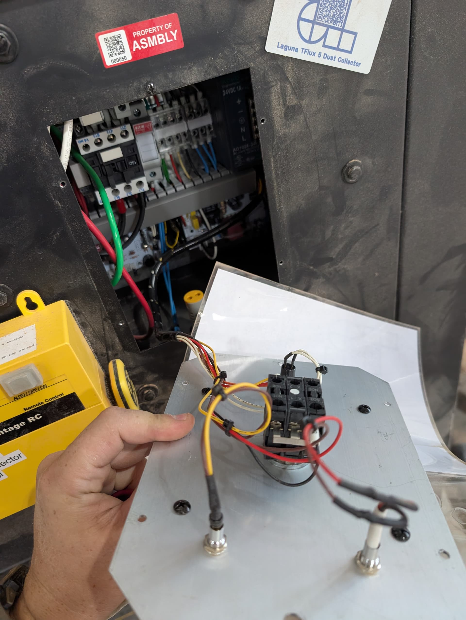

On this box, not sure how to open it. Feeling around there’s something that feels loose underneath.
It is accessible from the from panel.

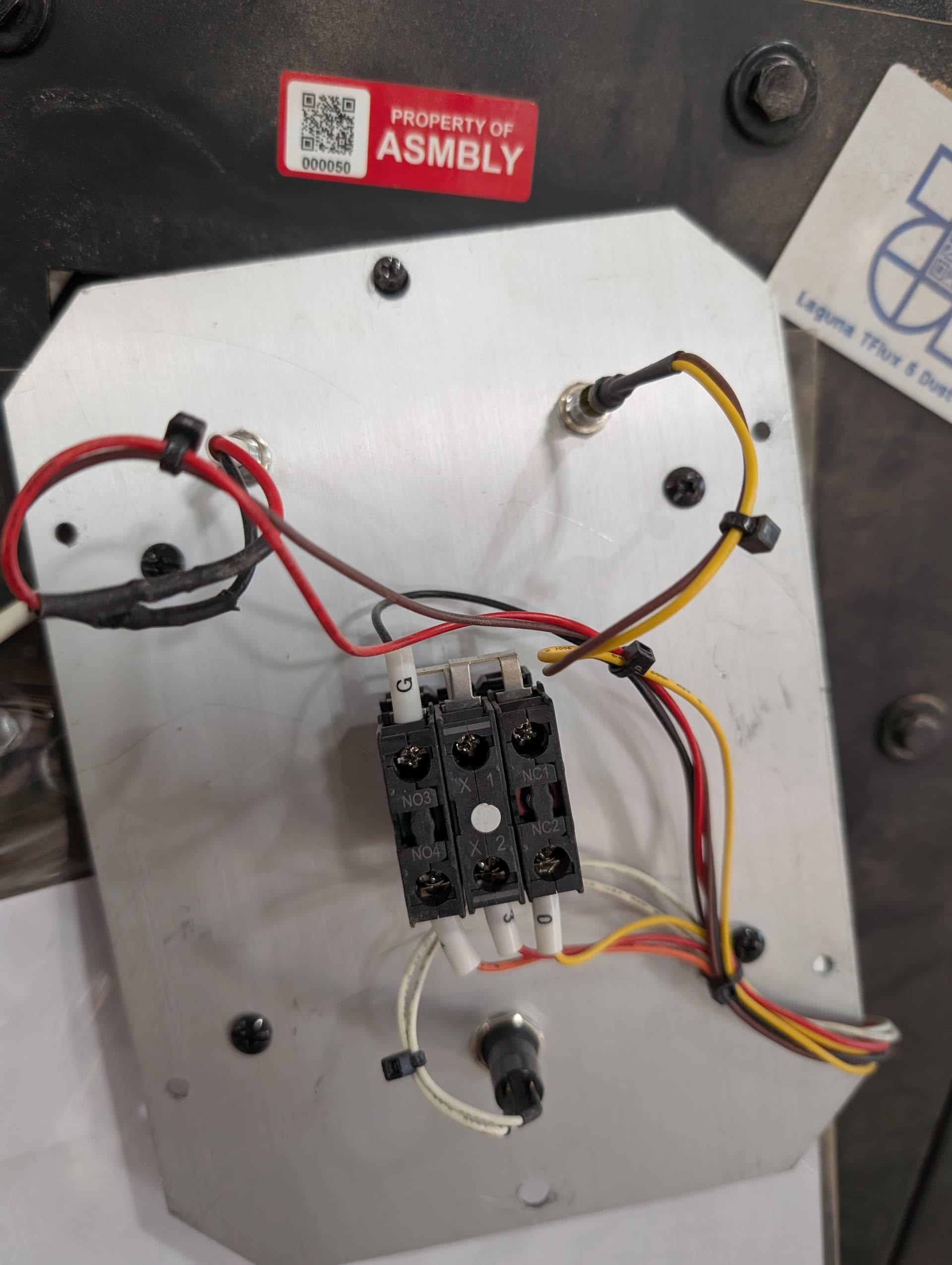

Front panel, continuity test on the power on/off switch seems good.

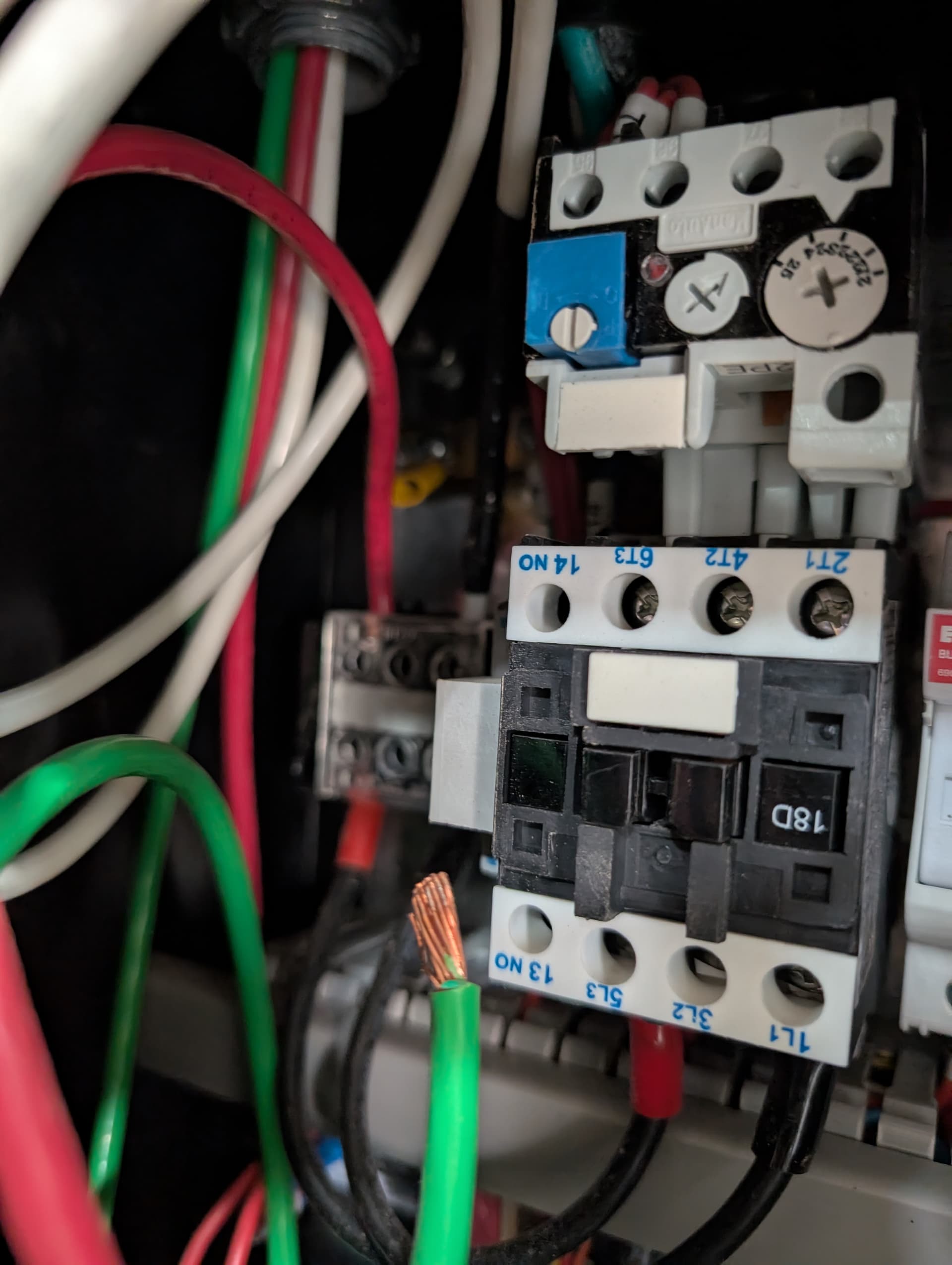

Found what appears be a ground wire not connected
Ahh the sweet sweet sound of high velocity air sucking.
We’re back in action.
Thanks to @Jeffmc for a little sanity checking and help getting that write back in place and secured.
