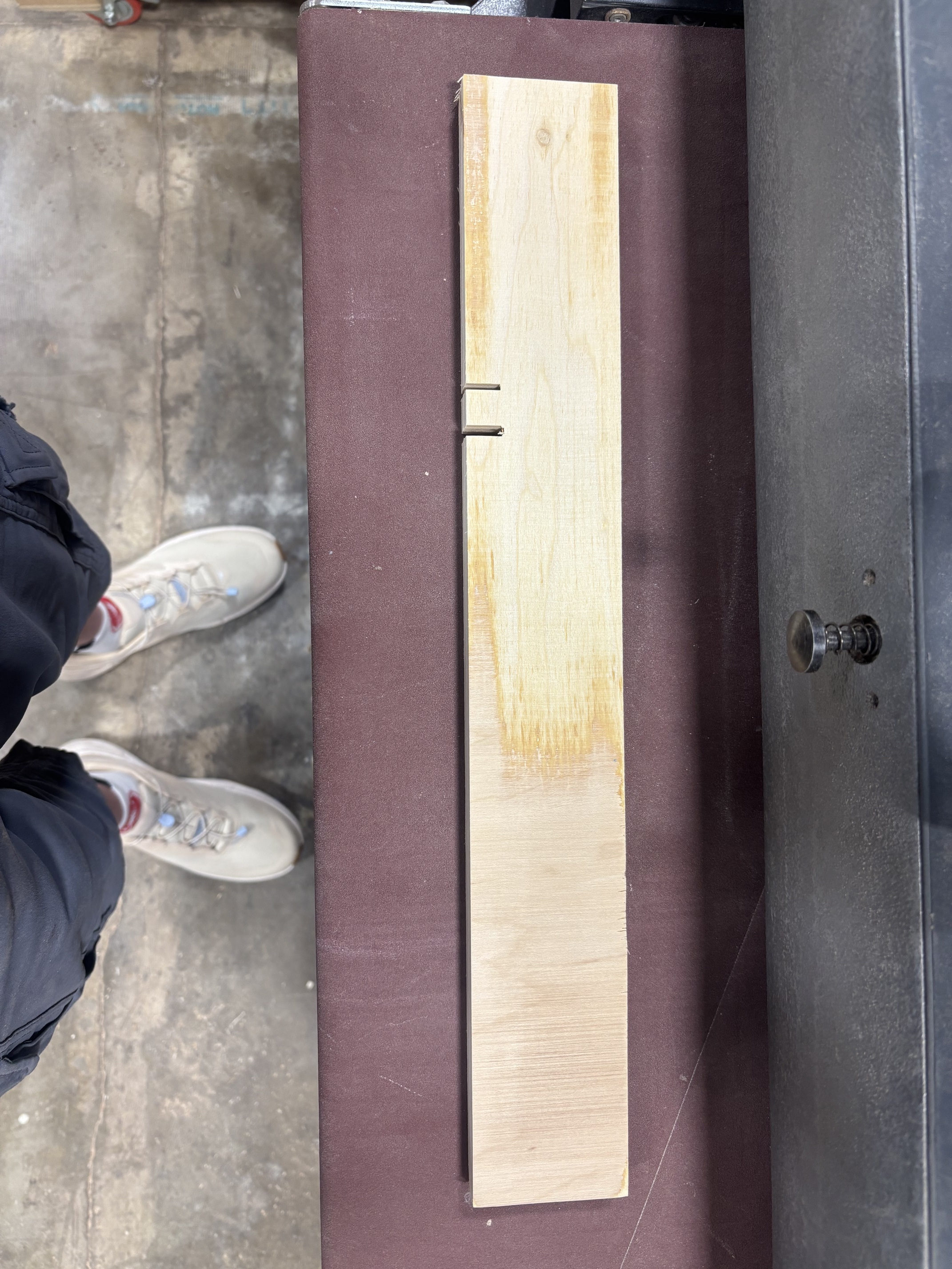

Summary: Drum not level
Additional Info: I noticed that the drum sander was sanding the left side of my piece more than the right. I got an 18” piece of scrap plywood, that was 0.705” on the left side and 0.701” on the right. I put it through the sander until both sides got sanded. Then, the left side measured 0.6545” and the right measured 0.6785”.
This is what the wood looked like, halfway through.
