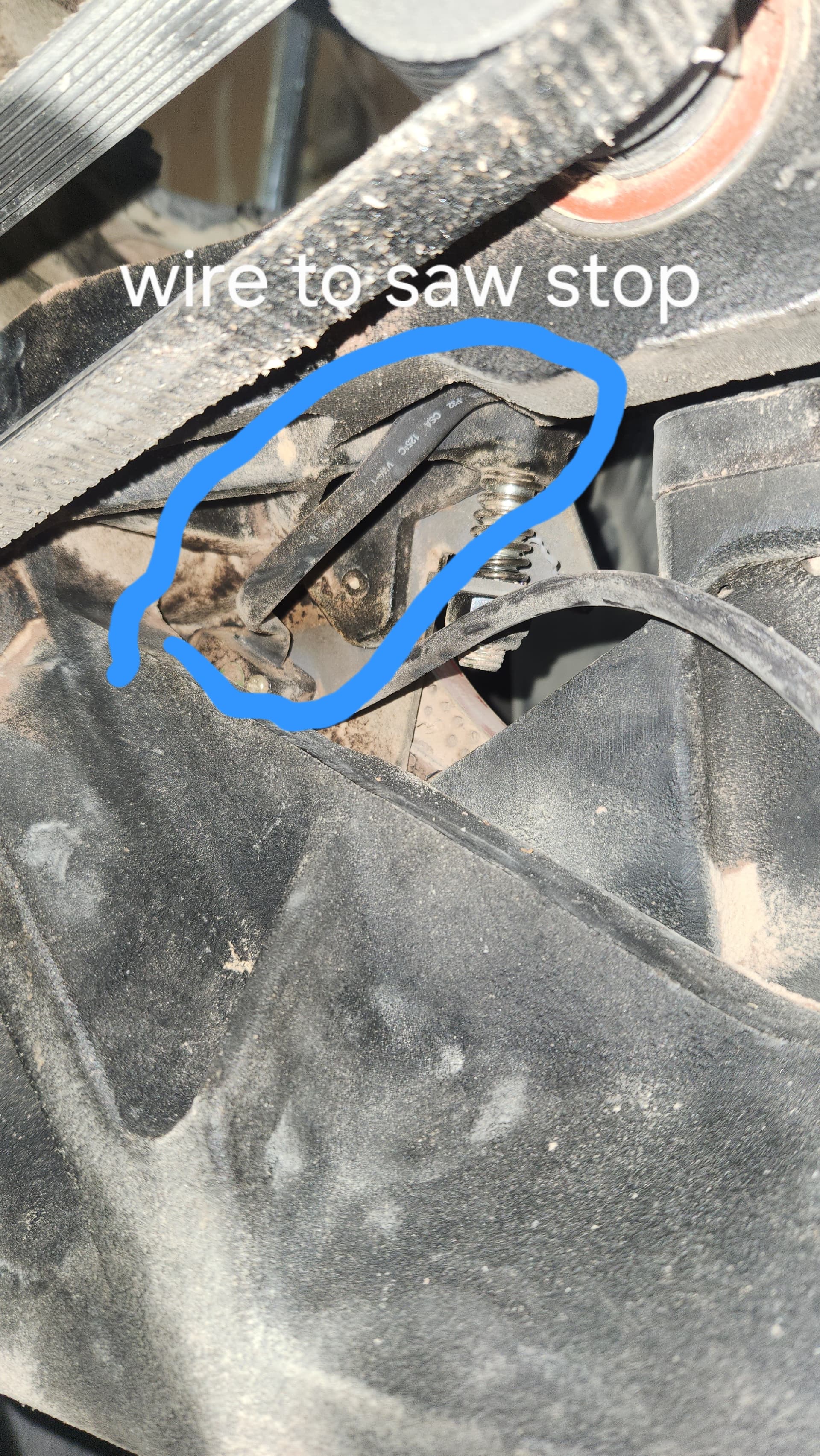

The wires to the saw stop attachment definitely saw some heat. they did not melt fully. We might want to consider replacement. Pic 1

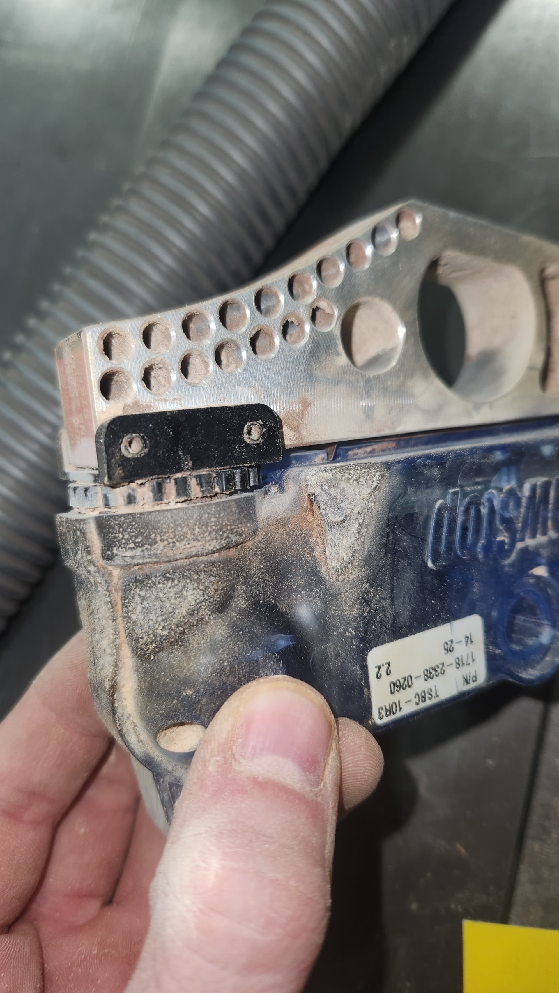

The saw stop break is certainly ruined. Pic 2. I red taged it and left it inside the saw cabinet door so it doesn’t get installed other one.

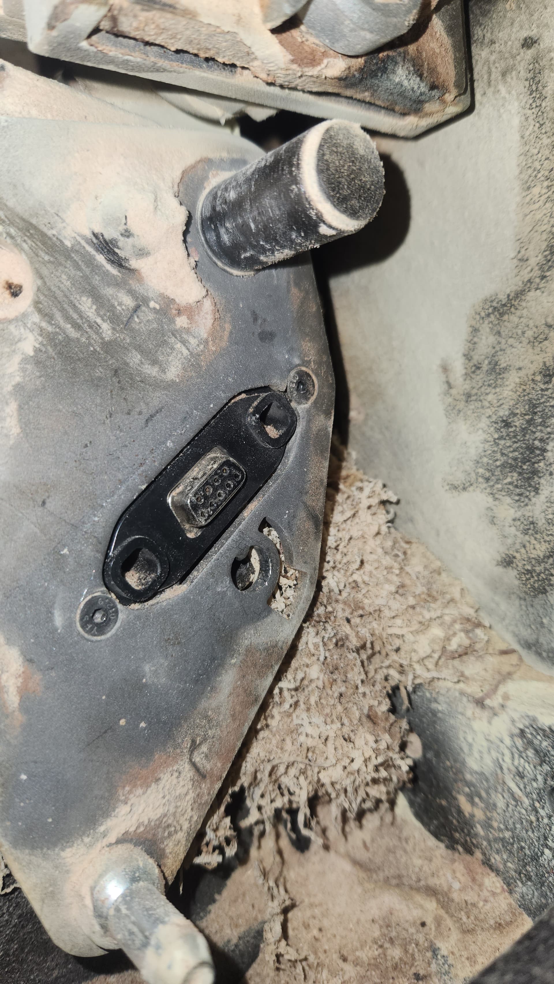

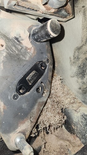

The belts, saw stop connector, and other internals look fine to me.

SawStop sells a cable replacement kit if needed.
I’d think if it didn’t get hot enough to melt the insulation off , then continuity would not be an issue… Once the new brake is installed a check for any error codes and checking cosuctrivity with the power on but blade off .
