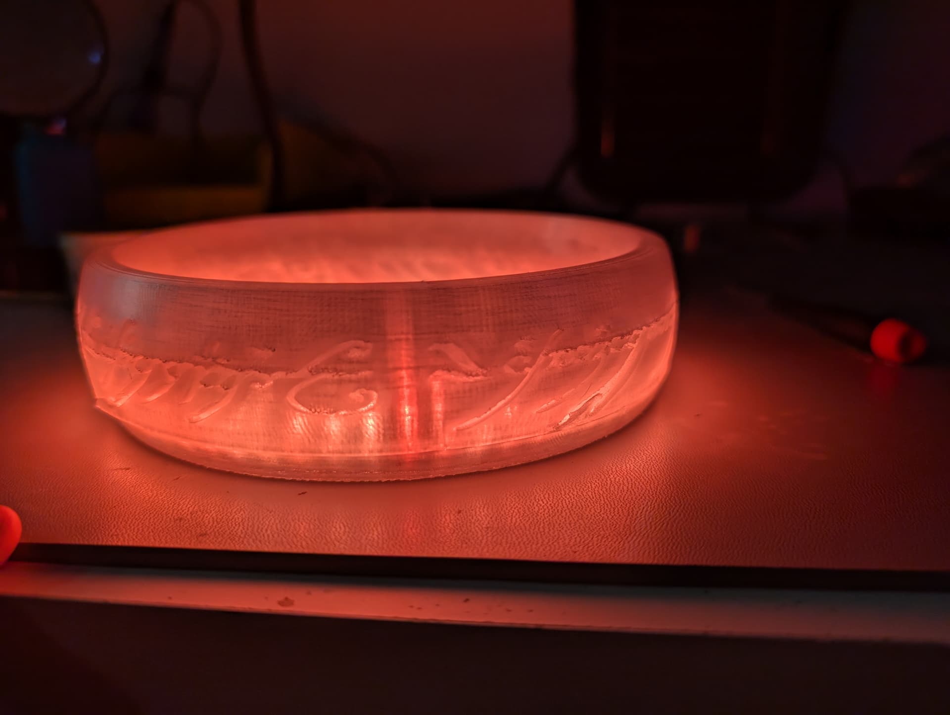

Thanks especially to John and Kenneth for hanging out with me for an hour getting my recalcitrant ESP8266 to flash! It was really nice to know that I had indeed tried all the basics, AND to have some experienced hands suggest more things to try.
After our work, WLED is flashed on my device and working… here’s a sneak peek!
If you’re wondering, the final secret was jumping IO0 to GND got the chip up in boot loader mode. Just like one of the docs said. Except… the second pin labeled GND on the board was not really ground - it just controls which output IO pin goes to the data line output. So we had to manually jump IO0 to a real ground, in my case the case of the USB plug itself. :man_facepalming:
Nice! Glad to see it working, it’s looking great. Is it a steady glow or a WLED flame effect?
Flames! :fire::sunglasses::fire:
