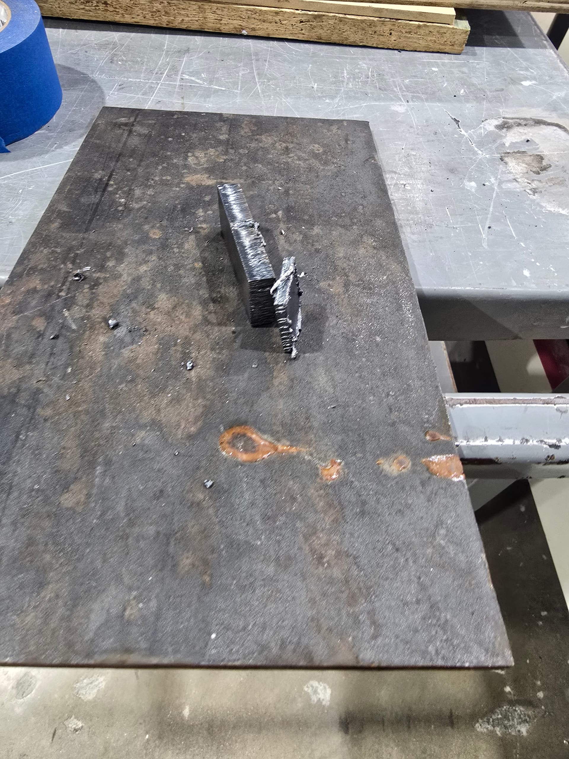

Next came the focus trials. Using parameters and the process advised by our consultant, we verified we can’t get the correct beam to the material. 1/8” steel is what we are testing on, bit the focus was always off, and the adjustment couldn’t correct it enough. While we were testing, we found that raising the cutting height to a much higher position than it should be, gave us an ideal kerf but poor cut.
So back to checking all the settings and machine. After more research, and more trials, it was discovered that we have the wrong focus length lens in the collimator. Silly mistake, but should be an easy fix.

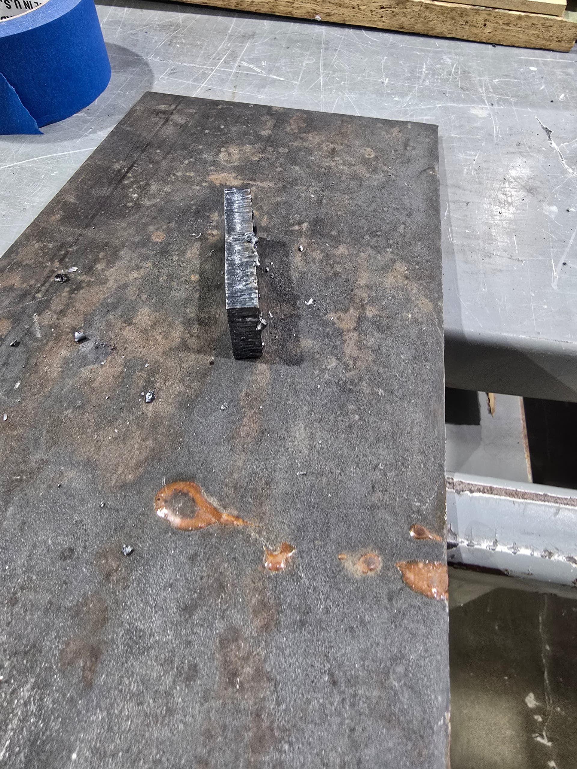

Ironically, because the focal length was to low on the 1/8” material, that meant it would likely be correct for thicker material. To verify, we tested cutting through 5/8” steel last night. The machine had no trouble with it. Thanks to @phurfphurf and @JCicolani for being there to soundboard and encourage me on.
I’m optimistic we are finally on a correct path forward. There is still a good amount of work to go and the timeline is still questionable. Most parts are slow to order from China. We’ll be discussing hiring a consultant to help finish the project and get us to the finish line.
Thanks for everyone’s patience along this journey, and feel free to ask any questions.
Pics of test cuts.

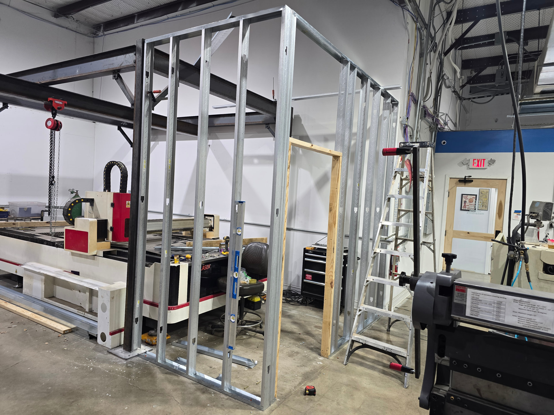

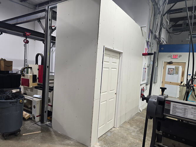

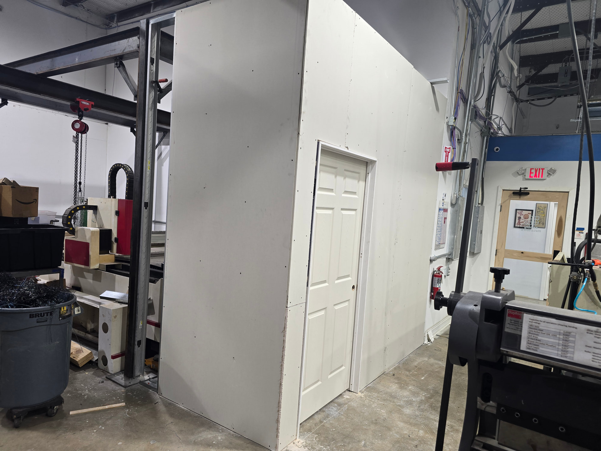

Work has resumed on building out the rest of the enclosure for the Fiber Laser. We have a plan for creating the sliding doors for the loading side, and the rest is straight forward.
If anyone is good with tape and floating drywall, you’d be my best friend.
Thanks again for everyone’s patience and understanding in this long process. I believe the finishline is in sight, although I’m hesitant to put a date on it. I’ll contunie to update here as progress is made.

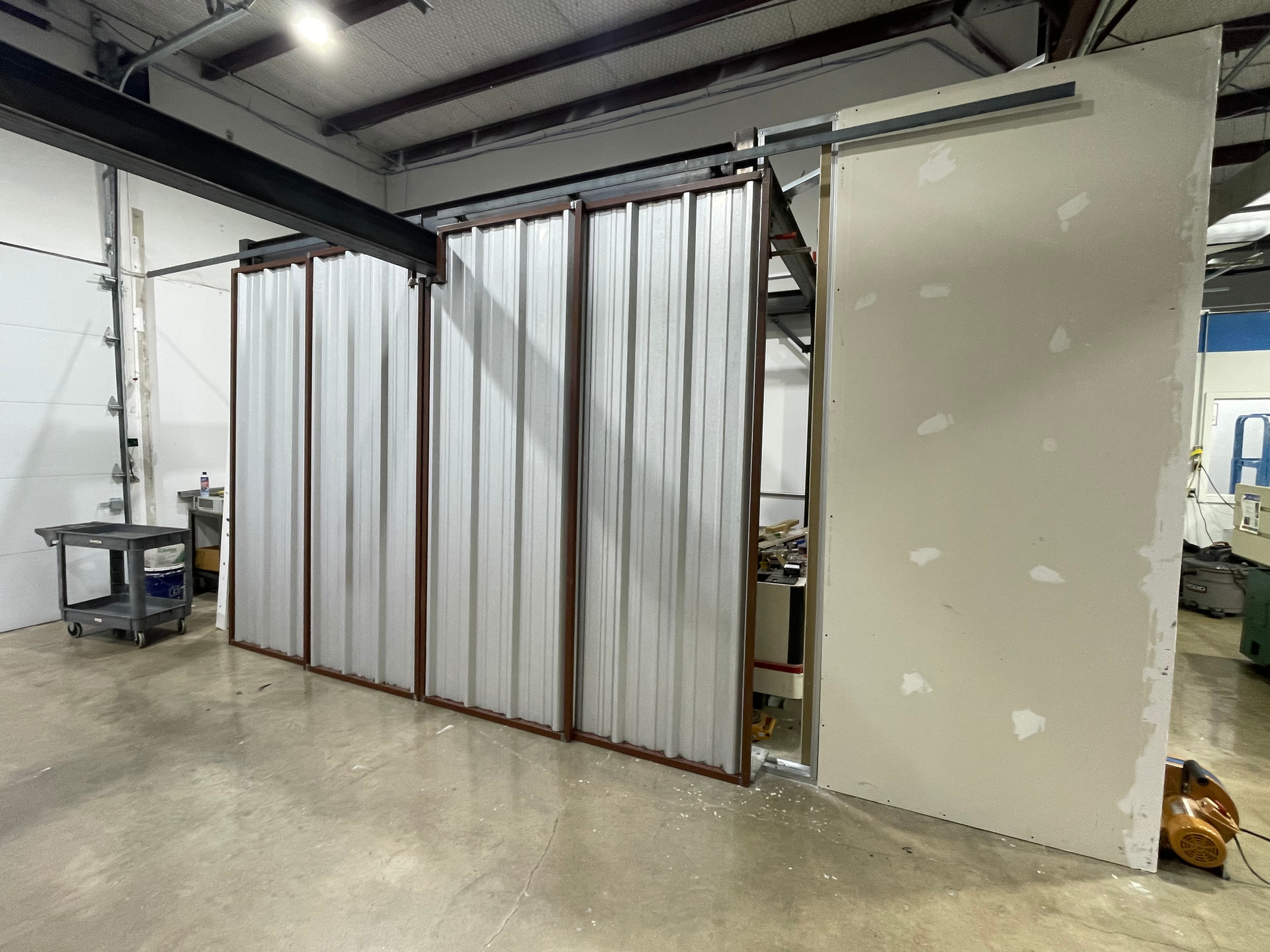

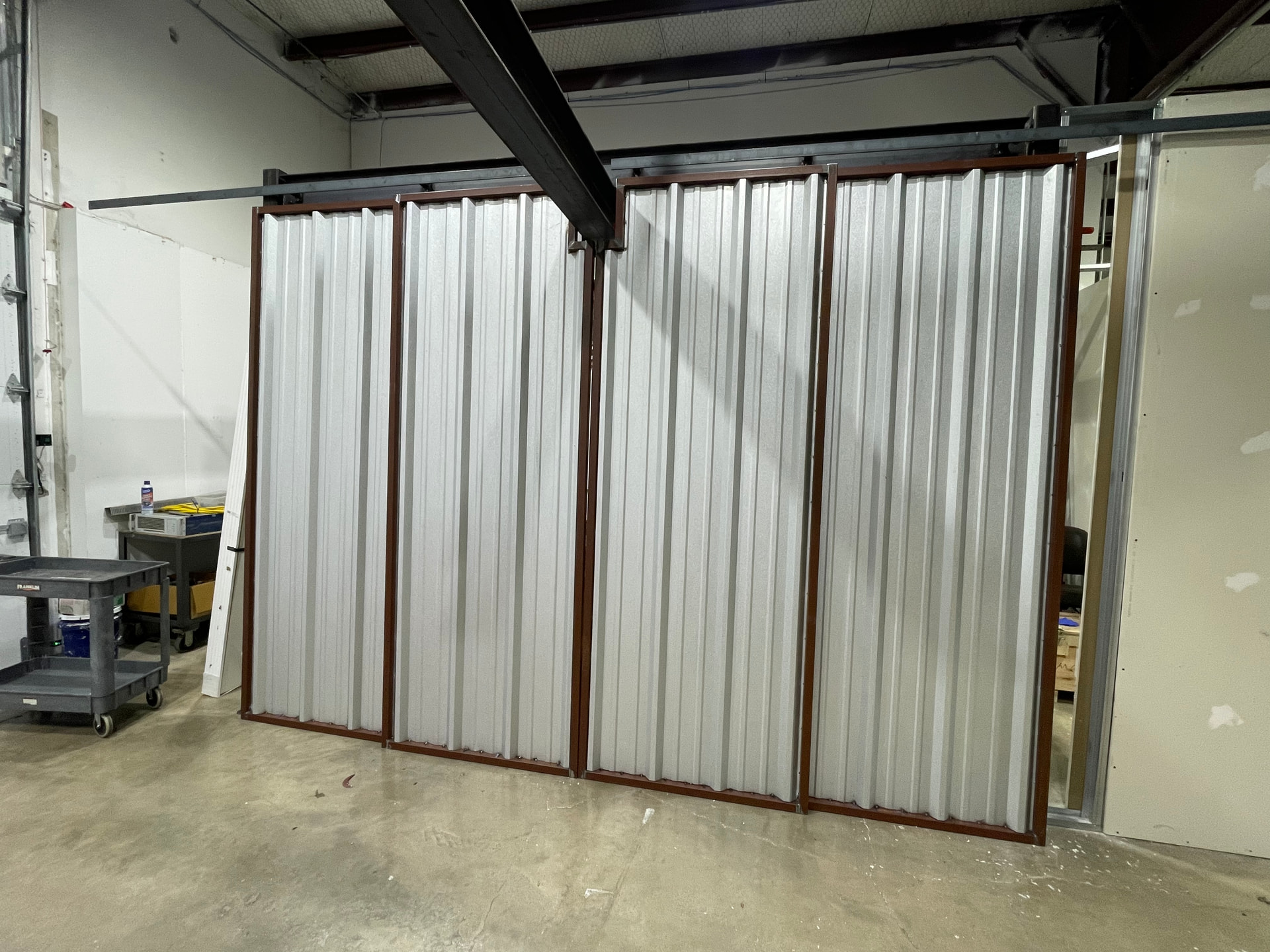

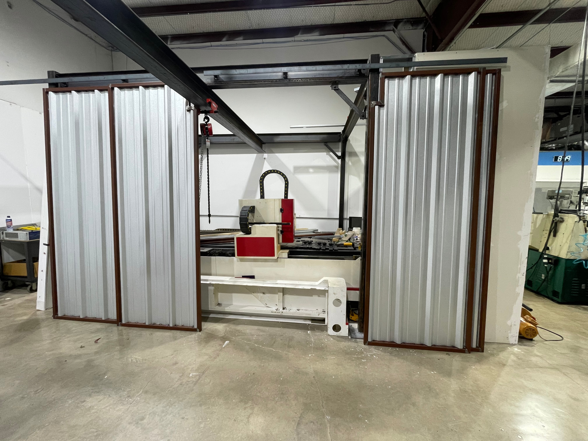

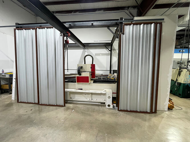

More progress on the enclosure is being made. Big shootout to Jon for not only designing and getting a materials list, but for also fabricating the large metal barn doors for the enclosure. This is a big hurdle to clear to help get the machine ready for testing and class development.
