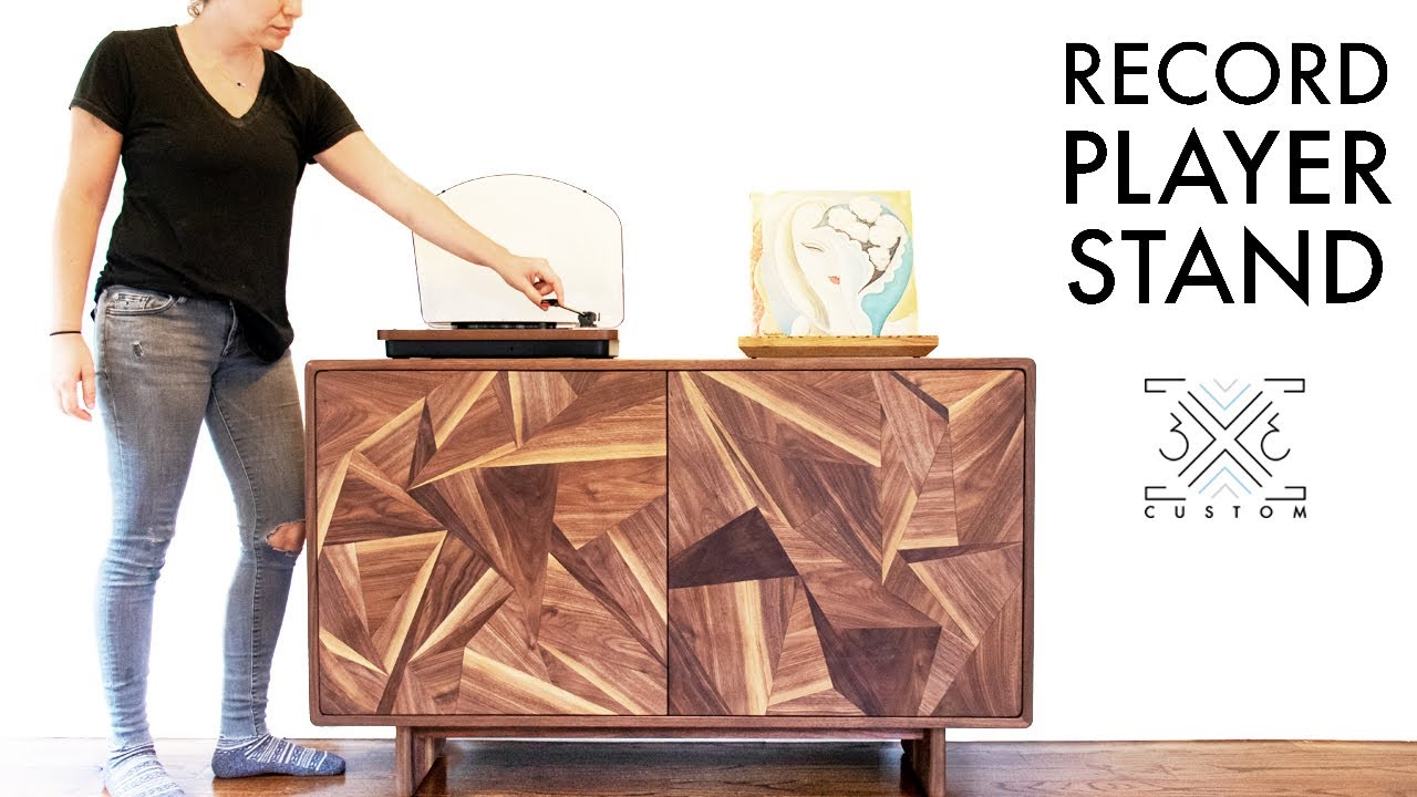

Al, not sure how that works but would love to learn. Is there somewhere online of a similar project that used the same process? Thanks
I’ve never done this, but here is one video I saw about it. Just one way of doing it. I’m sure there are many more out there.
I have made a rudimentary pattern out of solid wood, and I wish I had done this instead.
