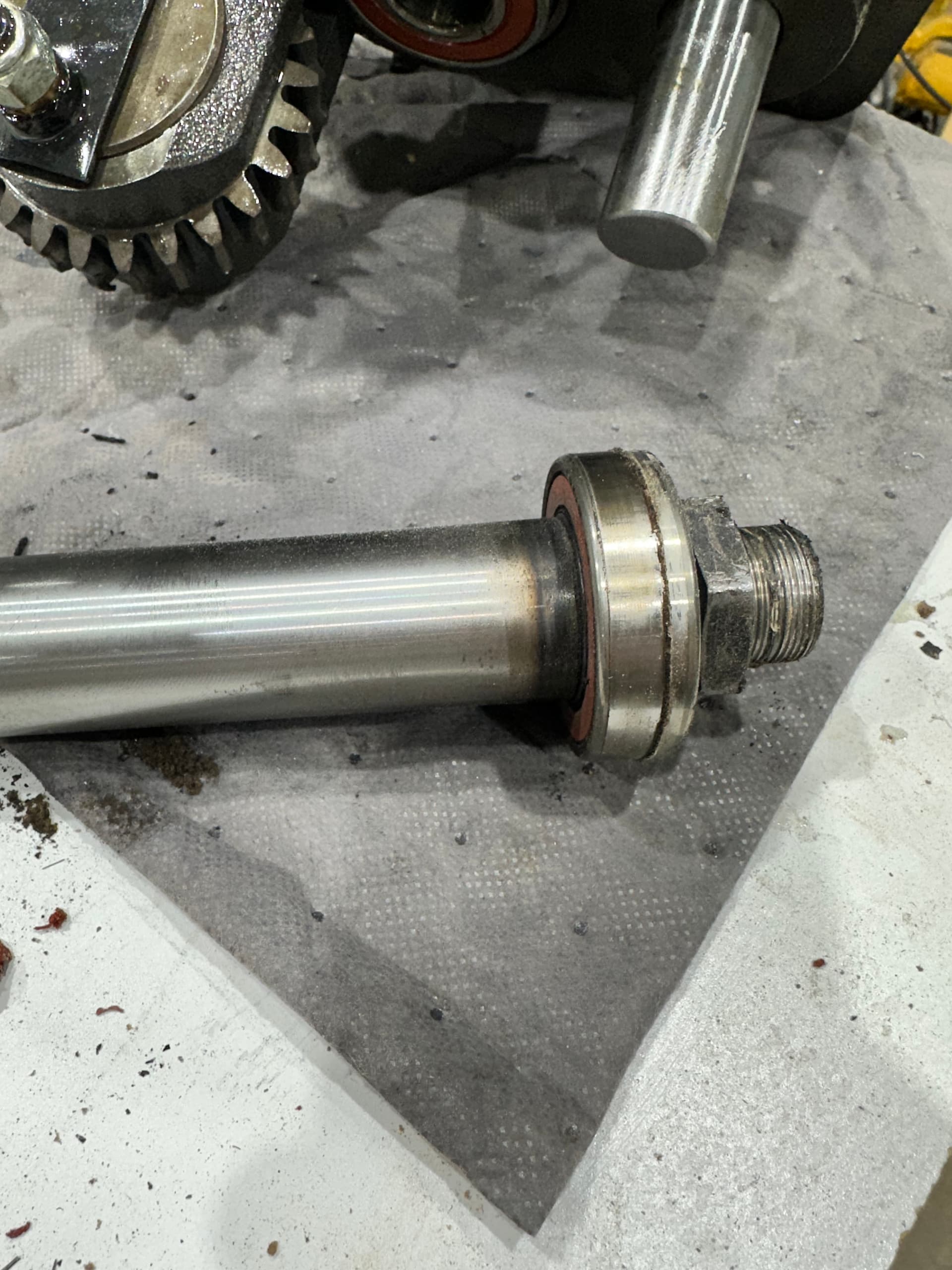

Diagnosis confirmed, it needs a bearing… but it did not ruin the shaft. You can see some discoloration which shows just how hot it was.
The suspected reason this occured was due to a missing dust cap which protects the bearing.
Thanks Jose! I did find some left hand threads in there!
