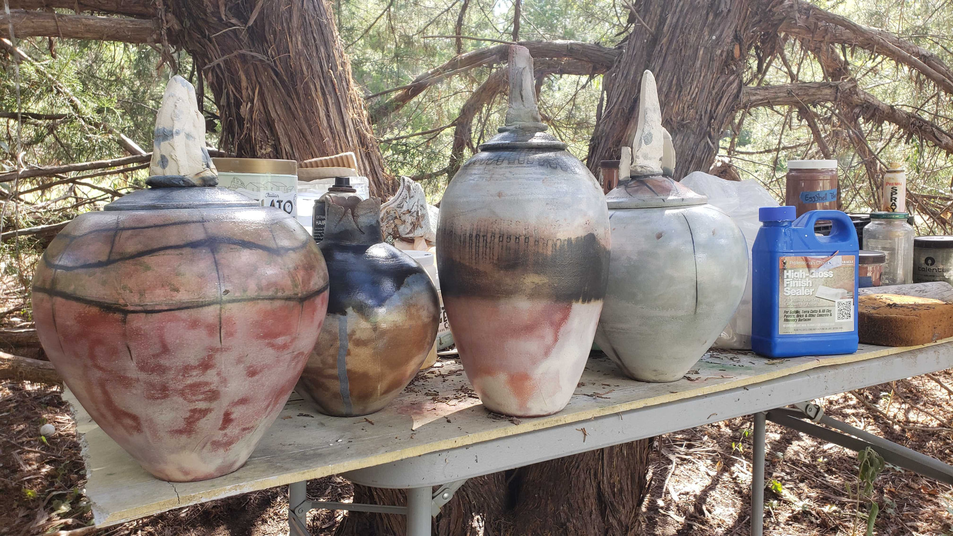

Firing Day! This is when the magic happens. All equipment necessary for safety and completion of the process will be provided. After a brief discussion regarding safety while working with extremely hot pots and the fumes inherent in the raku process, students will then glaze and fire their pots. A variety of glazes will be provided and examples of pieces finished using each of the glazes will be provided by the instructor. A handout will be given to each student giving the formula for each glaze used. If desired, students may purchase and bring their own glazes that are specifically formulated for raku. Glazes that do not conform to this guideline will not be permitted. The instructor will first fire a round of pots he made to demonstrate the firing and post firing techniques that will be employed by each student to ensure they have a complete understanding of the process they are about to employ. Following the instructor’s demonstration each student will fire their pieces made during the class. Students will handle their own pots from start to finish of the firing process. They will load their pots into the hot kiln. They will be responsible for deciding when the pots are ready to be pulled from the kiln. Following removal from the kiln, they will handle the post firing reduction when appropriate. After the firing of their pots, students will be shown how to and will clean any pots requiring cleaning.
At the end of firing, when all pots are done, there will be a class discussion and answer period where successes, problems, and new ideas for the next firing will be discussed. Please note that this class will be held outside in the parking lot and will begin at 9:00 and continue until all pieces are fired. It is anticipated that this will be a 4-6 hour day depending on the number of pots to be fired. Long pants, long sleeve shirts, and a hat or bandana are strongly advised to protect yourself from the high temperatures used during firing. You will also want to bring plenty of fluids to stay hydrated throughout the day.
