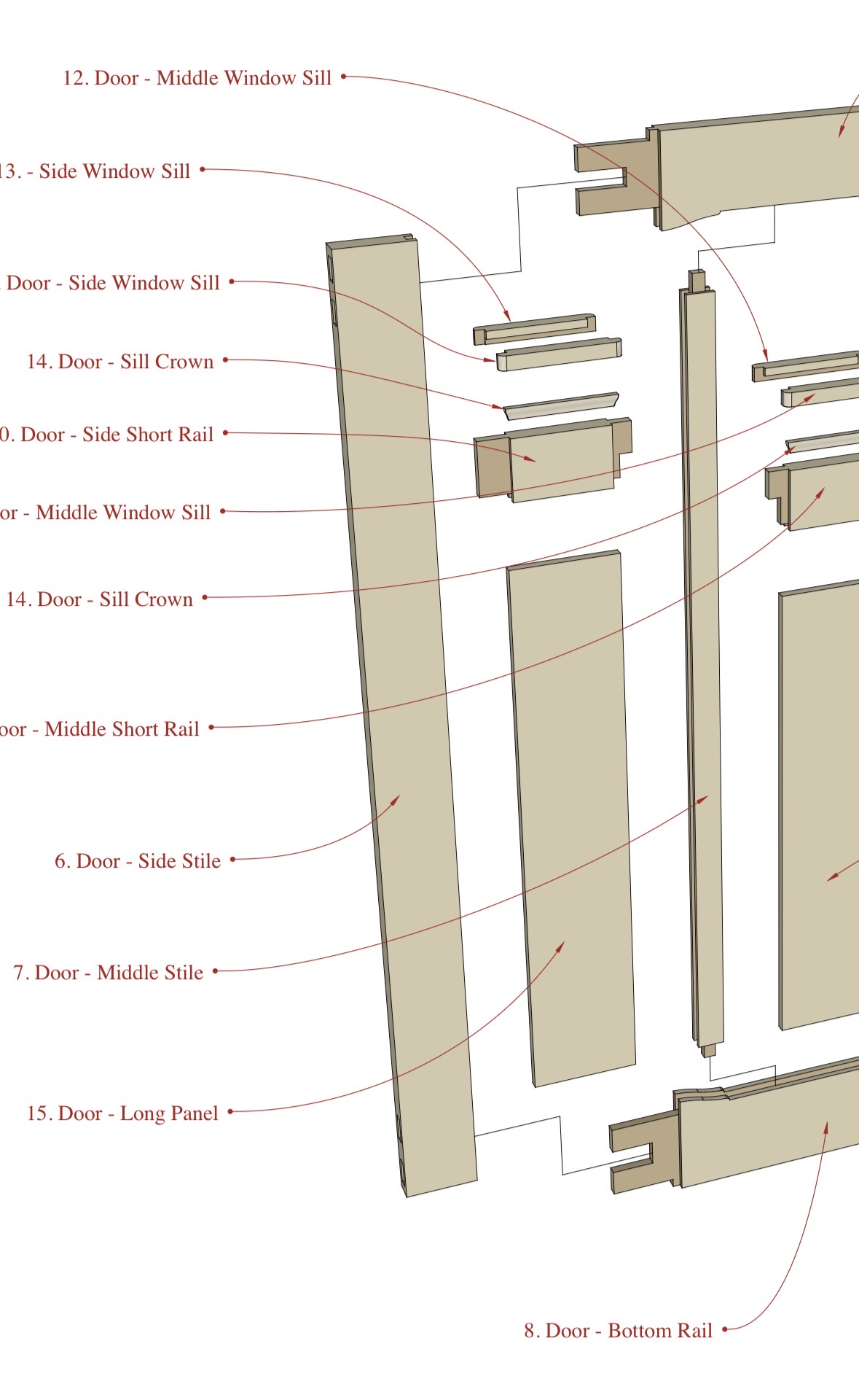

I’m making some mortises that are 5.25” deep, so I’m looking for a straight cut router bit (1/2” or 3/4”) that is about 6” long. Does anyone have one that I could borrow? Do they even make such a thing? I’d rather not go the drill and chisel route.
For regular straight plunge router bits you’ll be lucky to find a 3.” probably Ebay may be a better choice. 2 1/2” you may find it locally at woodcraft or rockler. Counting you can find one Whatever you do please don’t try to cut it in one pass. I don’t think the router can handle it and the dust collector will not be able to evac the chips. Have you considered using 1” rods or an 1.5” closet hanger rod? You can use an auger bit or a forstner bit with an extension shaft to cut the holes. Otherwise. Use forstner bit to cut as much material then clean it up with a chisel. Using a big 1 1/2 chisel is not hard to do, is easier than you think, and it is done rather quick. I just dont get why such a deep mortise. Normally is not more than half the thickness of the board but usually a third is strong enough. Good luck.
Thanks for the response @JOSEGAYTAN. I hadn’t thought of using a mortising bit versus a regular drill bit. A 3” router bit would work if I was doing a through tenon, but I don’t trust myself to make that look nice. I’ve routed out the first 1.5” of the mortises, with 1/4” deep passes .
These big mortises/tenons are for the top/bottom and side rails for a door I’m building.
