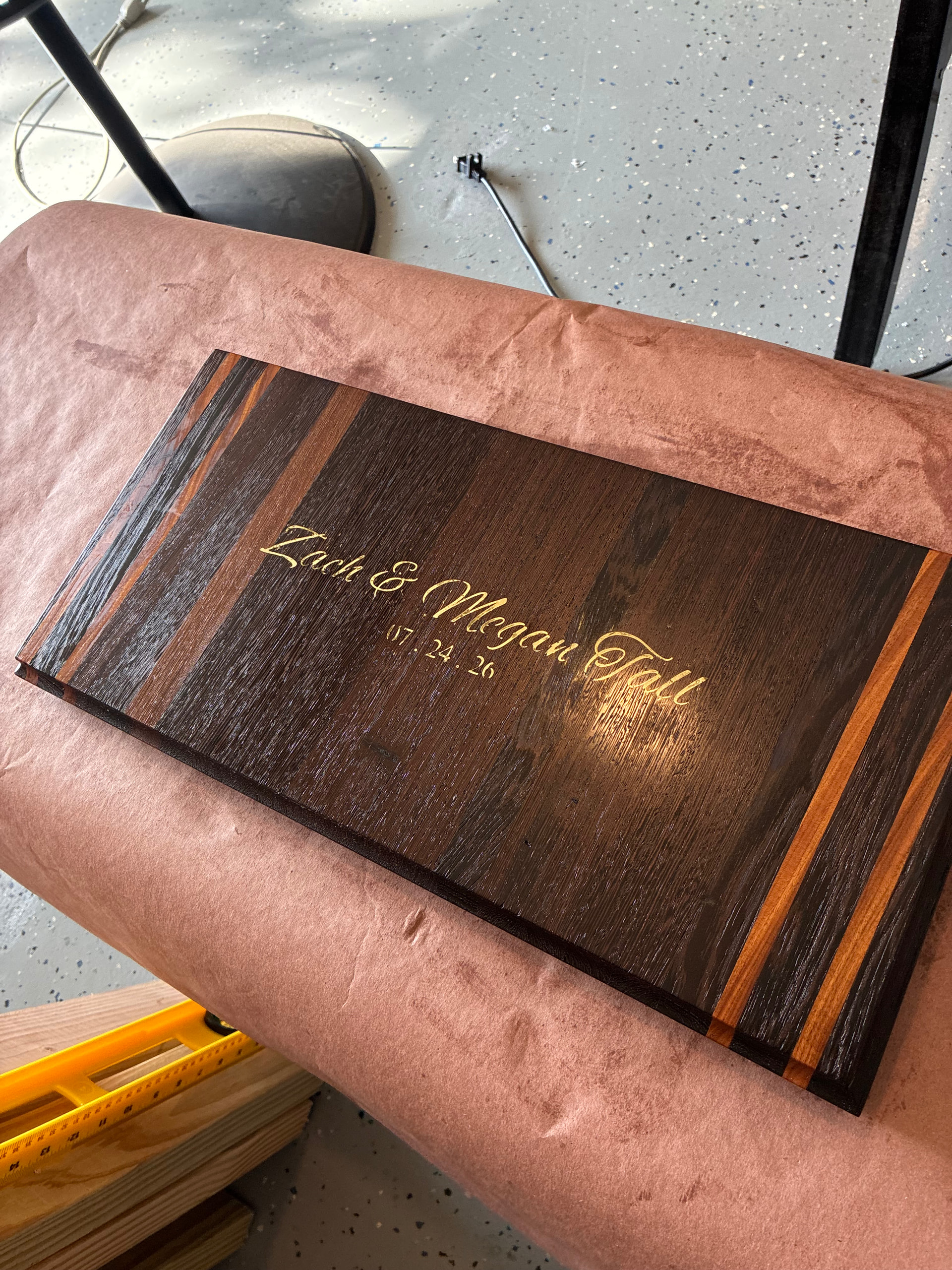

Hi all, I have a cutting board I’m making for a friend’s wedding, I’d like to engrave it and then I’ll do the brass powder/thin CA glue trick for inlay. No clue how to use a laser or CNC, I’m leaving for the wedding at 4am Thursday, if anyone is free sometime tomorrow (Tuesday) for an assist. Happy to compensate you for your time, I can provide the inital text file. I’m free anytime after 3:30pm to work on the project if anyone is available. (Also I know this is last minute so if no one is available I completely understand)

I can help you with the small CNC if you’re free at 6 pm tomorrow.
Thank you Martin and Michael - agreed, the plan was to put the inlay on the bottom, but using the feet to make sure they don’t mix up the sides is a great idea, thanks!
@Iammikecohen that would be incredibly appreciated, I will be there at 6! Do I need to reserve time in the woodshop? (not certified on CNC but I didn’t know if I also needed a reserved slot somewhere in the shop at the same time)
Is there anything I can do ahead of time to help make tomorrow go as smooth as possible? As a new user I can’t attach the PDF I made for a template but I do have one which is dimensioned accurately to the cutting board
@Iammikecohen thank you again for the help! Here’s a pic of the finished product!
