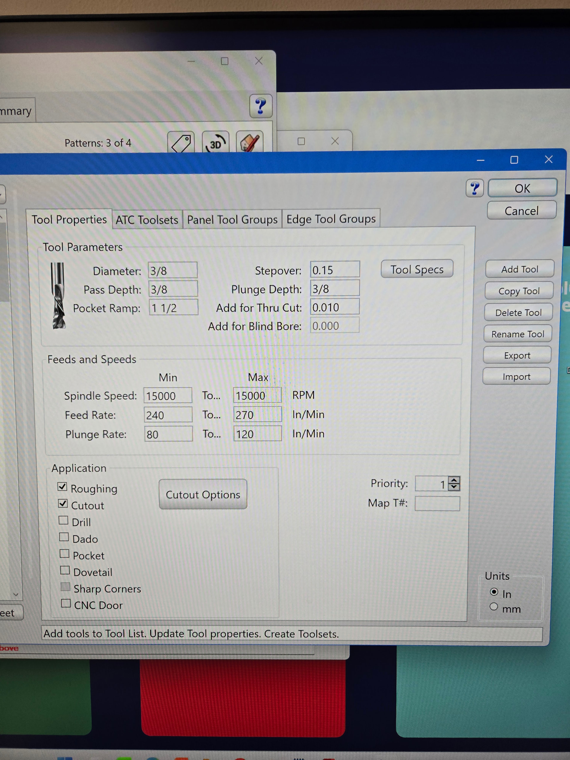

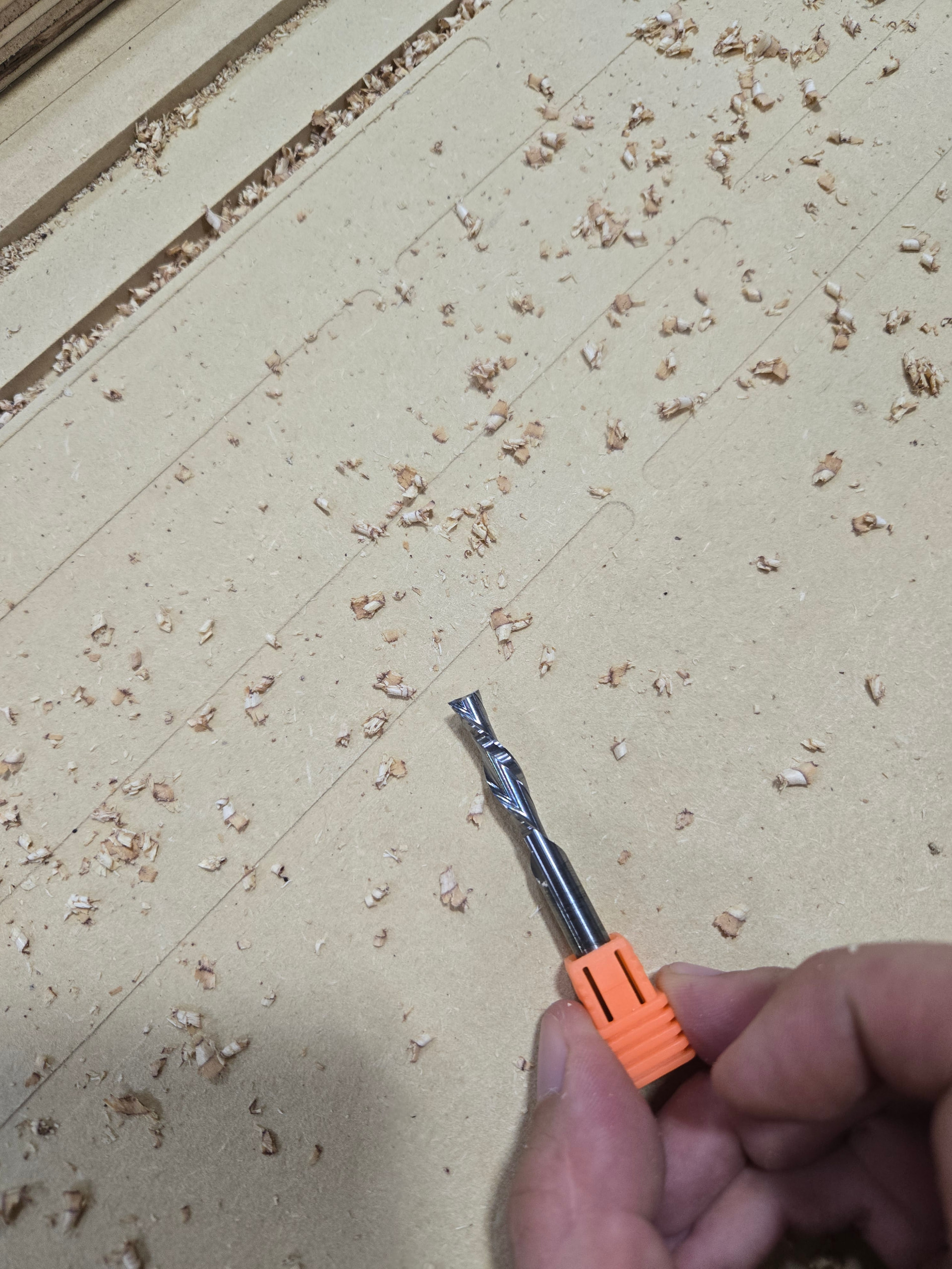

I recently bought a 3/8 two flute compression bit from Spetool that I’m using to cut birch plywood. I started with the 15,000 RPM and 270 in/min feed rate as recommended in the Spetool charts. I experienced terrible screaming in the bit on corners and a couple cross cuts and it dislodged my sheet of ply even with it both brad nailed and vacuumed. So I’m clearly doing something wrong.
Any of y’all using a 3/8in bit? What are you running it at? Ive attached a photo of my settings in Mozaik and the chips with a 1/4in bit for scale in case that helps

If it’s a two flute 3/8 end mill, that chip load is a little on the high side. I target 0.06” which would be 180 in/min at 15000 rpm.

Do you know where on the mill the spiral switch happens? It’s often at a distance from the end equal to the diameter. If so, then it looks like your initial cut depth puts that transition point right at the top surface. Odd things can sometimes happen in that case. And you aren’t benefiting from the compression bit unless the depth of your first cut is greater than the length of the inverted section. I think you would also want to avoid ramping, since that delays reaching the proper cutting depth.

I find that Spetool exaggerates the feed rate. I would half the speed as a test

I have used a 3/8” Amana Compression successfully at Feed 200 IPM, Plunge 100 IPM @ 18,000 RPM. It did feel a bit agressive, but cut well. I had a sudden bit slip, so definitely tighten up that collet and check between runs. My 3/8” Amana bit has a crazy 0.5” upcut section making it too deep a first pass for me to benefit from the compression bit, IMO. I will run a smaller downcut first to prevent breakout on the riftsawn oak ply.
