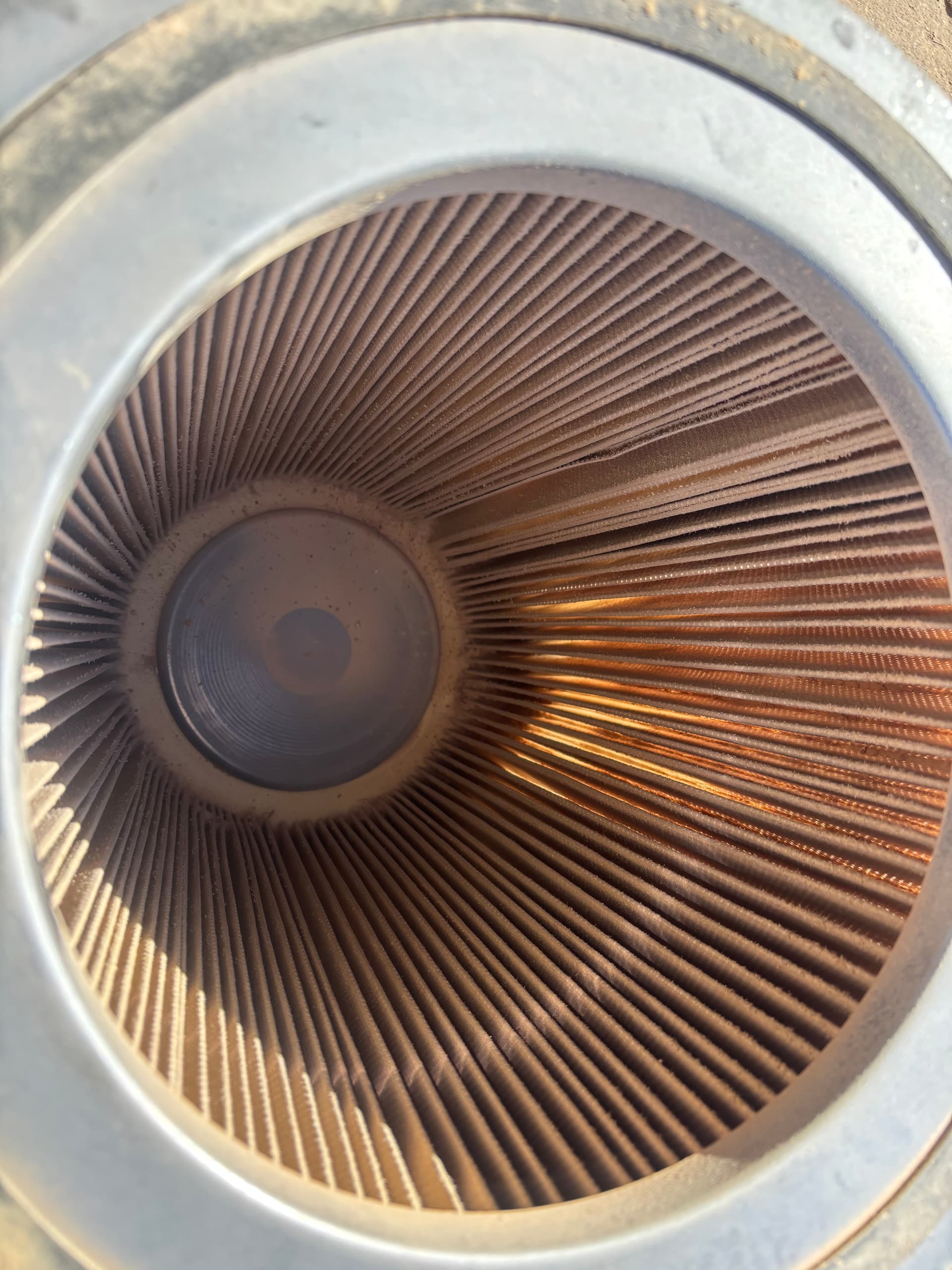

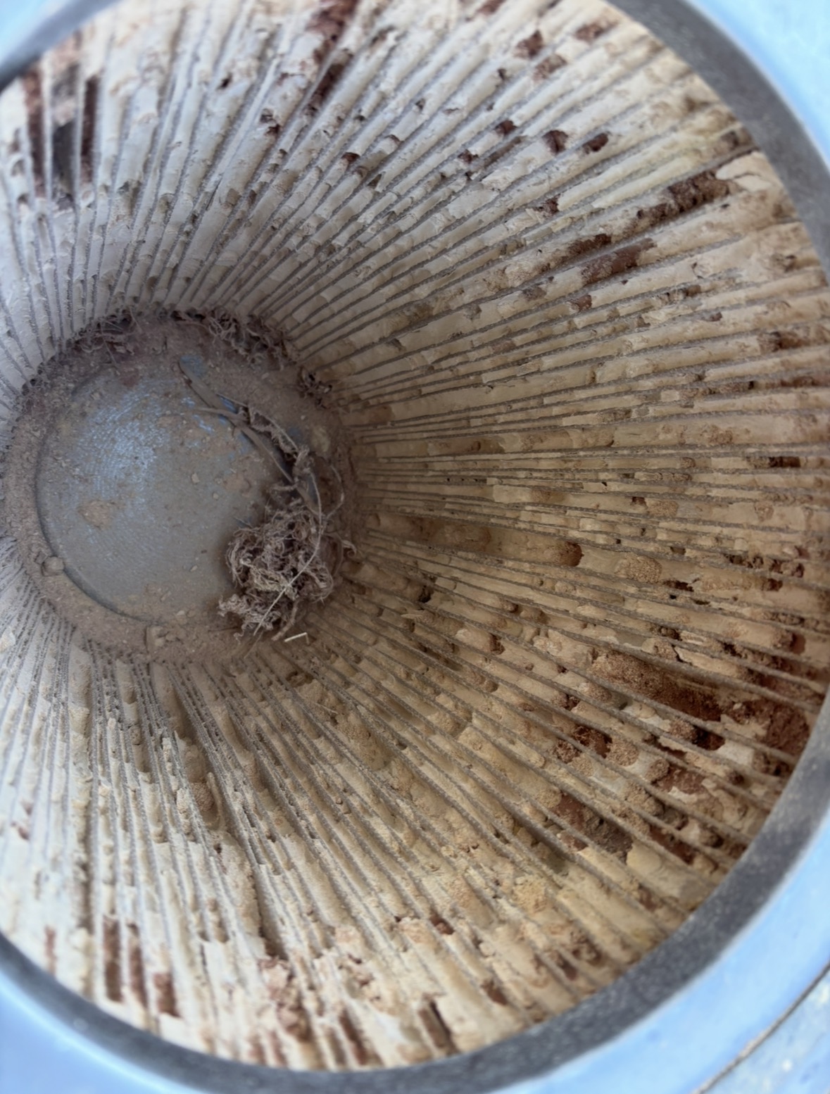

I started working on it, today, but someone(*) came in to use the CNC, so I only got about 1/3 of it done.
I have a “before” picture, but I can’t seem to add it, here.
(*) He had signed up for it, but was late, so I was hoping that he wouldn’t come in and I’d have more time.
Before:
After:
