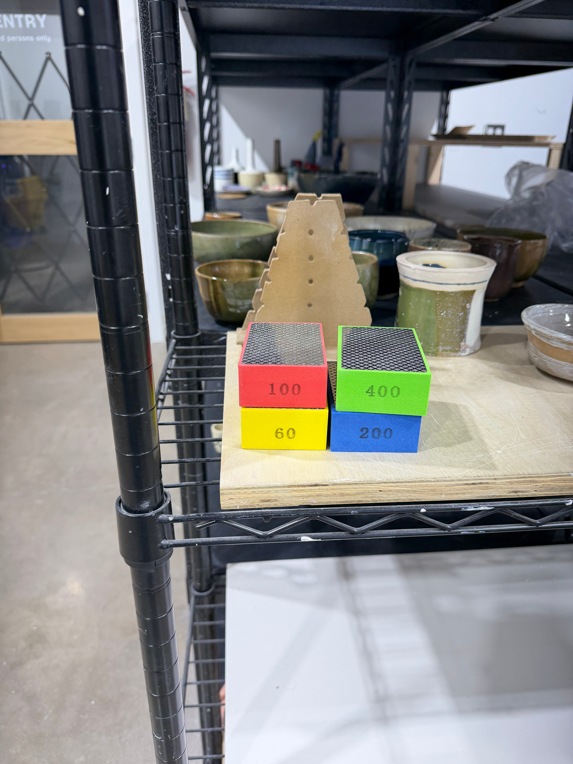

Kiln Wash on Pot Bottoms
We’ve noticed kiln wash sticking to the bottoms of pots more frequently lately, likely due to our firing temperature increasing from cone 5 to cone 6. The kiln team is working behind the scenes to minimize this where possible.
In the meantime, I’ve purchased diamond sanding pads so members can clean up any kiln wash stuck to their pots (it comes off pretty easily). You’ll find them on the kiln rejection shelf across from the wheels.
A note on safe sanding: Always sand under running water, or submerge your piece in a throwing bowl filled with water. Clay contains silica, which is harmful when inhaled — never sand dry clay or bisqueware inside the studio.
These pads can also be used to clean up small glaze runs.

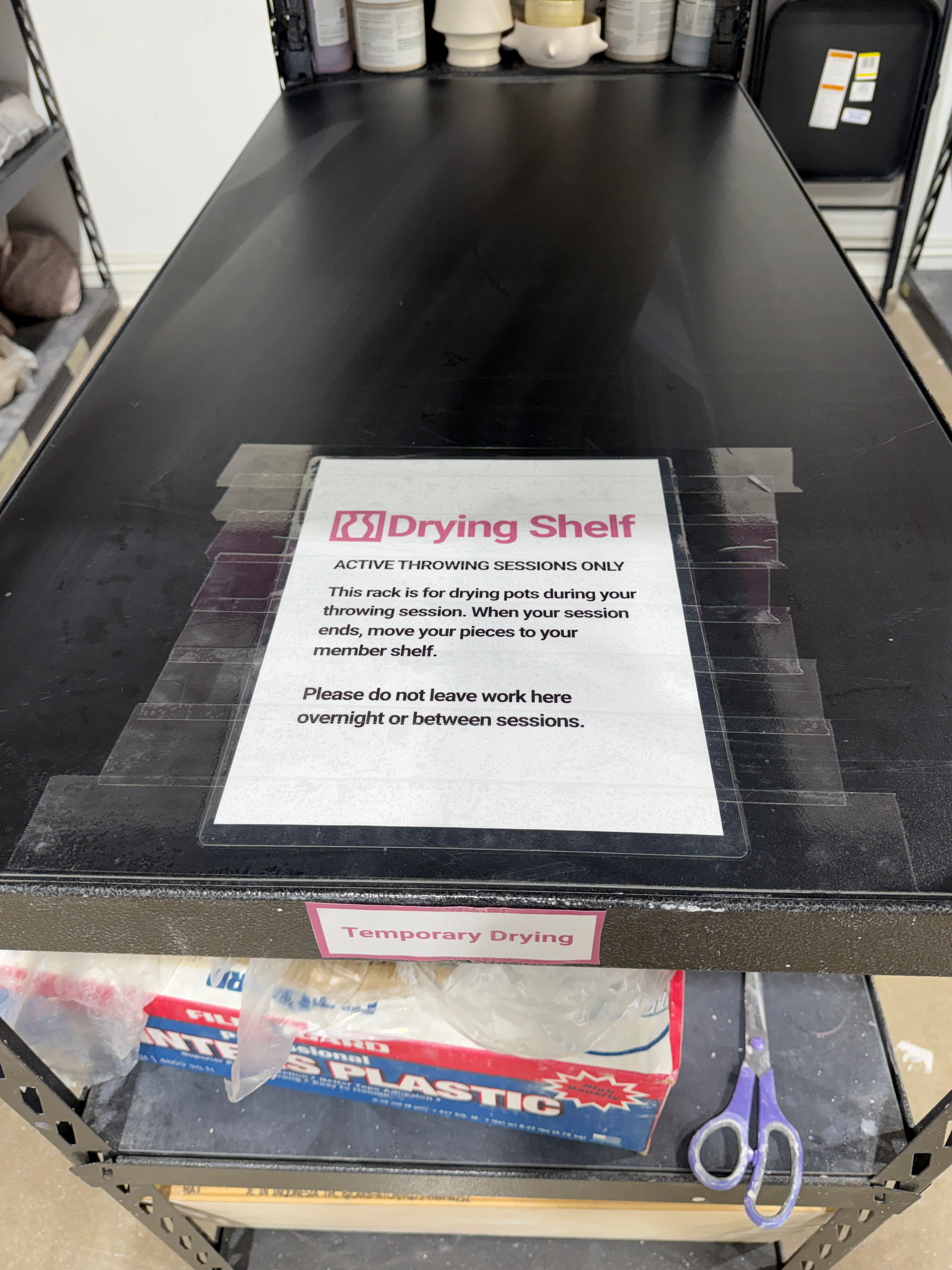

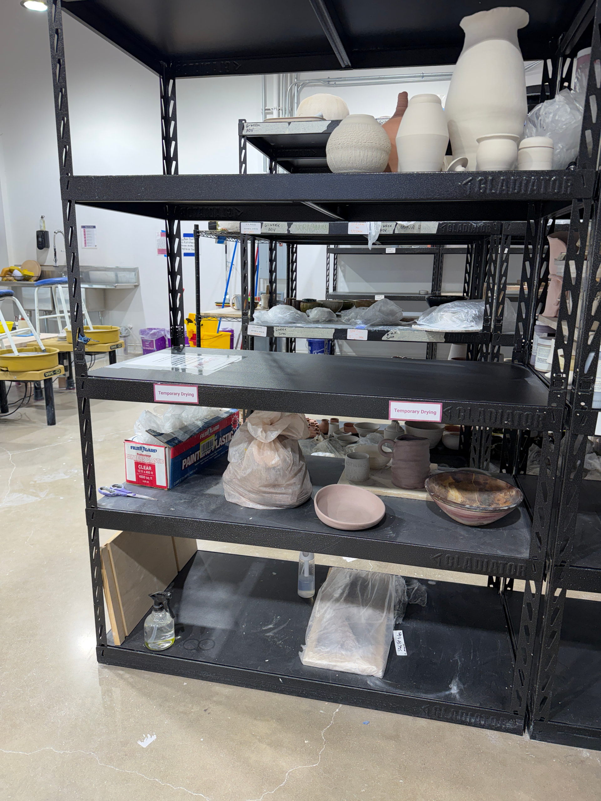

Temporary Drying Shelf
I’ve added a temporary drying shelf near the wheels to help reduce the need to book a table while you’re throwing. You’re welcome to store pieces thrown during your active booking on this shelf.
Important: All pieces must be moved to your personal member shelf before you leave. Any work left behind will be considered abandoned and discarded. As always, please be mindful of others’ work and be kind and respectful when sharing the space.
