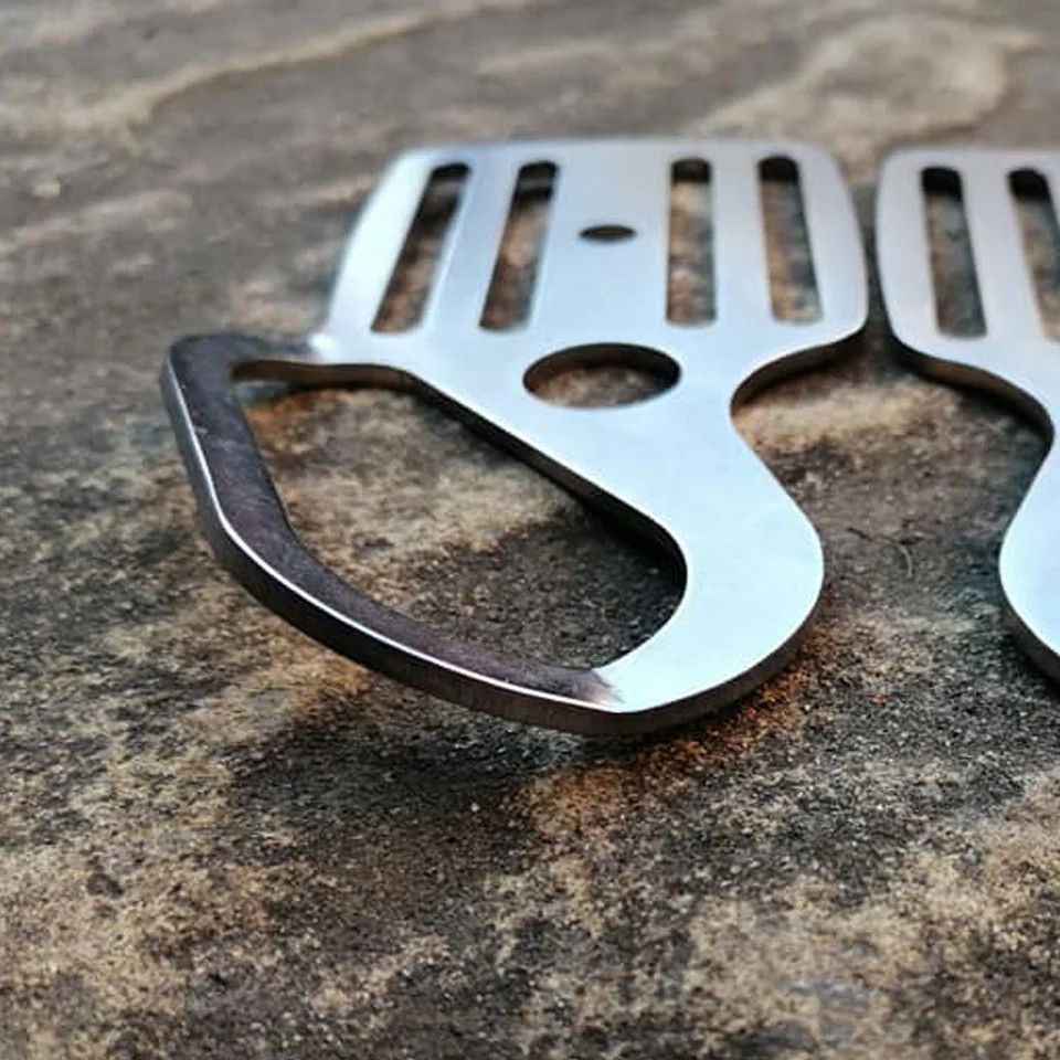

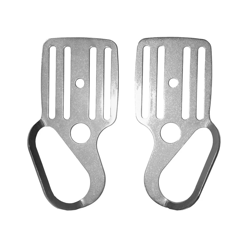

Is this what your talking about? Redesigning this part to move the D ring closer to the harness.
If so, This seems like a great option for the metal cutting fiber laser.
Hi! that’s similar to the pieces he makes but that’s not the piece I would need. I would need to design a different piece for my sliding D rings for the D ring to be closer to the belt buckle after you account for the length of the bolt snap. Maybe even something that would allow me to cross clip the sidemount tanks.His sliding D rings don’t slide back against the force of the aluminum tank pulling upwards and he did some clever engineering for that. All other sliding D rings slide backwards when pushed to the front of the belt buckle. It’s a common problem I’ve heard thinner petite women divers have encountered.
I also need to make some square D rings that are lower than the wing in the back because my waist band is higher than taller people, the waist band and drop D rings and under the wing and hard to clip stages to. I’ve tried all the premade longer drop d rings and they aren’t quite what I need.
I’m not sure what machinery he uses to make those but I would need something similar for pieces fit for me and other shorter petite divers :hugs: I will keep an eye out for the fiber cutting class.
There are some pieces I need to weld so I’m signed up for a welding class though seems like I need the TIG one.
The metal cutting fiber laser could cut it. The vertical mill and Tormach could make this part. The vertical is mill is great for prototyping and Tormach is great for repeatability. I’m also unsure of that exact part that you are speaking of because I’m ignorant about dive gear.
I have a fiber laser that can cut it.
Awesome! Ok, so it sounds like I need to take the vertical mill class to make prototypes. I guess if other petite divers want similar gear I could take the Tormach class. Thank you for the advice!! I didn’t know where to start. This has been very helpful!!
