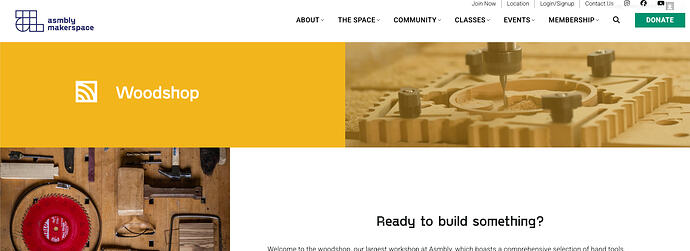

    • I was hoping the files for the custom clamps might be in this SHARED — Projects folder, but I don’t see it in there. Maybe someone else knows where they are and can share. You can see a glimpse of some of them on the Woodshop page on the website in the header video.
