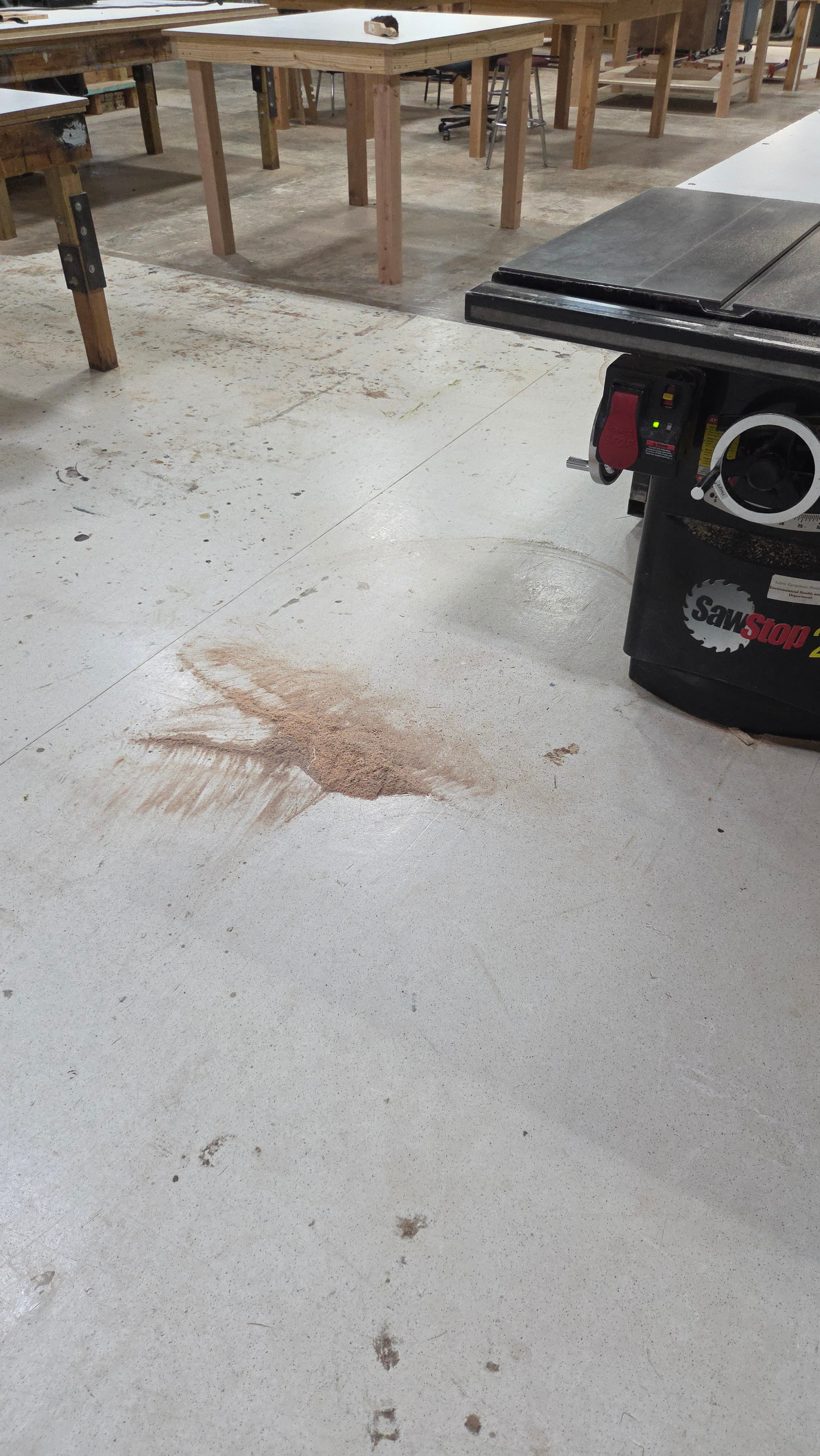

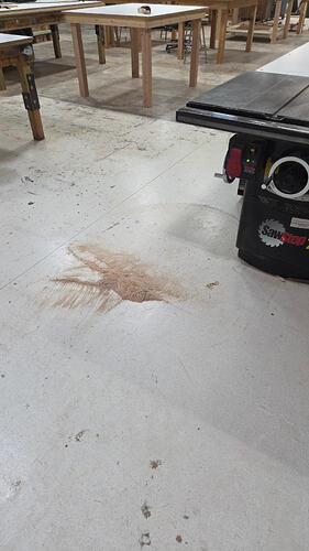

Problem Type: Cleaning
Workspace: Woodshop
Asset: Other
Summary: The woodshop is a mess
Additional Info: Someone isn’t cleaning up after themselves or did a lot of cutting without the dust collector or the dust collector is busted. There’s a coating of dust on everything, the floor is slippery in most places because of the dust. Some pulled the bin from the DC but didn’t empty it. I canceled my woodshop booking because I didn’t come in to clean up after everyone else.
Apologies if my tone is too harsh; it’s demoralizing to see the space in bad condition.
There was a problem report about the CNC dust collector being over-filled. I wonder if that’s what spread dust everywhere. I haven’t seen that issue in quite a while.

If anyone has any photos please post.
It is unacceptable to leave the space in a dirty state. If its a tooling issue, whoever came across it should have cleaned the mess and reported this. It should never be left to someone else to discover.
Many members reading this do this regularly, some members do not. We will review camera footage for who contributed and reach out accordingly.

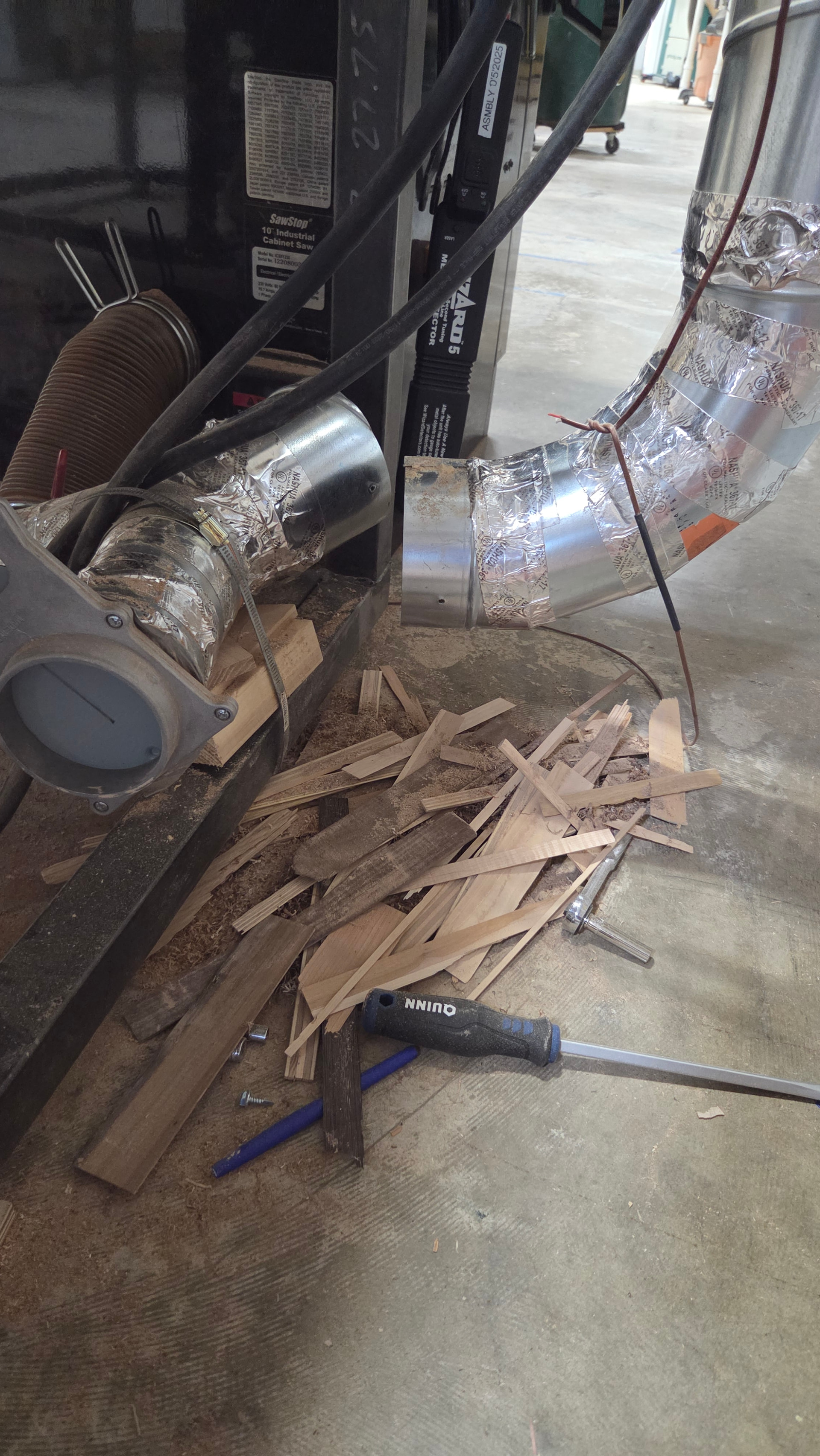

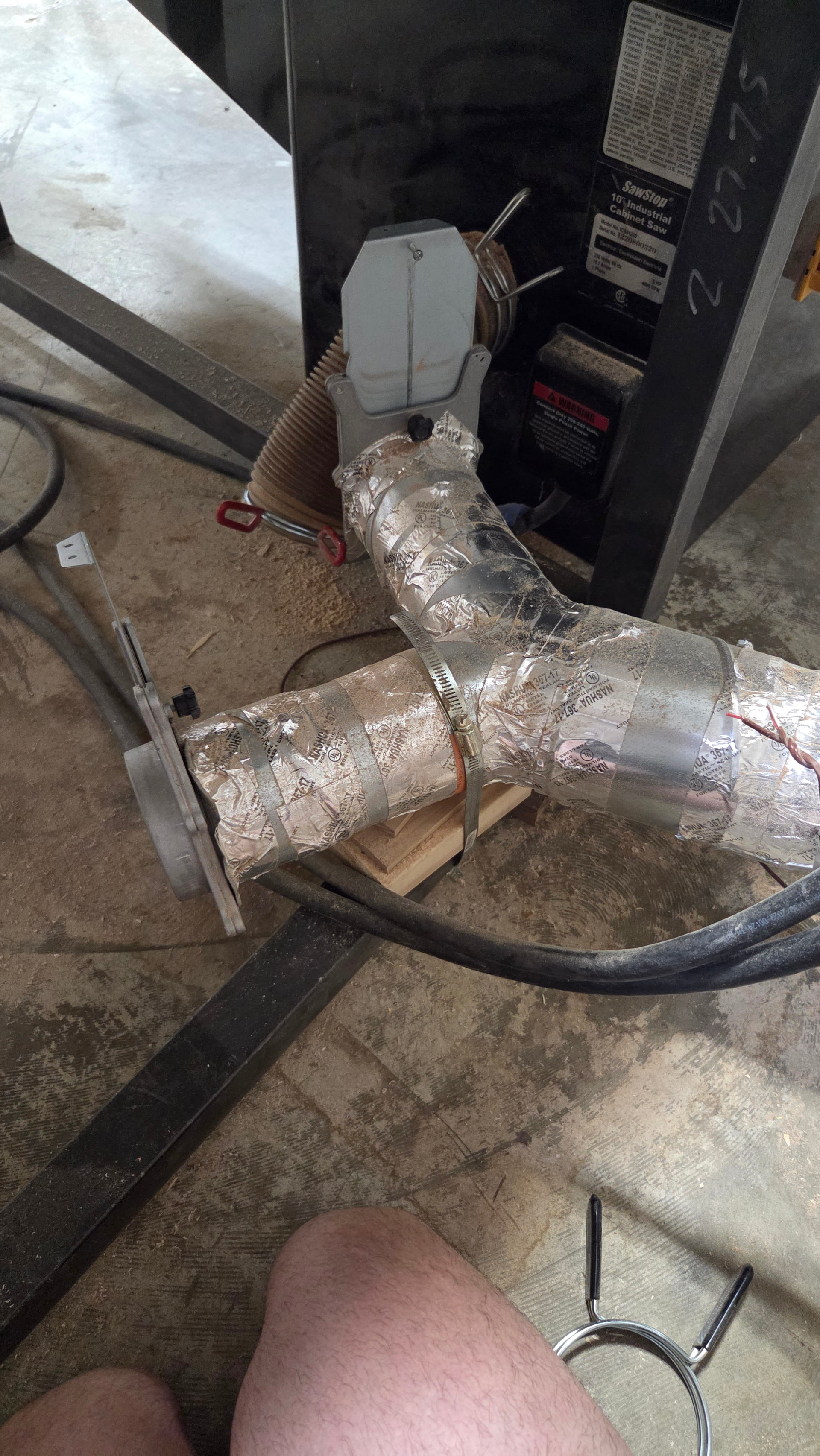

I have a field report from work on the table saws this morning.
The saws had basically 0 suction during morning classes. (Sorry wss and box class) The pile of dust we accumulated was impressive.

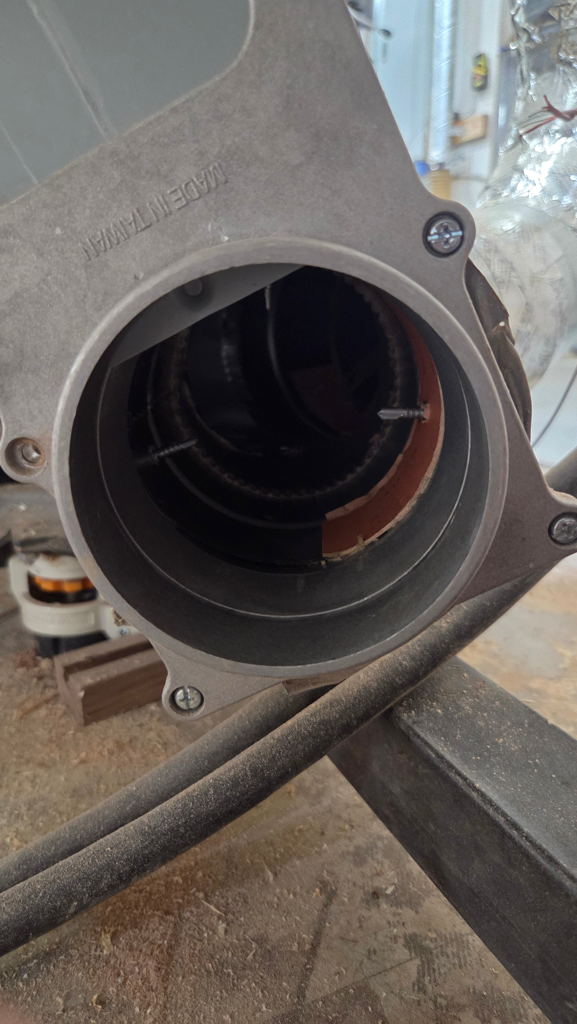

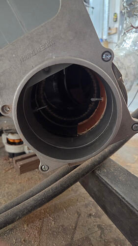

I disassembled the elbow and Y to find a large number of offcuts jammed in the elbow. Pictured below.
Al an I discussed the position of the 3DP grate system. My thought is that the grate should mount directly on the Y fitting, so the resulting clog is contained in the flex hose where it’s easy to clean out. Feedback?
Julie also stopped by to brainstorm ways to make the elbow easier to clean. It’s likely to always have some amount of clogging. She recommended covering the screws with caps (3DP or equivalent) so everything is a little less stabby. I agree that some caps would be a nice quality of life upgrade.
The table saws are a lot better now. But I agree with gem that the overall system seems down on power.
