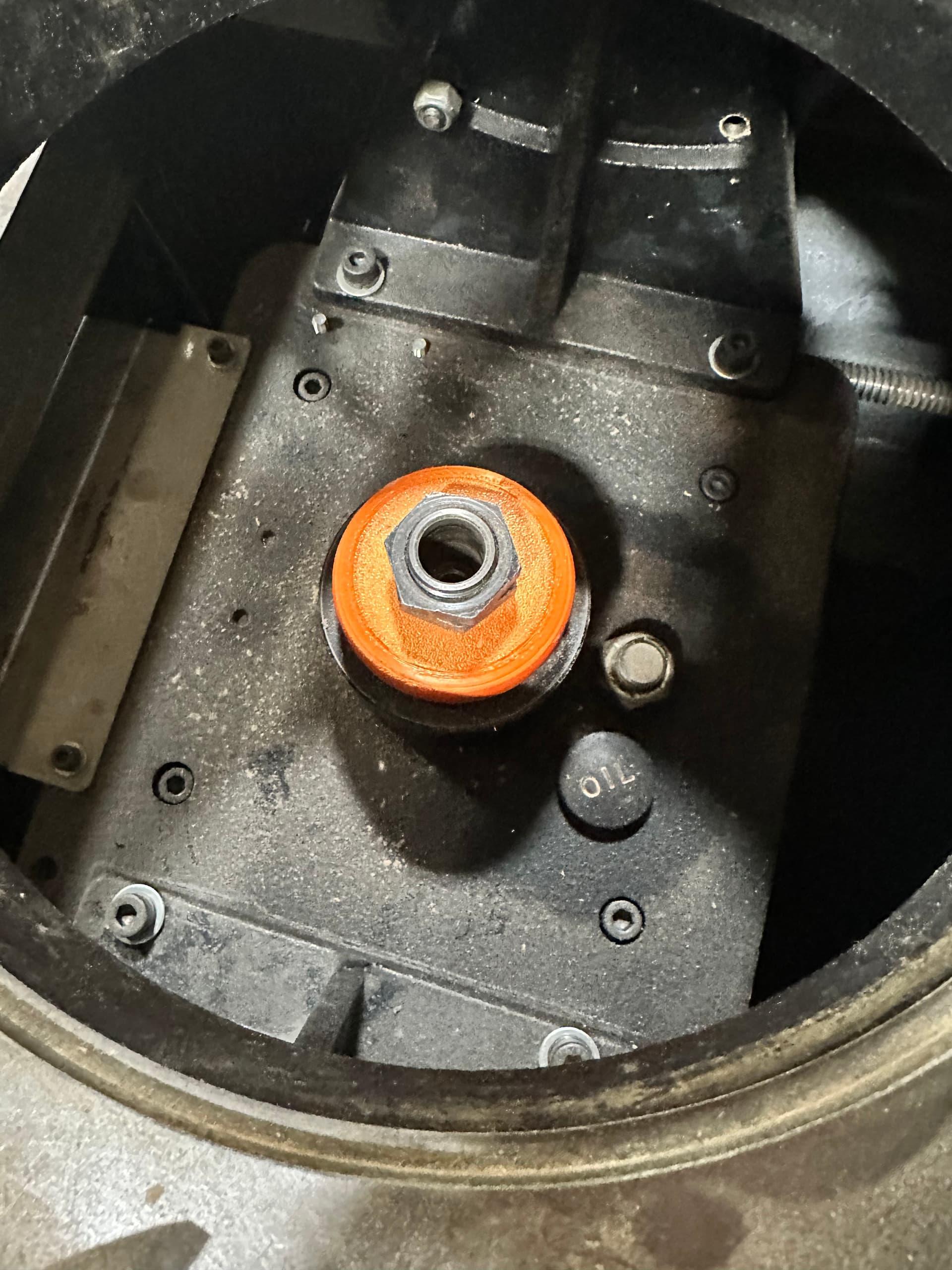

I have 3d printed a temporary part, and the spindle sander is now good to go.
If you don’t see this (currently orange) cover present, please submit a problem report and red tag the machine. This is a cover which protects the bearing from fine dust. It may be another color in the future once we receive the factory replacement part. This cover was missing, which I believe lead to the bearing failure, which caused the fire due the heat and sparks in combination with the fine dust.
