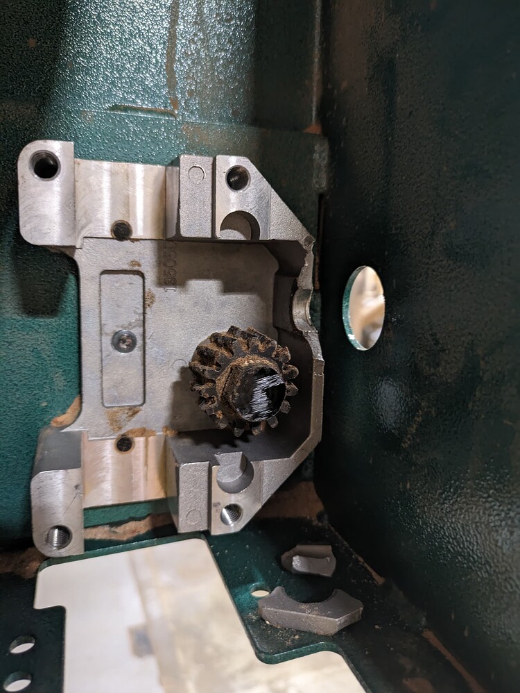

Summary: Blade guard
Additional Info: Blade guard is stuck and can not raise
Is this the same issue as last summer ? Worm gear forced and broken ?
I can’t speak to what happened last year, but I can confirm that the cast aluminum guide bracket is broken (pictured in your photo).
The worm screw also seems to be bent.
JD got the parts numbers for me and I put the order in. Unfortunately the guide bracket is on back order.
