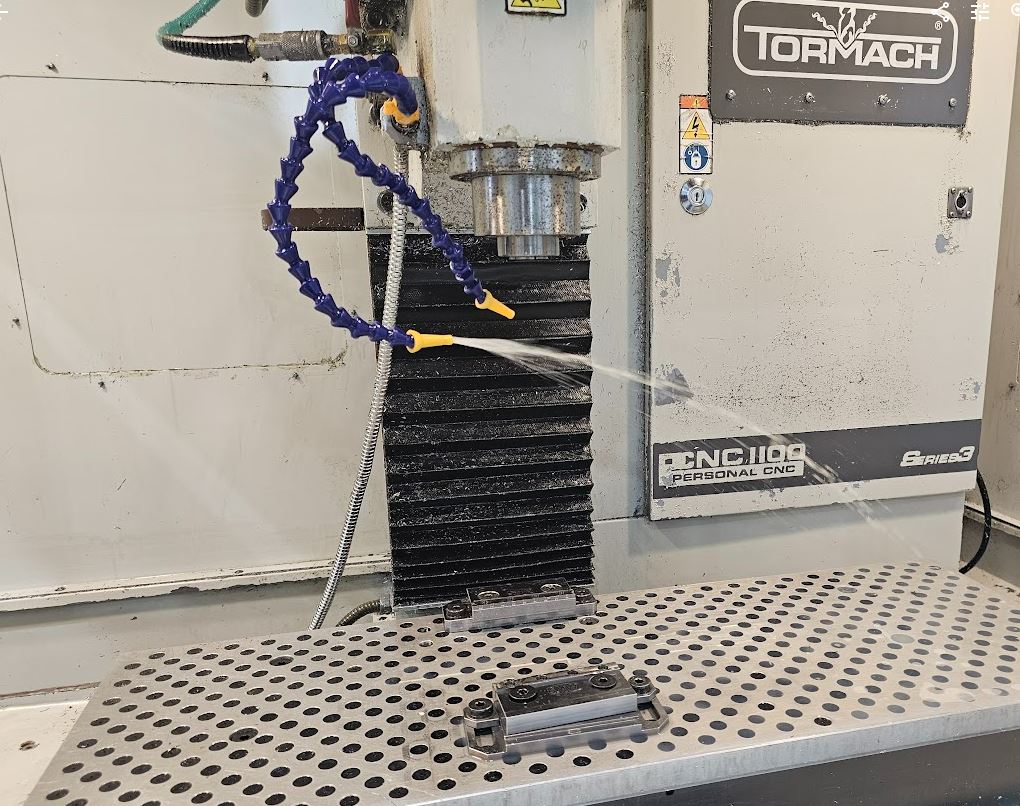

Summary: Flood coolant doesn’t work.
Additional Info: When I press coolant button, i hear electric motor noise. no flow from nozzle. i added approx 3 gal coolant and some of it spilled from the tank. (I mopped up the spill) Still no flow from nozzle.
Just in case, check the cutoff valve at the base of the coolant nozzle/hose, it may have been toggled fully off during the move.
I will check the orange valve next time I’m at the space. There was a trickle of coolant coming from the nozzle when I initially pressed the button, which petered out while I added coolant. Estimate 100 mL over 2 minutes. My impression was that it was moving the fluid that was already in the line.
Thankfully it just seemed to be the valve, had decent coolant flow for about a minute after opening it fully and testing.
